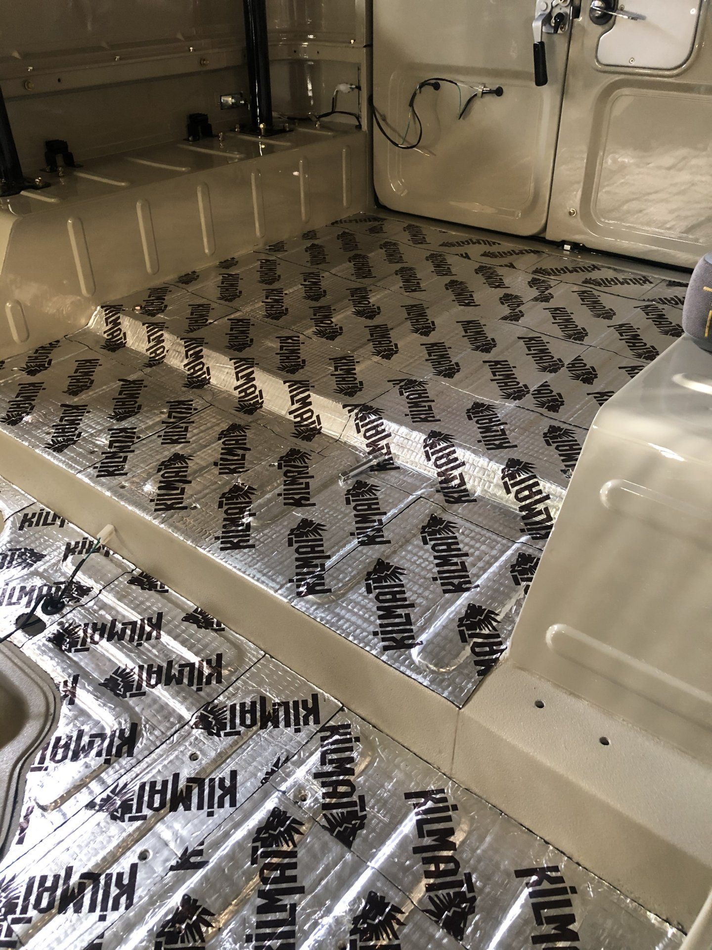

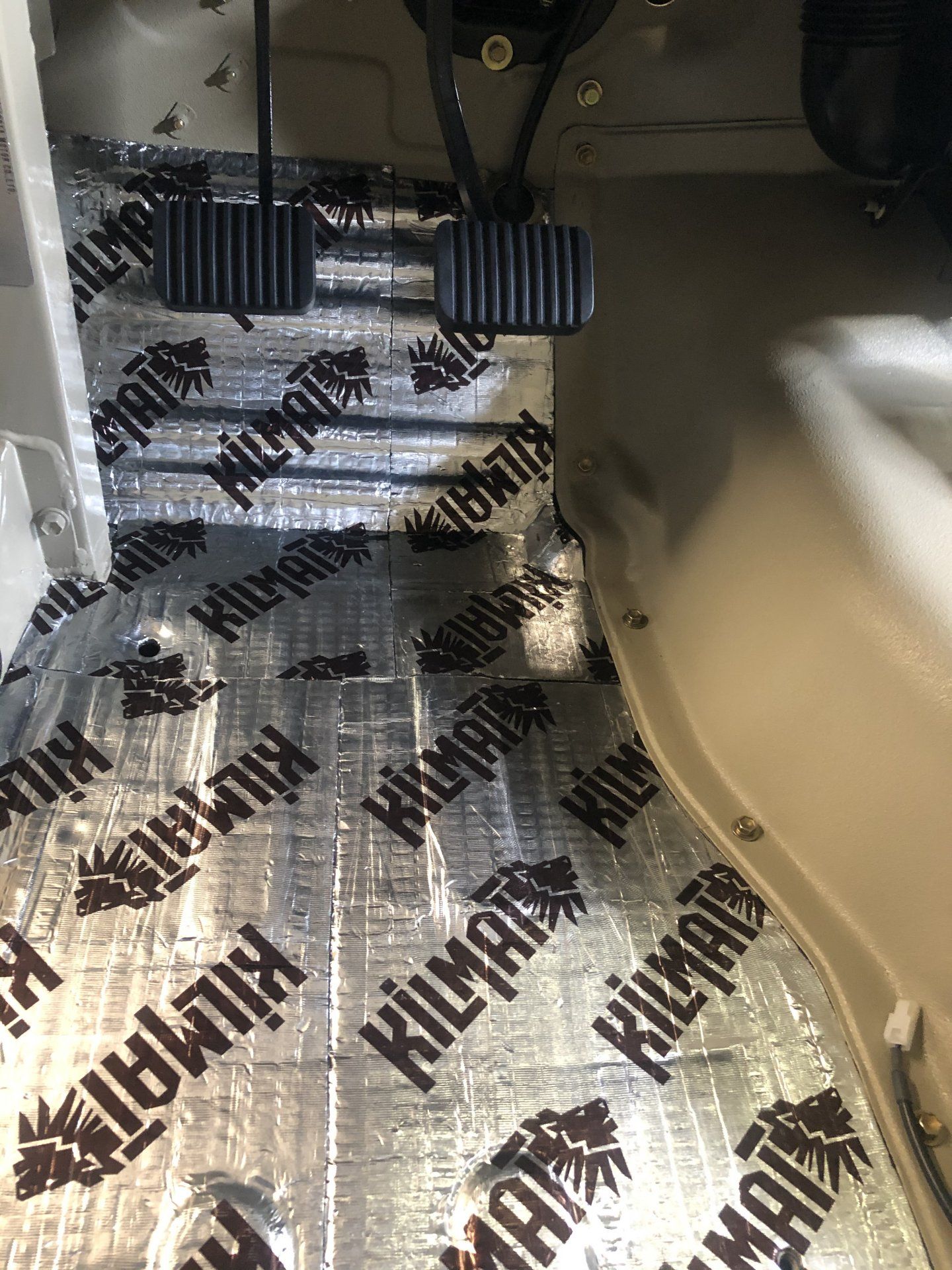

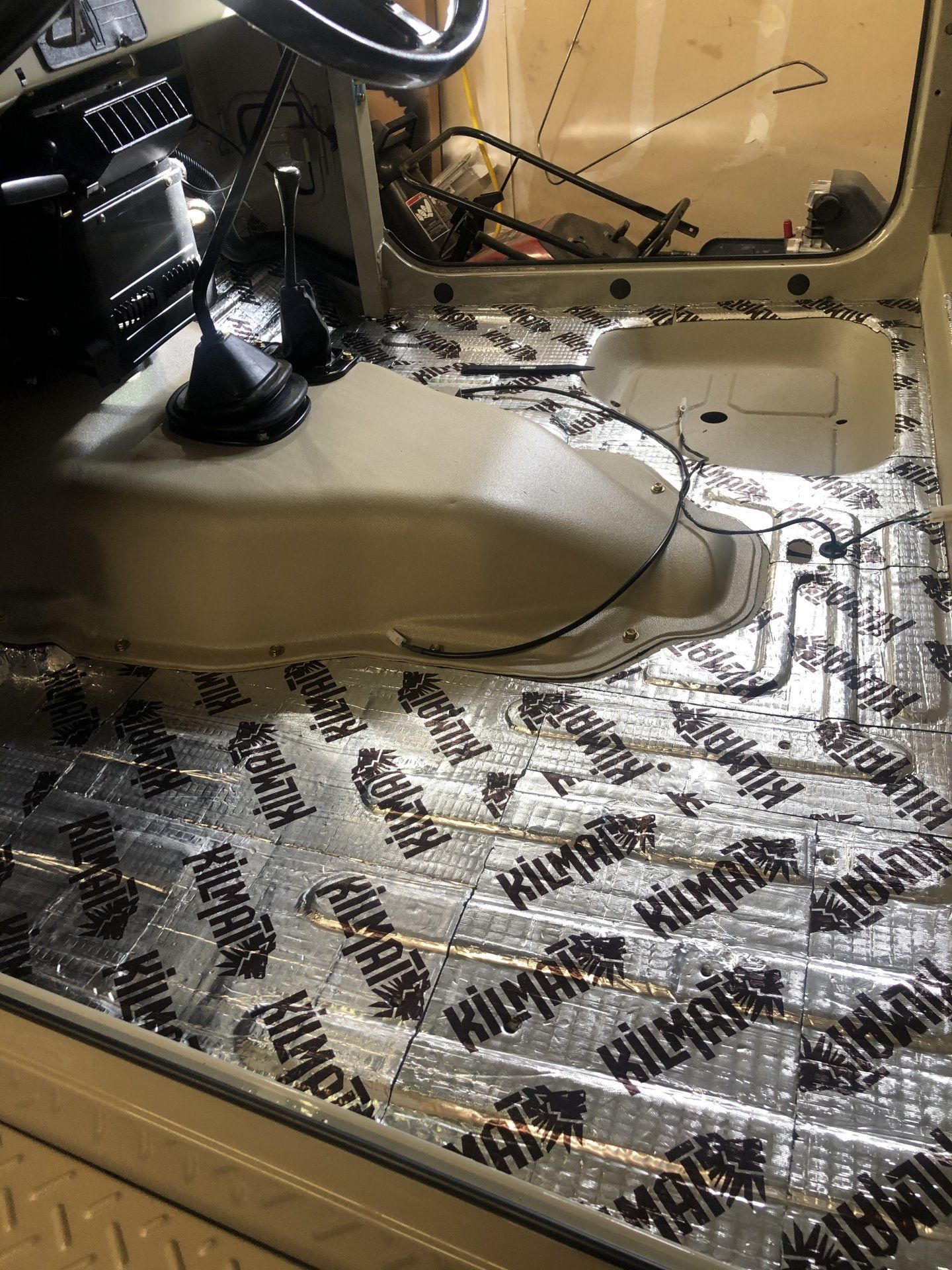

Not sure this helps since I’m still a month or 2 from firing her up but here is what I did. I had the floor and underside of the tub Raptor lined. Then I put down some Kilmat off Amazon. Did the whole floor, minus the hump cause I like the clean look, for like $60. I will add some Kilmat to the inside of the doors as well. Then I may add some Evercoat 117 off Amazon under driver and passenger floor and firewall. Then a CityRacer floor mat and rear bed mat. The Kilmat definitely took a lot of the hollow sound out of the floor. I also installed a headliner from cruiser corps. Who knows if this will be worth it but it was relatively cheap.
Not sure this helps since I’m still a month or 2 from firing her up but here is what I did. I had the floor and underside of the tub Raptor lined. Then I put down some Kilmat off Amazon. Did the whole floor, minus the hump cause I like the clean look, for like $60. I will add some Kilmat to the inside of the doors as well. Then I may add some Evercoat 117 off Amazon under driver and passenger floor and firewall. Then a CityRacer floor mat and rear bed mat. The Kilmat definitely took a lot of the hollow sound out of the floor. I also installed a headliner from cruiser corps. Who knows if this will be worth it but it was relatively cheap. View attachment 2532953
that looks really nice. I also chose to leave my tunnel on covered. Although I applied the sound deadening to the underside of the tunnel.
