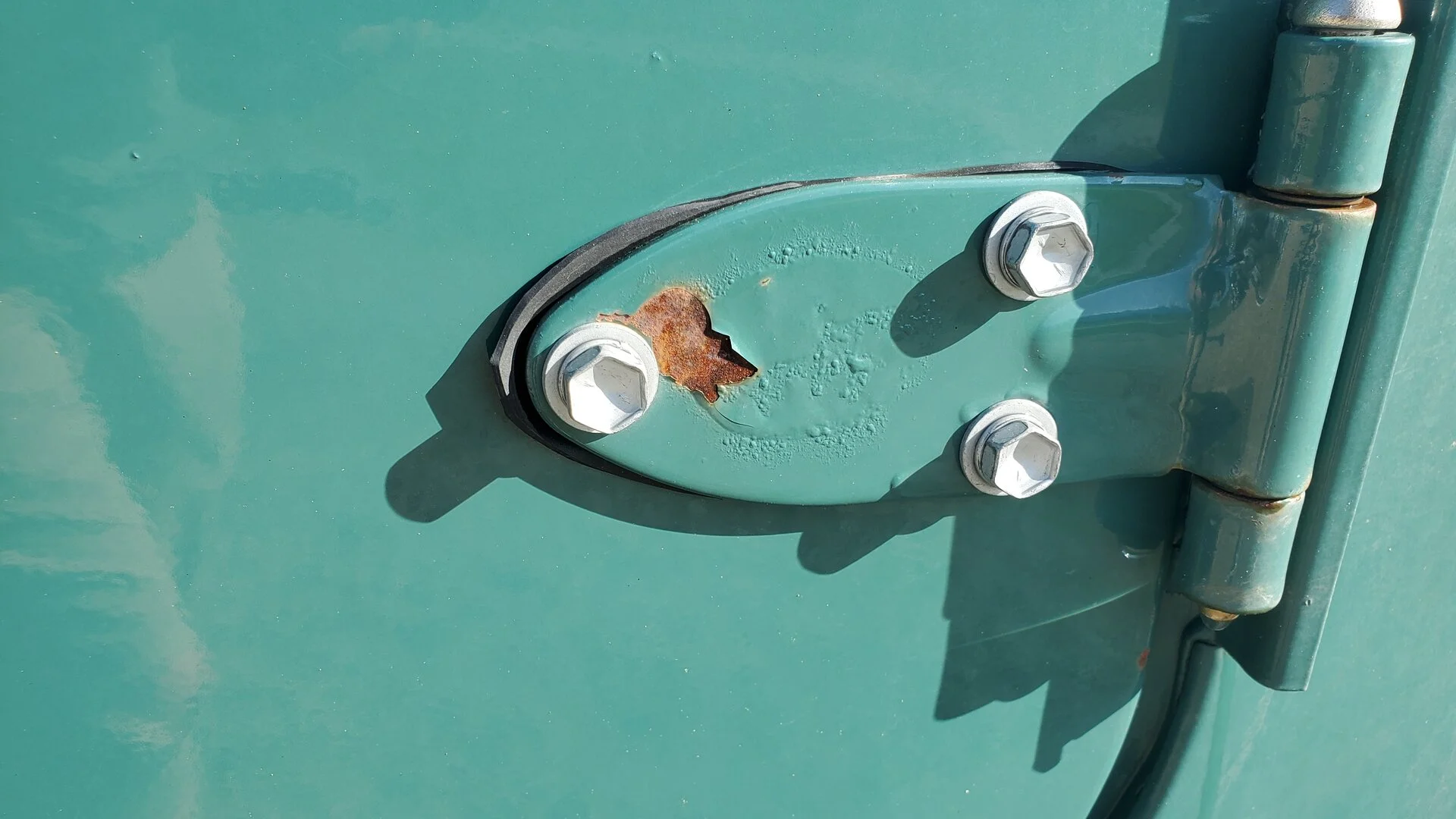

I did find a couple spots that had some bubbles under the paint, the one on the fender I hit hard with the pressure washer, the other one has been growing for a couple of years now.
Maybe I should hit them with some Fluid Film and keep going.

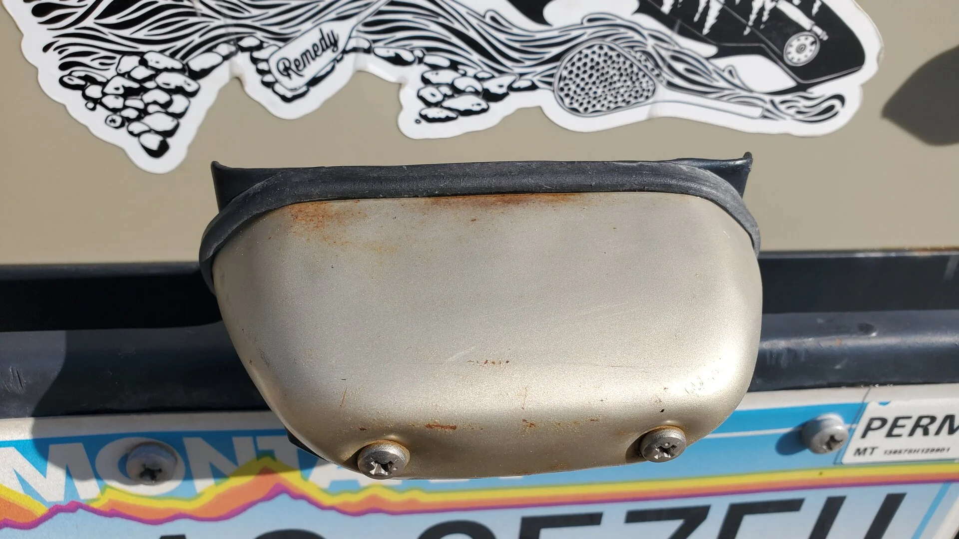

Then there is the OEM license plate light, I can't say I'm really impressed with the quality of the finish. It's another spot that's been slowly growing over the last few years.
I have the same color of rust! Maybe we eventually change the paint code to 203 on the VIN tag - Fe203 is the chemical formula for rust
my hood hinges are looking like your door hinges - I'm doing a rattle can resto on some of the hinges and smaller areas of rust - like under the dash pad... etc.
