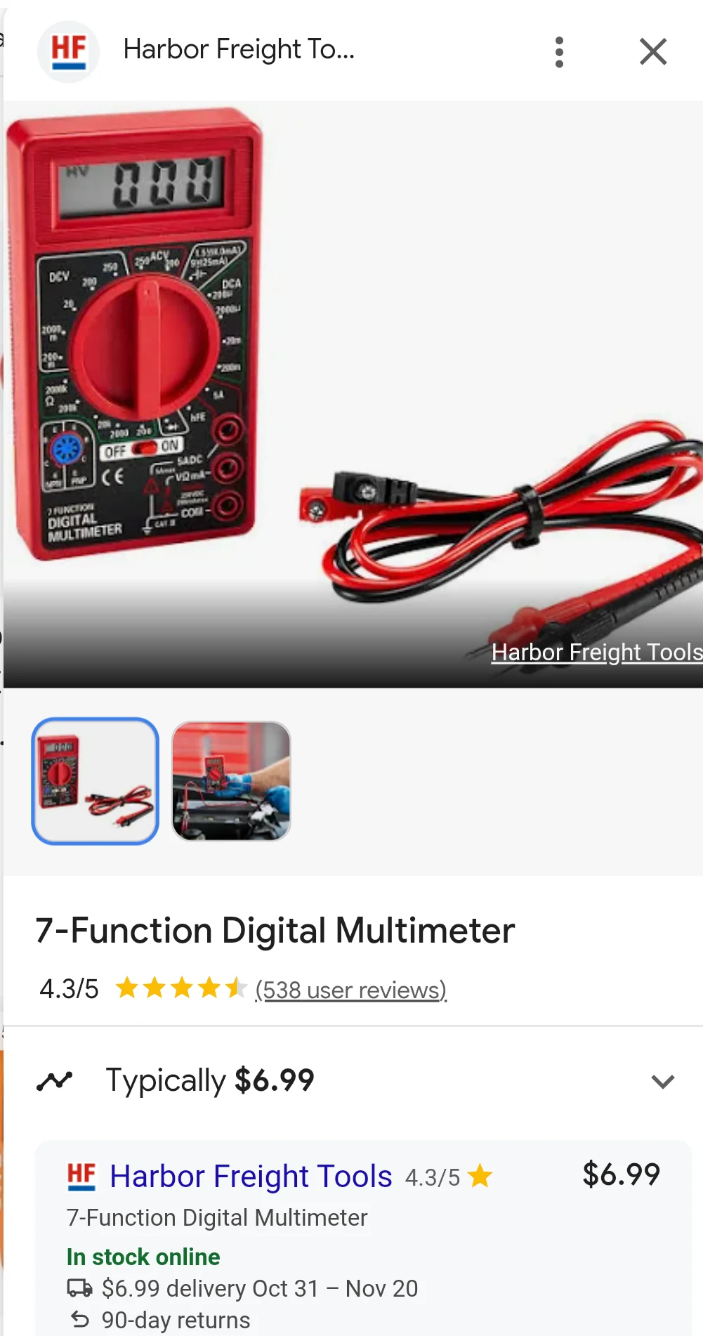

kinda sounds like something drained your battery prior to the start attempt. If it happens again try to get a battery voltage before you jumpstart the car. Voltmeters are super cheap and incredibly handy.
