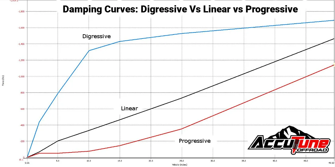

My notes could be wrong, but they say that FOX are linear and Dobinson are progressive

Interesting but good point! I’m not sure how that would ride overall. I’ve heard good things about Fox, but to Red’s point they do require more service.
