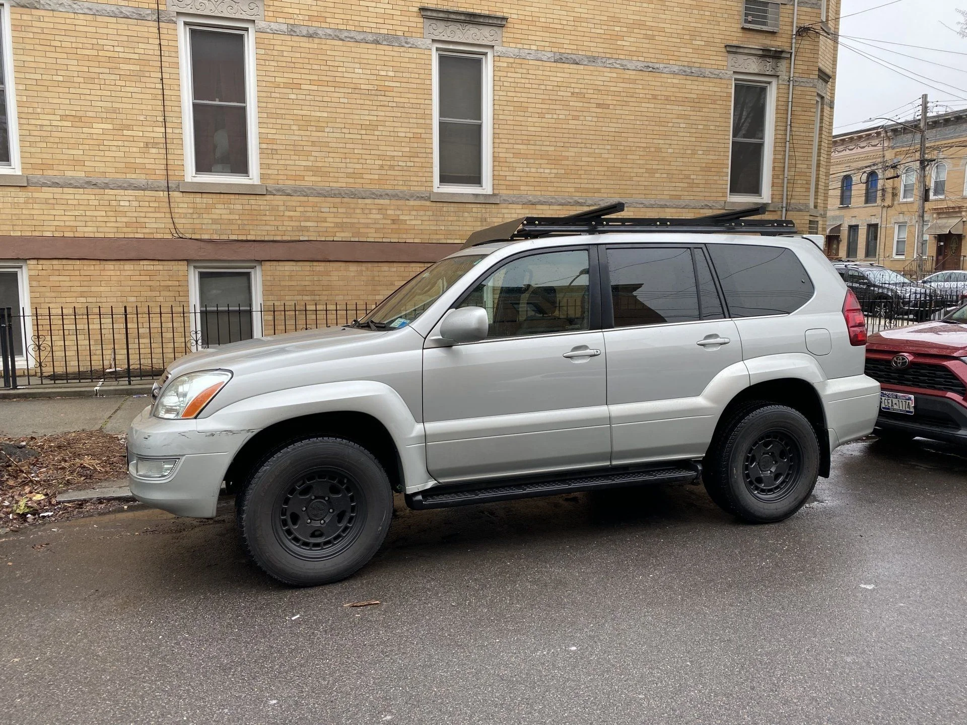

I found the install to be very easy. I got the fairing as well and so far the wind noise doesn't bother me. Depends how sensitive you are to it. I don't find it excessive. Here are some photos with the leitner cross bars I ended up installing so I can mount the tent. I think I'll make some custom brackets for the tent so it can sit directly on top of the LFD rack.
awesome, thanks for the response and pics. I think i will follow your lead and get the LFD side rails and a couple more bars rather than messing around with the other fairing options.
