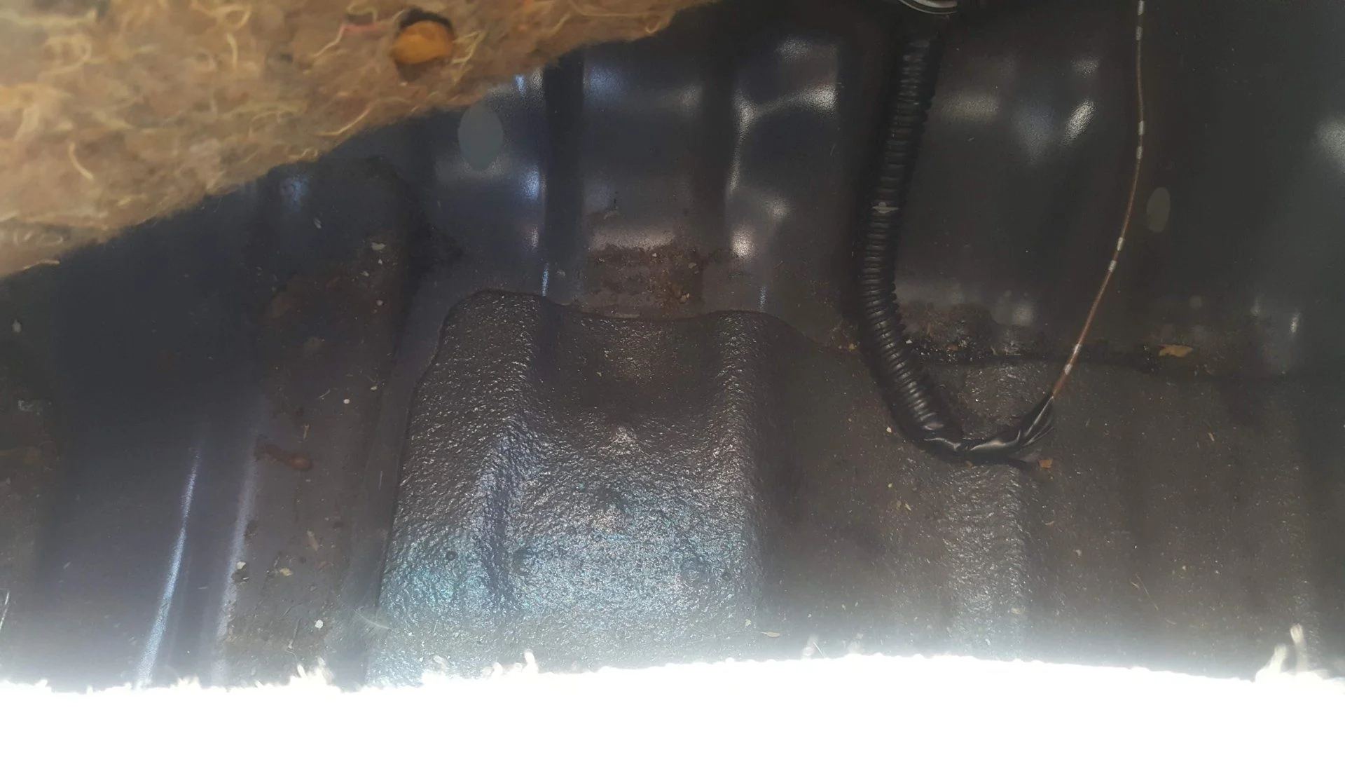

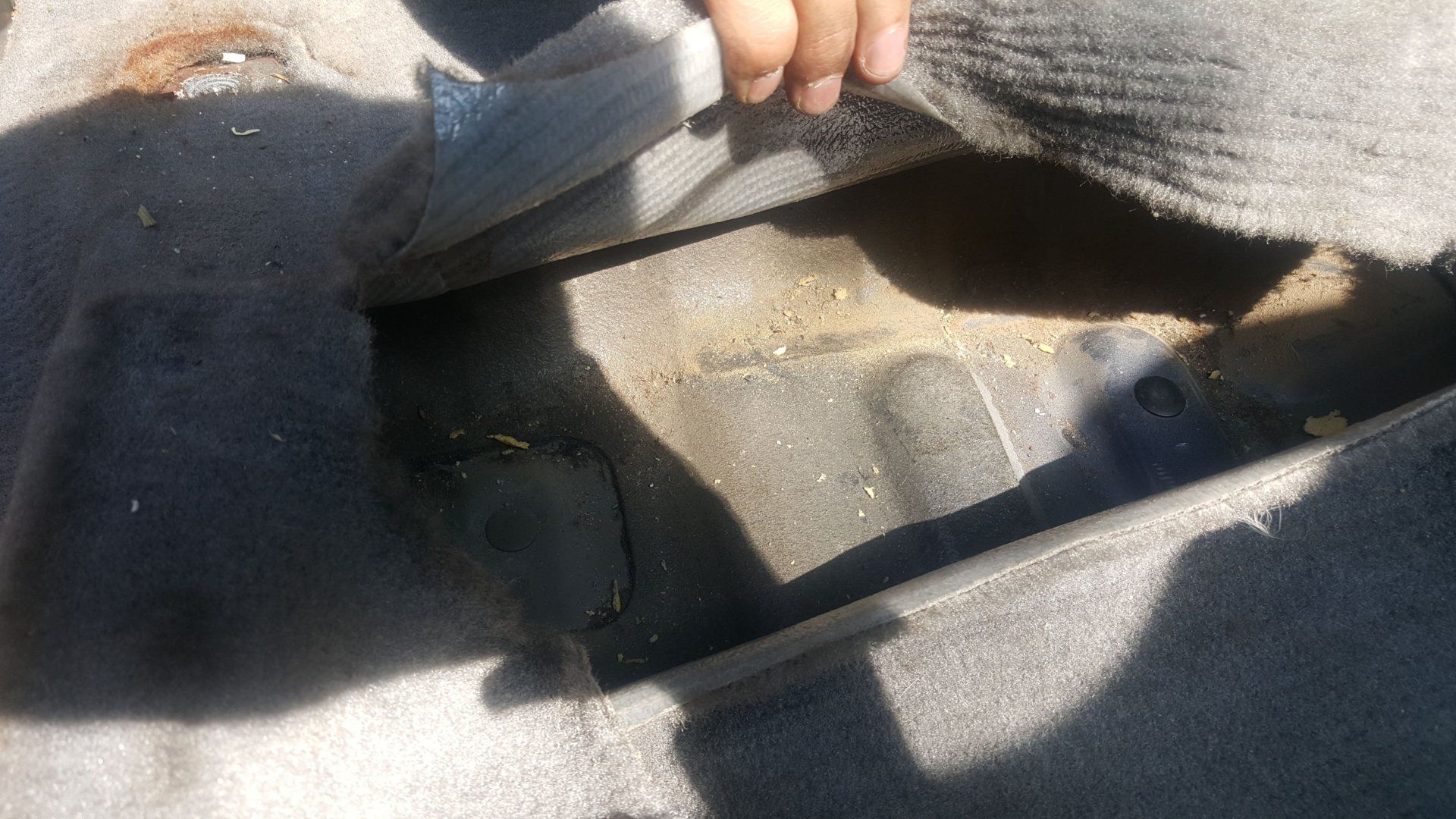

I read that unplugging the factory amp should do the trick, so I tried that. I read that the factory amp should be under the passenger seat but it wasn't. Not even under the carpet.
I checked behind the passenger dashboard, but nothing similar to an amp was there either...
So here I am, asking for your help. It seems as my Land Cruiser doesn't have an amp?

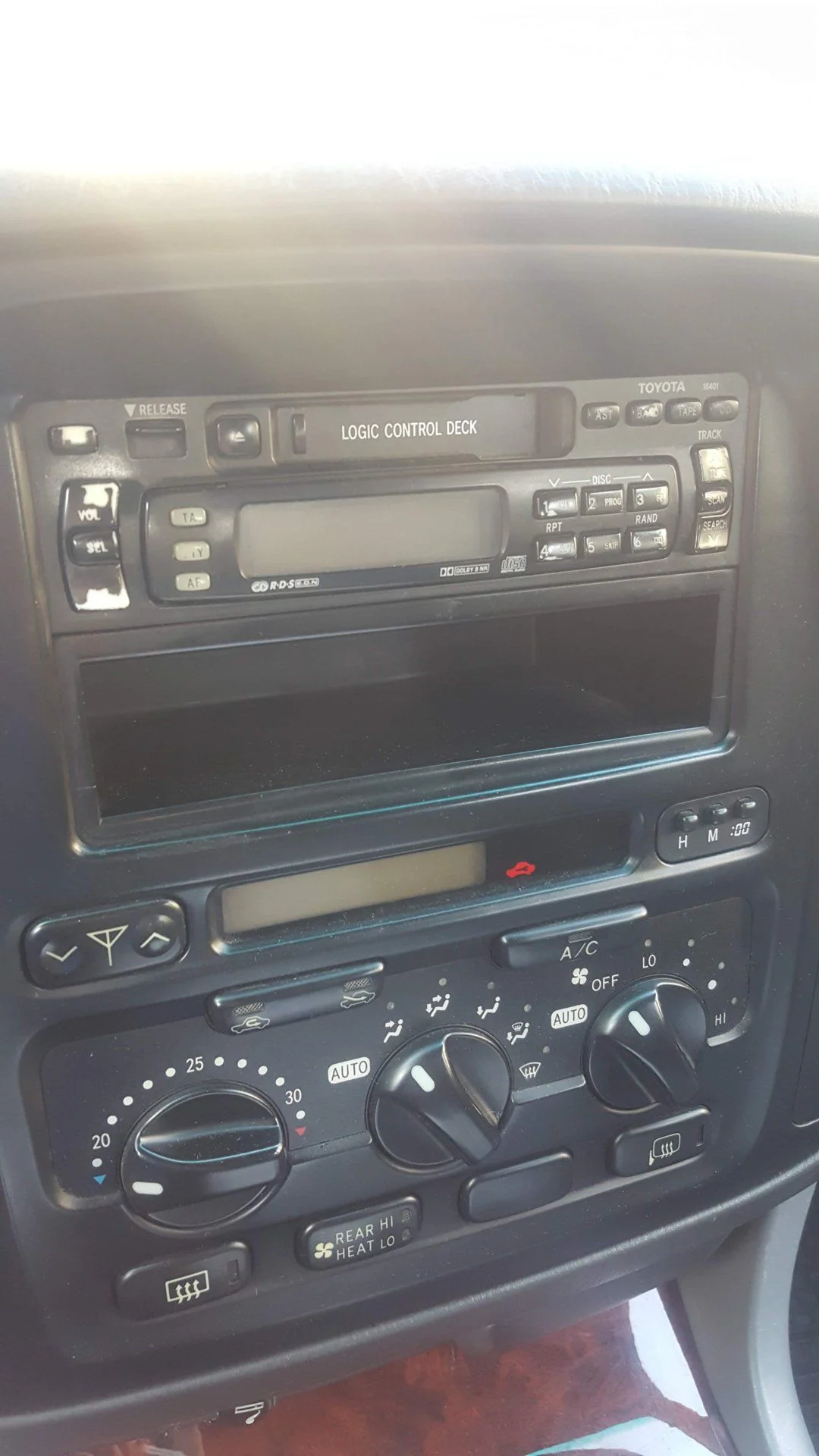

Here is a picture with the OEM head unit, and the back of it :

From what I saw under the passenger seat, there weren't even loose cables, because I thought that initially, somebody took it.
From what I believe only very few European Land Cruiser came with the factory amp. So in your case the radio is connected directly to the speakers.

Just fixed the problem. What was causing the whine were the screws holding the double-din assembly in phe dash (single din radio + storage space in my case). I removed the screws, and just clipped the center console over. The clips on the console are strong enough to keep everything in place, and the whining is finally gone!
