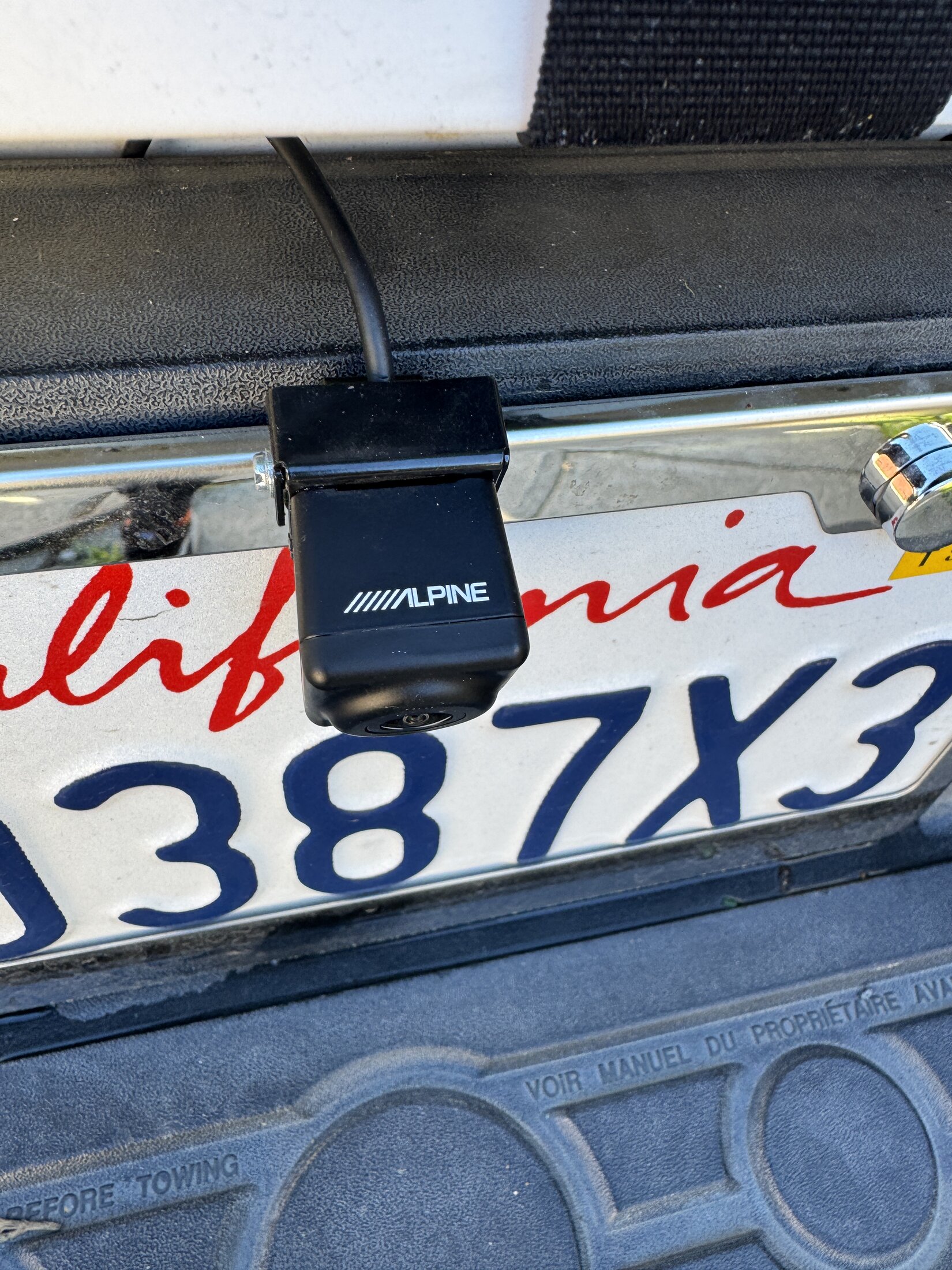

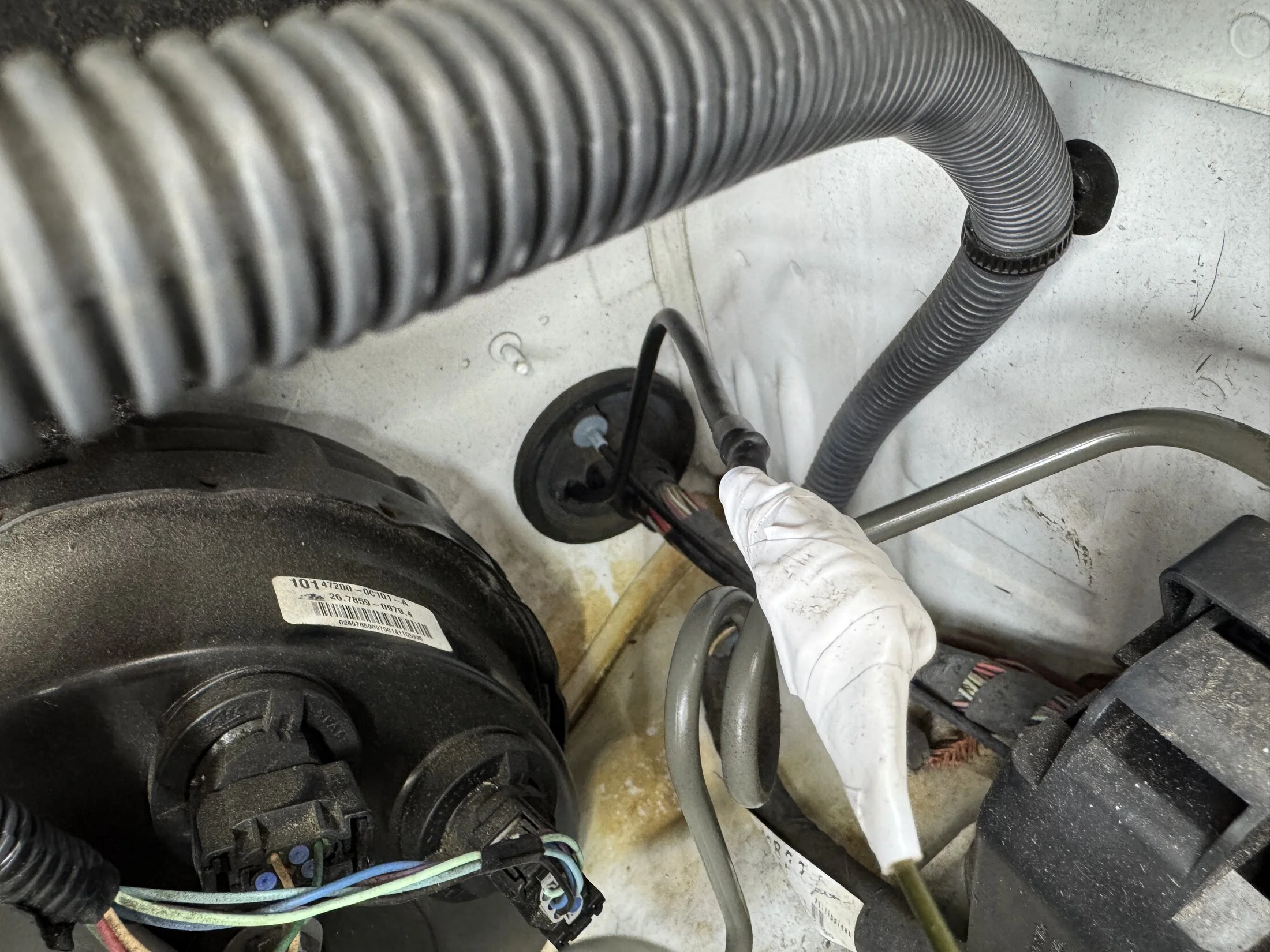

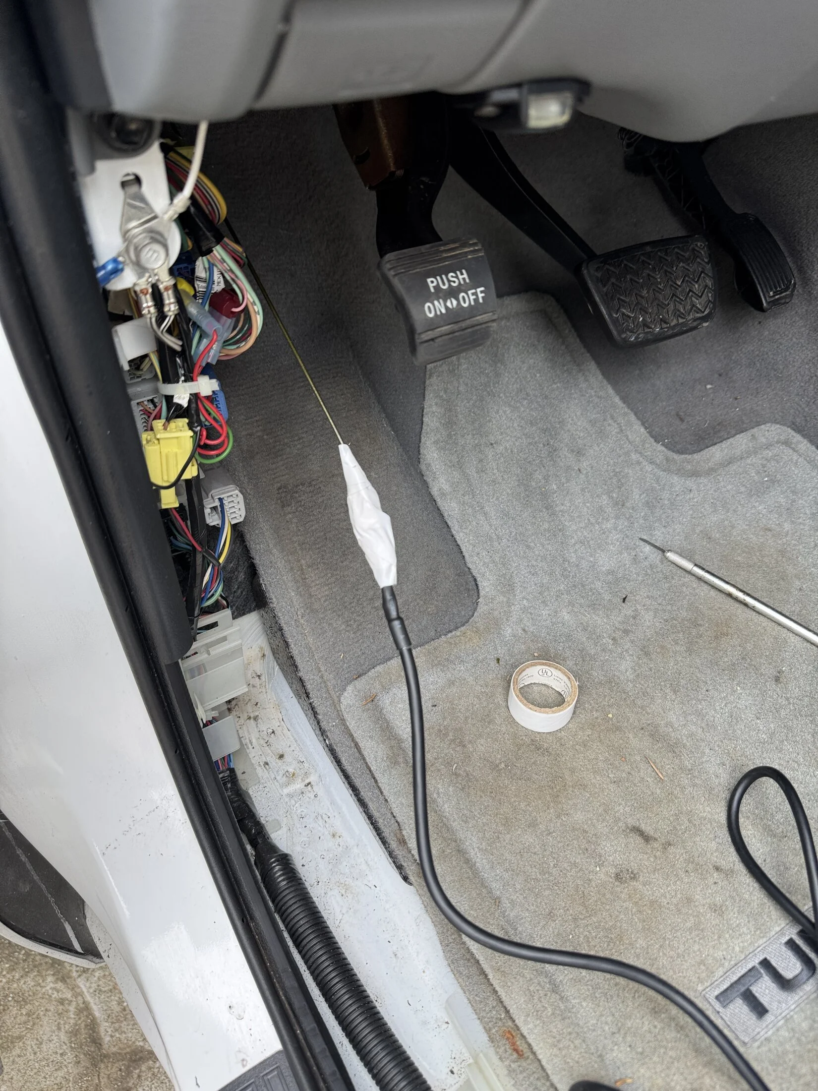

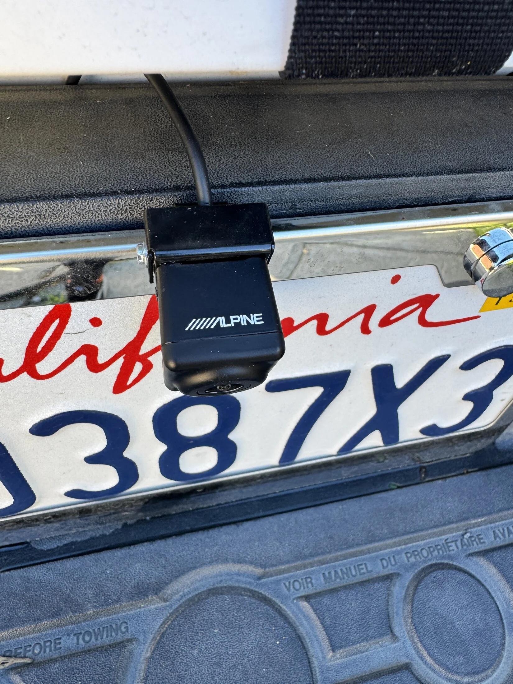

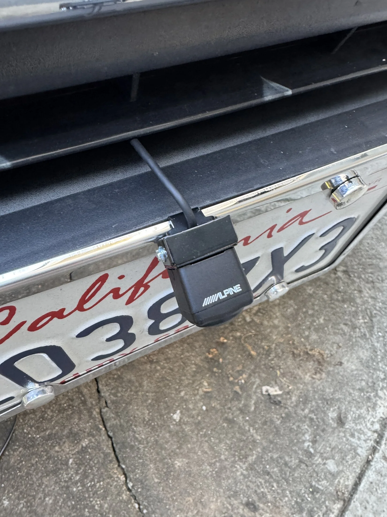

I also added Alpine front and rear license plate cameras. I was worried that this would override my stock backup camera that lives in the tailgate that displays in the mirror but it didn’t. That one still works and still displays onto the mirror and the new one displays on the head unit. I leave my bike pad on the tailgate often so I wasn’t able to utilize this camera much. I’m really glad both work. I ran the front camera cable through the fire wall grommet (cut with round tip Exacto Knife and straightened out coat hanger) on the driver side and the rear cable right behind a floorboard grommet under the driver seat.

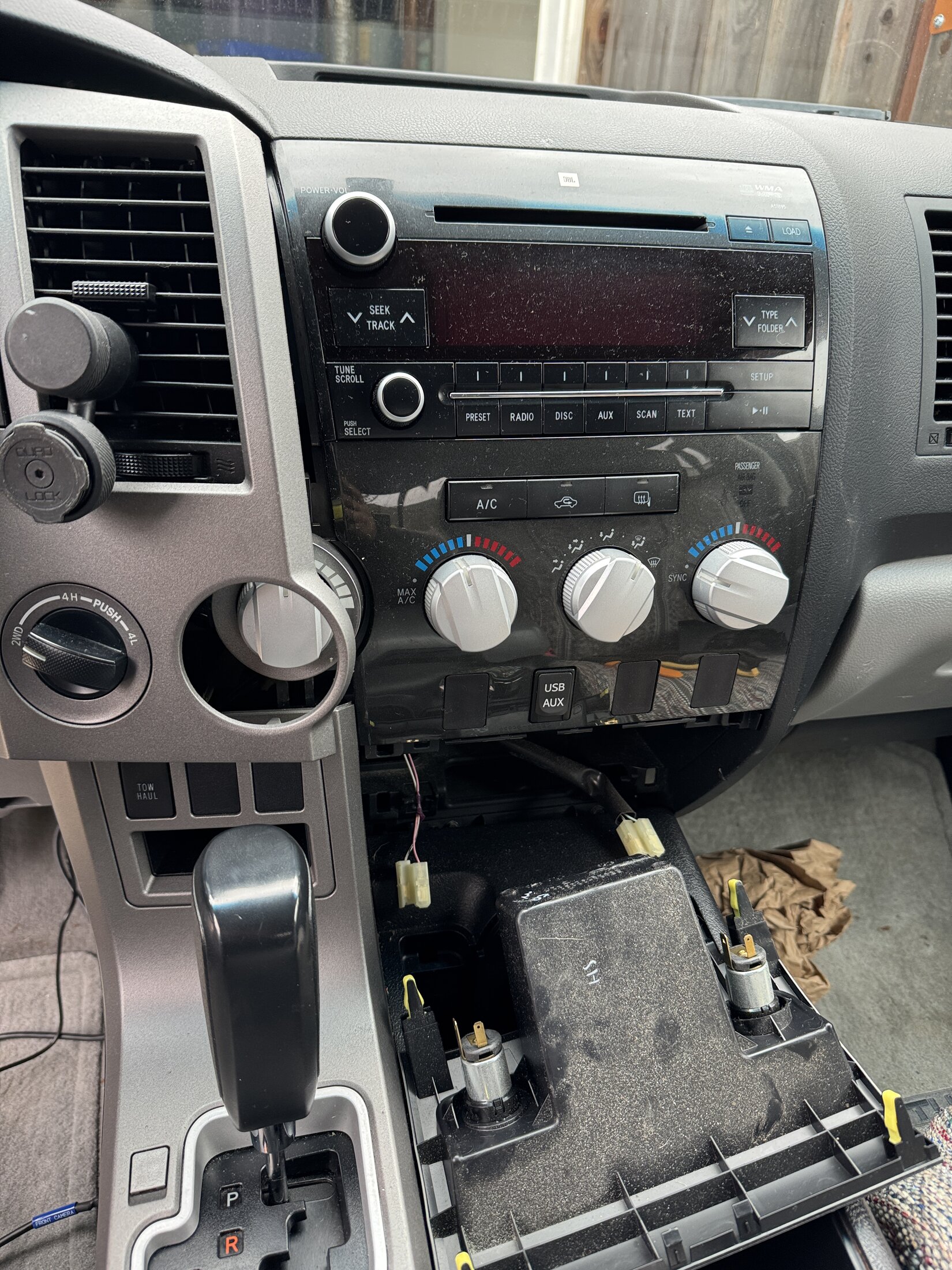

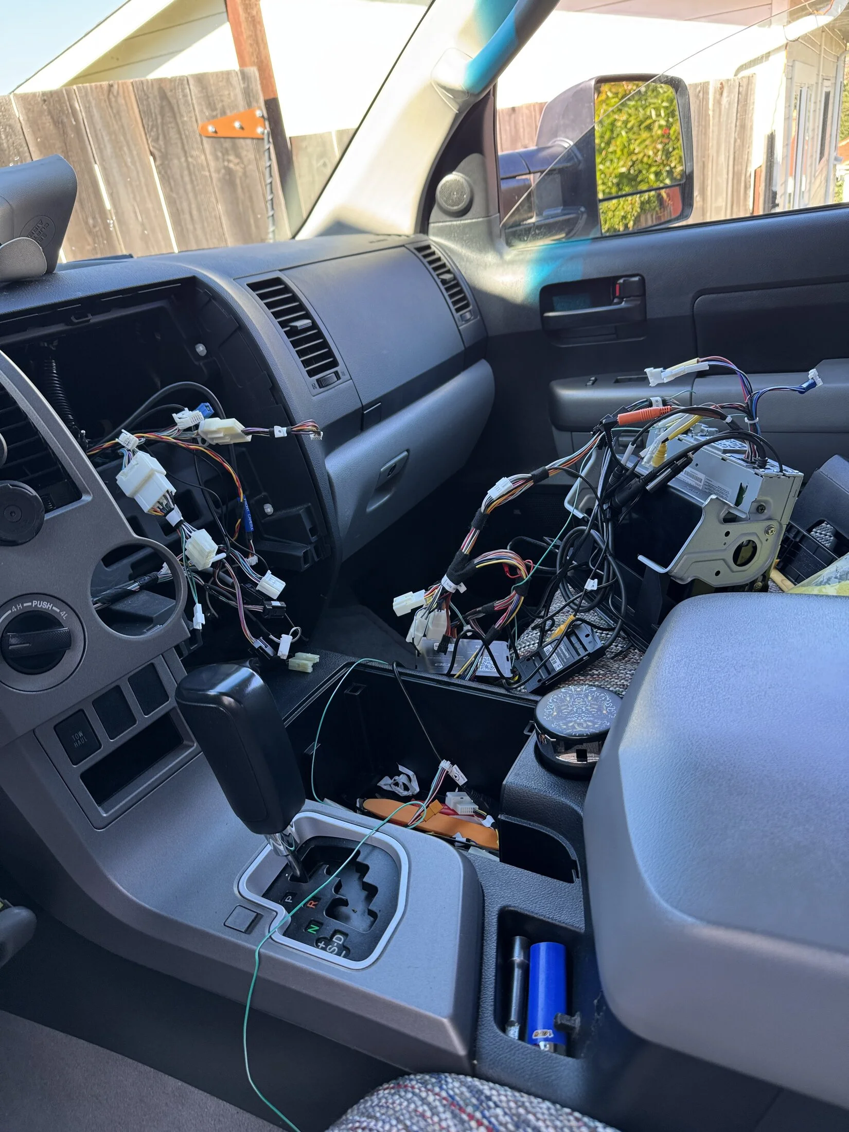

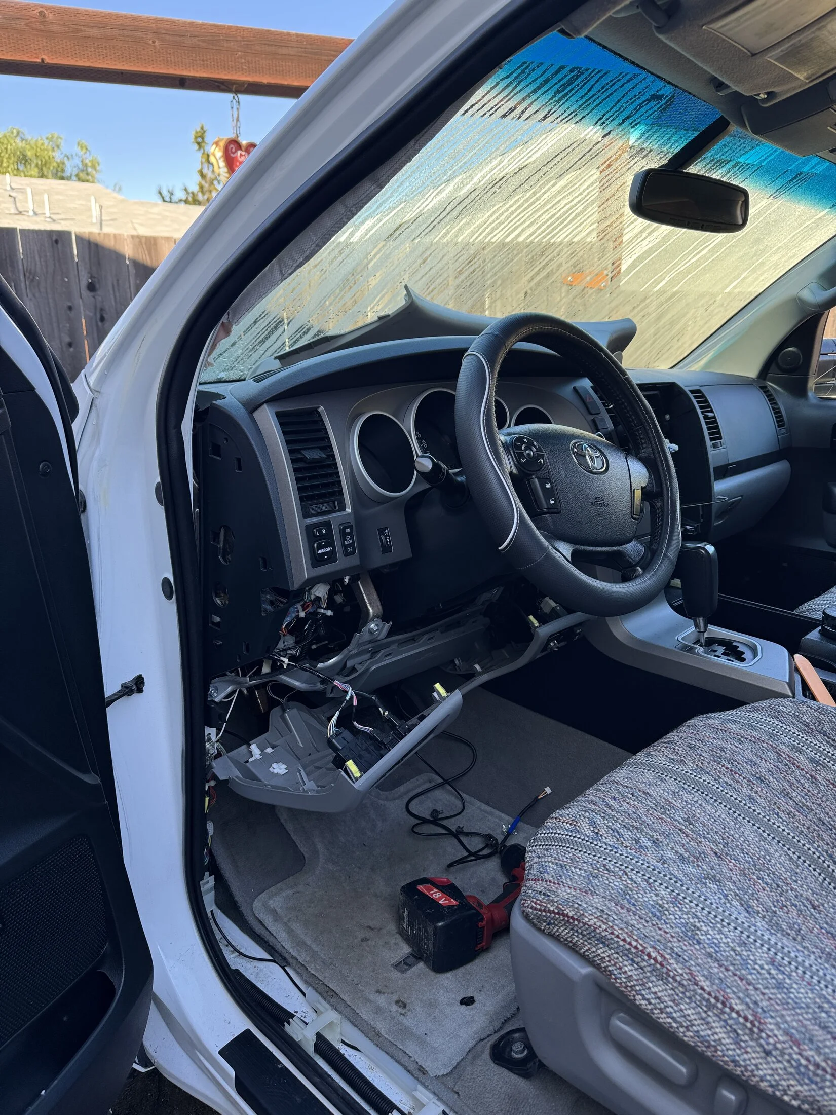

Breaking the dash down
Coat hanger through the drivers side fire wall grommet
Pulling the front camera cable through the fire wall grommet through with the coat hanger.

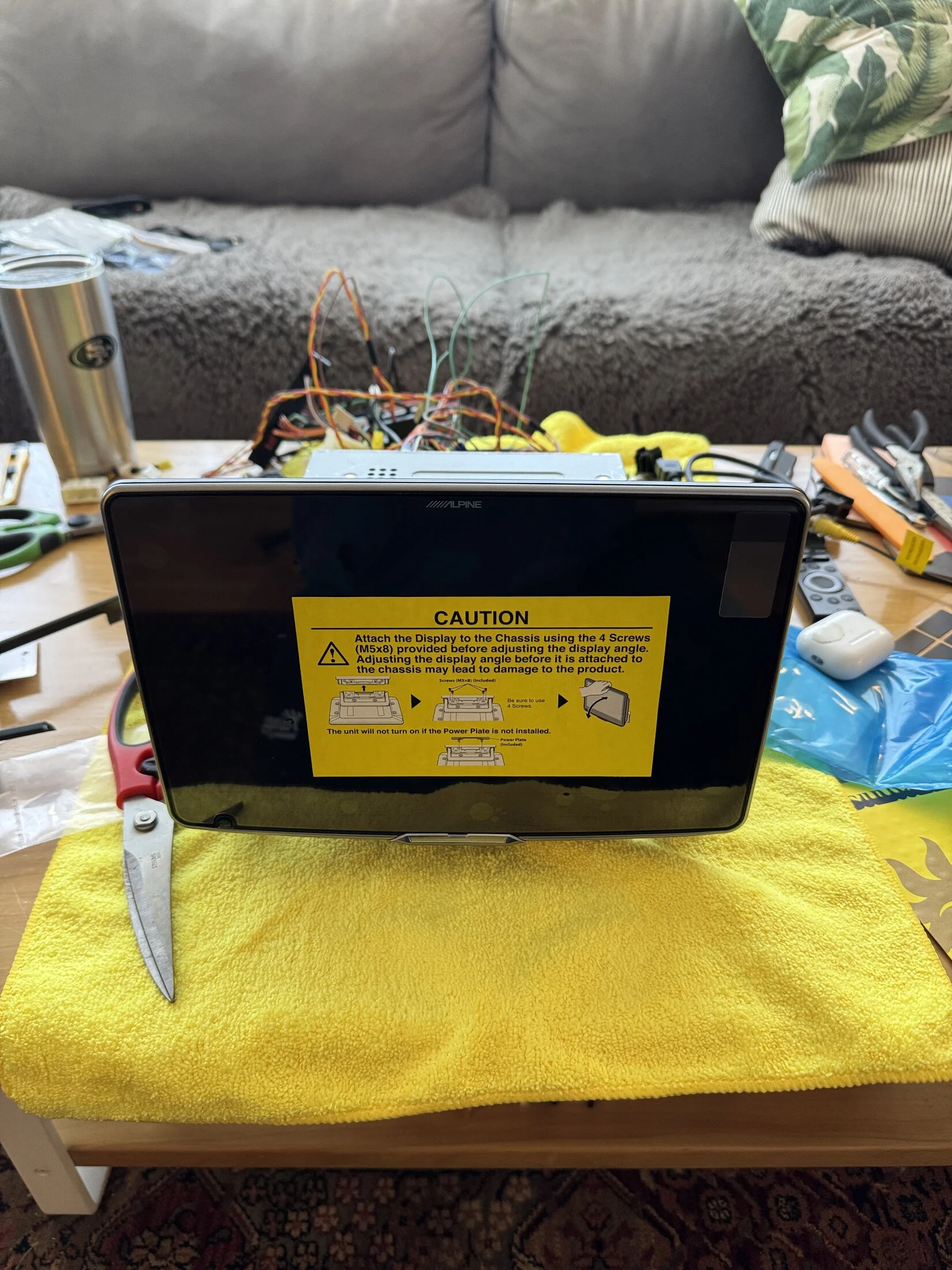

Wiring the head unit up in my living room.

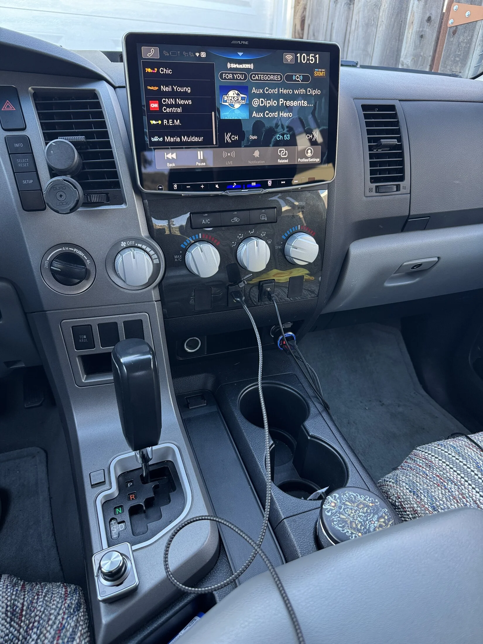

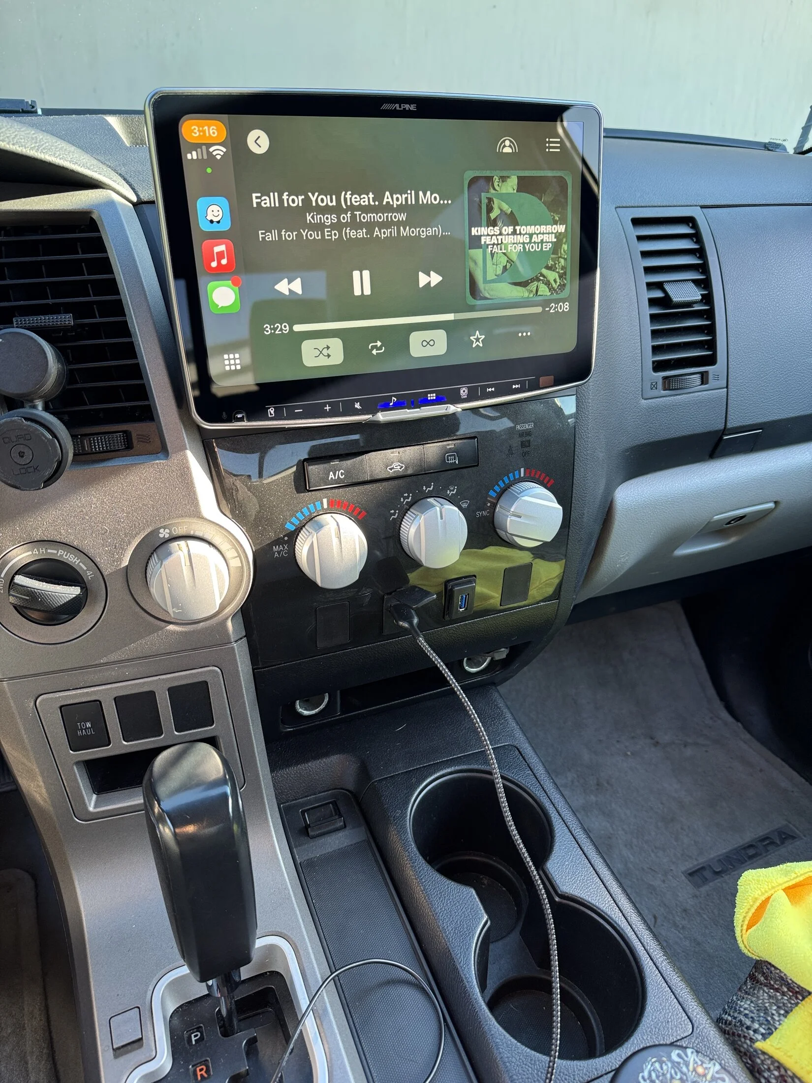

Installed and buttoned back up
Bluetooth volume control behind the shifter

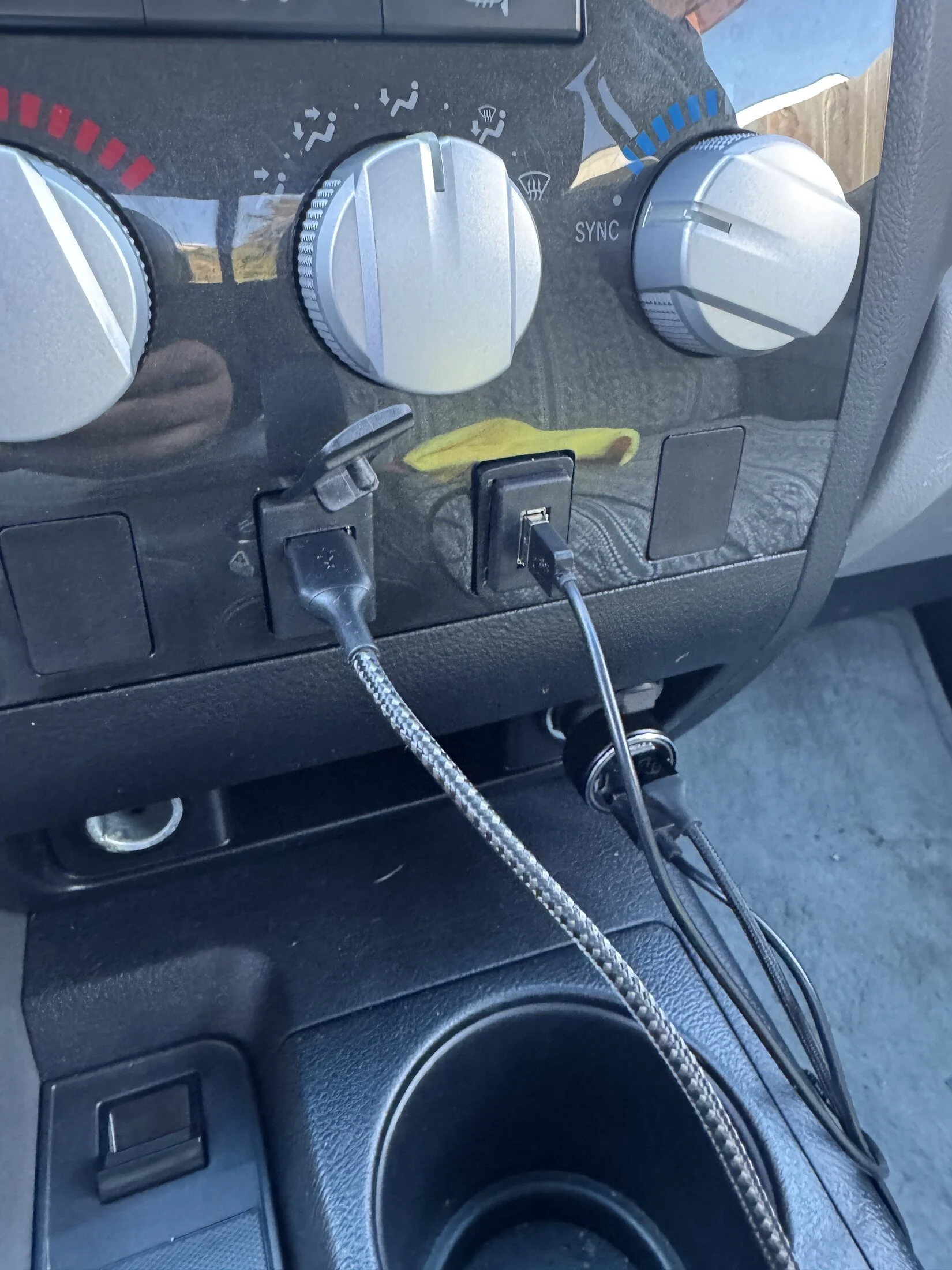

USB and 1/8 Aux on the left, this connector supplies signal for CarPlay. The right USB is for power only. I had to cut the right Toyota blank with my Dremel to get the USB to fit. The kit from Crutchfield didn’t come with either of these so I bought them on Amazon.
