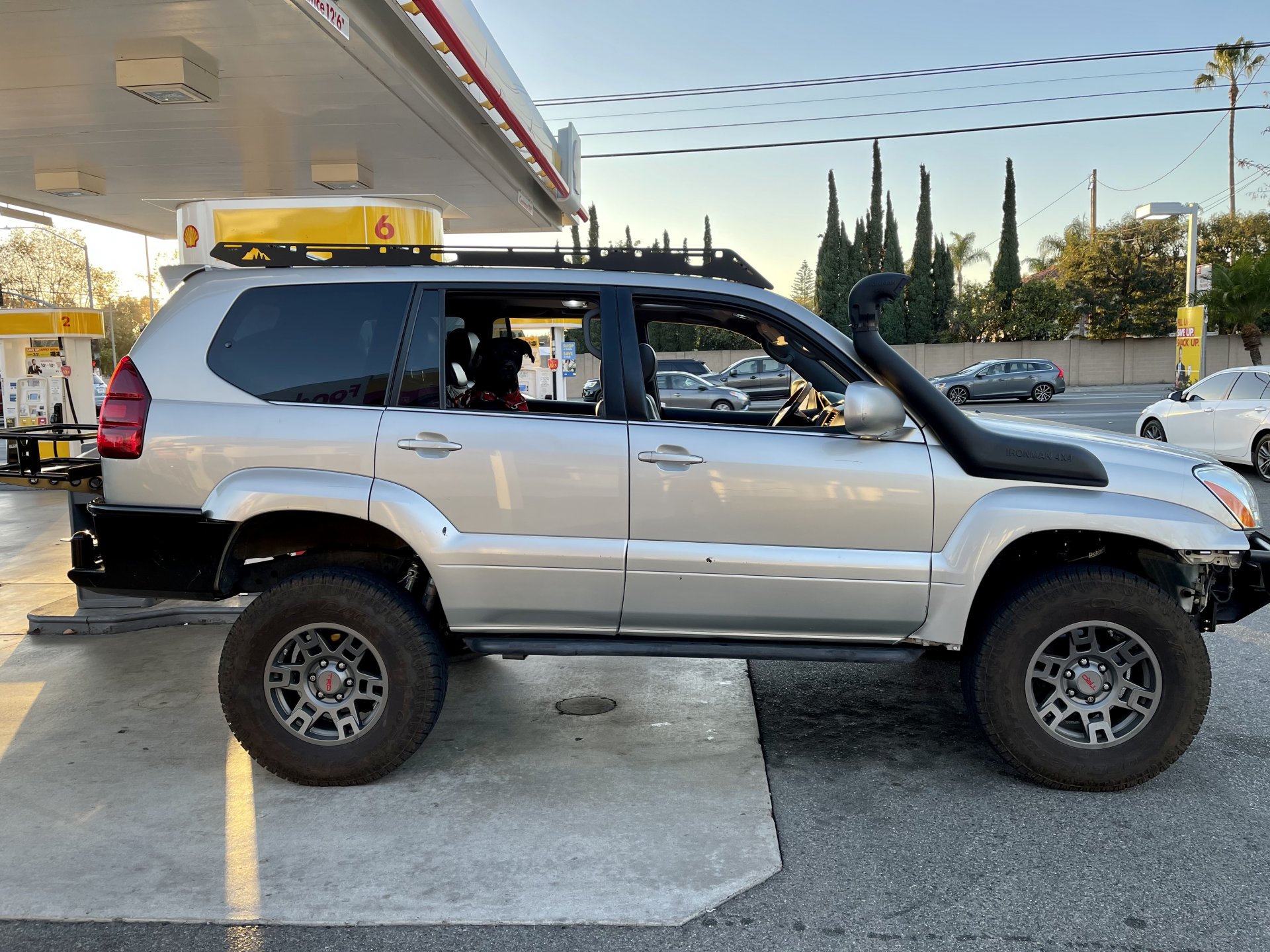

For my GX, with 32" C rated BFG KO2s on stock-ish wheels (and other similar rigs I've had in the past), I have typically ran:
40 psi on the street.
25-30 psi for rougher forest service roads or faster trails.
20 psi for slow trails, mixed snow, or sand.
No less than 15 psi for deep snow or soft sand, and that's only at low speeds. This is my personal cutoff for "normal" LT tire setups without beadlocks. If you have P-rated tires, you need to get LT tires anyway :D. But really, P-rated tires will get damaged way easier aired down as the sidewalls get more vulnerable.
