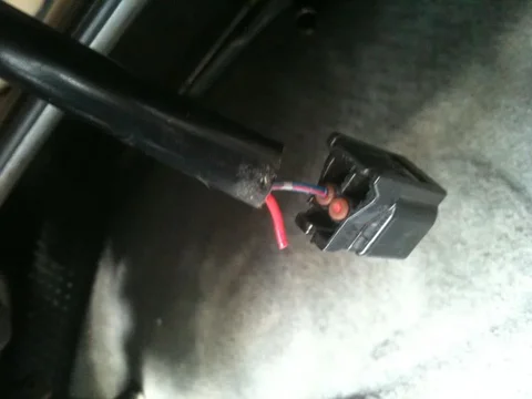

Had my SRS/Airbag diagnostic done at the local dealer today. Turns out I have a bad driver side seat position sensor. Blasted same issue I had with a Honda a few years back. I'm ordering a new sensor ~$60 with discount, will install then have module reset (will pay dealer $100 for this service).

Follow up on my SRS issue. As described above, dealer pulled code and told me driver side seat position sensor was bad. I ordered new sensor, and it turns out I didn't need it. I should have taken the seat out to have a look first. See pic below.
One of the wires to the sensor connector was severed. I ordered a new connector, and two repair wires for a proper connection. I soldered the new wires, and used heatshrink to make it tidy. Started up the truck, and the Airbag light cleared as I expected. Repair parts ran $40 and an easy fix, albeit quite rare I imagine.
Parts: 90980-12195 Housing connector (1 quantity)
82998-12720 Terminal, repair (wire) (ordered 2 quantity)
