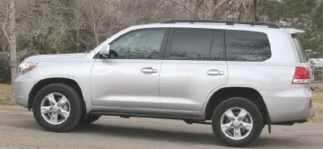

I just had some COIL-RITE (Firestone Industrial Products Company) rear air bags installed. With the minimum pressure of 10 psi they raise the rear of my stock Cruiser by about 1”. With no load it rides just a bit firmer in the rear. It’s barely noticeable. Maximum pressure is 100psi which is more than I'll ever need. They cost $105 for the kit, and labor was another $100.
I’ve ordered Icon springs and shocks to bring the front up. The plan is to get Icon shocks for the rear too when they become available.
I’ll post pictures soon.

Here are some pictures.
FirstToyota, that's good news about Icon.
The bags are connected via small tubing to a tire valve mounted on the bumper. One valve serves both shocks. Airing up or checking pressure is the same as for a tire.
Firestone has an on-board compressor and controller called "Air Command", but I didn't look into those. They're on the same web site as the bags.
If you are really sure that you will never have to haul a big load, then I would think the Icon spacers would be a good solution. They should not change the ride at all and ought to be bullet proof. I like the flexibility of the air bags, but you have to keep a minimum of 10 psi in them so you always have a small lift.
I think the air bags are pretty reliable. They've been around for years. Another company, Air Lift, makes them too, but not for our 200 series Cruisers. I had them on my last SUV, and they worked as advertised. Maybe some other members could share their experiences.
