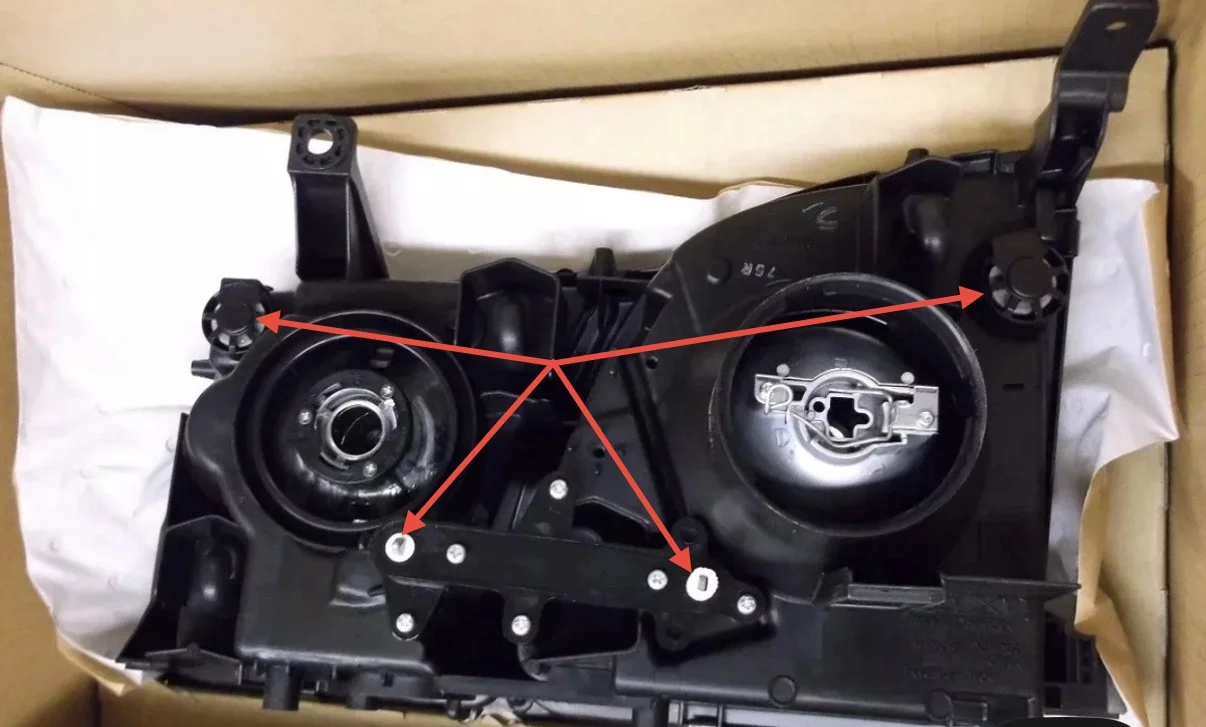

Does your HL housing still have the adjustment bolt/screw?
Yes- one for vertical adjustment, one for horizontal, however they’re very stiff to move and I haven’t gotten clear answers to my question what do the adjustment screws look like? I’ve watched all the YouTube videos. No help
I am not sure how the guy that did the HL retrofit do it but when I retrofit headlights for my clients I make sure I leave that adjustment operational. I hope he did not glued it in or when he put back the headlights that he disabled/stripped the threads. But I am positive it shouldn’t be stuck/stiff at all.
