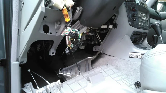

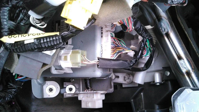

I also unplugged the ahc ecu under the dash (make sure you unplug the correct one!)
Model years are different. Buy the manuals. I am so glad I did.
