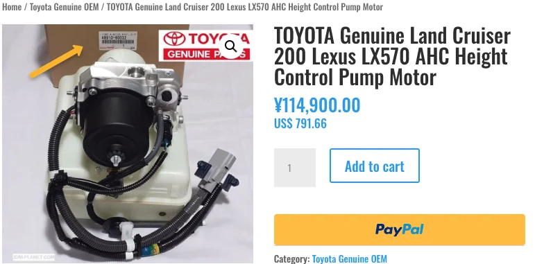

Hi all, I'm needing to replace the AHC pump in my 2008 LX.
My Lexus dealer is quoting a massive number (more than $5k just for the part) for this job here in Canada, and I can find the part for almost 5 times less money here:
It appears these are genuine toyota parts out of Japan. HOWEVER, the part number they have on their website: 48910-60032 is ONE NUMBER off the part number that Lexus is recommending: 48910-60033.
The guy at the parts counter there said that this could perhaps be just an updated part number OR it could actually be they changed the part.
There's a massive price difference here... So big that it raises concerns whether or not these are oe factory parts. Does anyone know here? I know there's a few from this forum that have used that site and been totally happy, so that's a start.
Does anyone here know or can confirm if the part itself was updated? Or did Toyota just update the part number? I can't imagine I should bite the bullet and pay 5x more just to ease my mind?
It was just superseded. Partsouq lists 0030, 0031, and 0032 as part numbers for the pump. I have ordered all kinds of AHC stuff from JDMplanet. It’s all legit.

Interesting, I wonder why they do this? I see what you are saying... I wonder if the part is different, or perhaps just internal cataloguing purposes?

Probably both. @OGBeno might be able to shed some light.
When the last number of a ten-digit Toyota part number changes, it generally indicates the following:
1. Supplier change for procurement
2. Engineering change to part
3. Material change to part
4. Blueprint change to part design
5. Application change for part

Thanks for this info!
I wonder if the changes had to do with any internal issues they had with the original, or if anyone that bought those had issues prompting the change. Just natural questions i have... That being said, there's a $4k (cdn) difference between the two. I think I'll take my chances. :)
