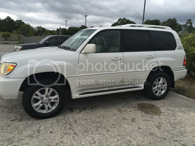

I ordered slees AHC over ride and then yesterday tinkered with my ride height sensors to get the lift that way. I did the max I could go in the front and not quite max in the rear to level it out a bit. Now because I'm maxed in the front if I put it in high mode it drops back down to normal. I expected this but now I'm thinking why did I buy the over ride. I guess it's a one or the other thing. Or is there a reason you would do both.
Here's how it sits now. I'm literally at the tire shop now having my tires mounted so forgive the small rubbers.
I didn't see the point of the SLEE override kit. It just keeps the ride height stuck in the highest setting. The sensor adjustment lift puts the ride height in the H mode BUT reads as the N mode on the dash which means it can actually go another 2" higher. That 4" lift height it almost useless on the trail and sketchy on pavement but for simple added approach angle for a couple feet of forward movement, then it's nice to have those 2 extra inches. It's also nice to have those 2 extra inches when crawling around underneath doing work. At first I had a hard time getting to the "H" setting after the sensor adjustment lift. I am pretty sure I was bottoming out the front shocks. I added the Japan4x4 shock spacers and can now go into the "H" mode WITH the sensor lift without any issue. You would NOT want to get the SLEE override with the sensor adjust and then try to drive around in the "H" setting. That would be a terribly stiff and unstable ride. Would be even worse on the trail.
the reason to do the slee is, if you want, you CAN return easily to factory height for a long highway drive for better comfort/handling/MPG. with tricked sensors, while you have the ability to drop into low it will return to N once you get above 17mph.
Ben makes some good points as well about getting a quick couple inches for approach or to get under the truck.
