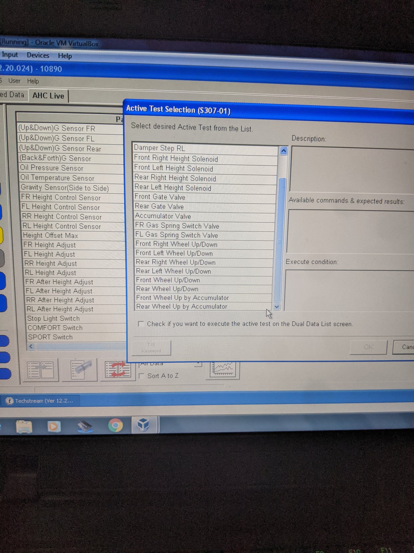

If I go to Active Test I see several options, see pictures.

Of the tests pictured accumulator valve looks like worth a try
