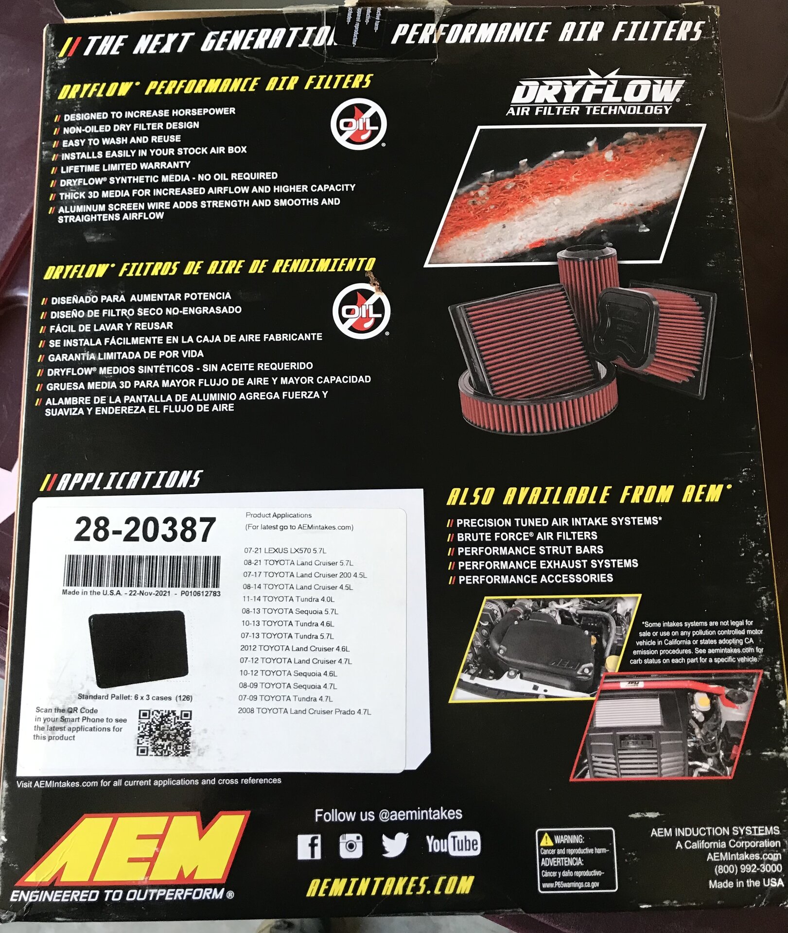

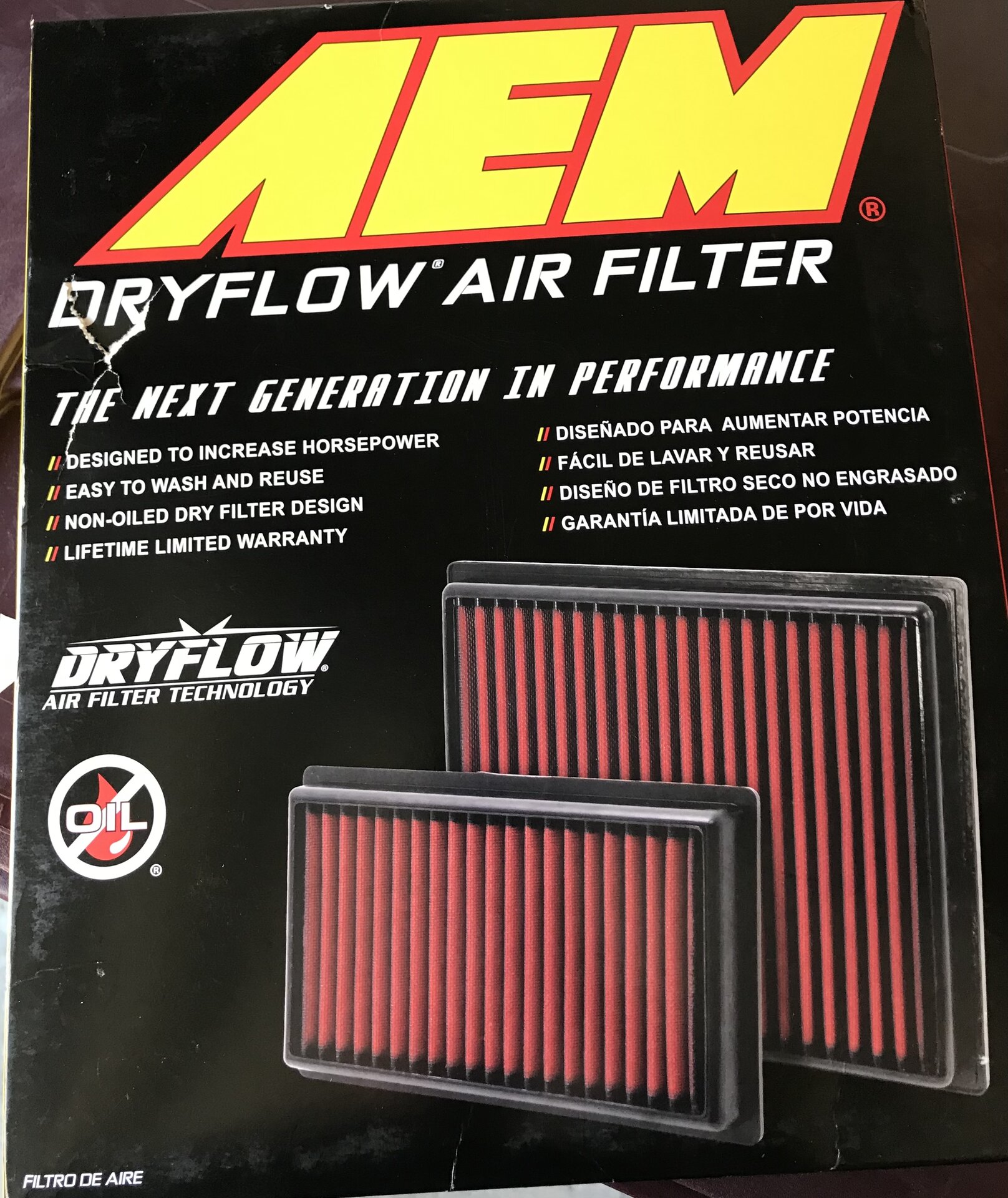

Greetings,
I know that air filters are like oil/oil filters—no consensus.
I’ve a Safari Armax snorkel which rates well for air-flow, plus location may keep dust/grit down a bit. I’m in the Southeast where dust isn’t much of an issue for the most part.
My recommendation is the AEM Dryflow drop in air filters because I don’t have to oil them—and I can clean them as often as needed (the synthetic media dries quickly).
I’ve used/currently use them on every family car/truck where there is an application with no issues. Also, I prefer not throwing away a bunch of paper air filters.
Of note: The filter rubber gasket is quality, uniform, thick, and pliable— and air leaks should not be an issue.
I figure for the Starbucks runs and daily driver use, the filter should suffice.

I agree that for daily driver or starbucks runs, probably fine.
From the degree of dirt and silt I see in my off-roading, even if it's just a day trip, it's pretty intense and I'll say I don't trust much of anything other than OEM for that use case. Dirt into the engine is like sandpaper. Maybe it's regional but here in the southwest, sand can be fine enough that it's like talcum powder. Hangs in the air making for blinding conditions, even with chase lights. Buddies that forgot to clean their intakes loosing major HP thinking something more serious is wrong. I always clean out and change my filter after off-road trips, and it's little money for piece of mind for the larger vehicle investment.
I know you have a pretty sweet rig too, and you're trying to do the best for that investment. My perspective, but with filters cheaper than gas, I'm happy to chuck and swap them for that extra level of protection.

Stock filters are very high quality and effective. I don't see any reason to use anything else.
Plus they aren’t paper.
