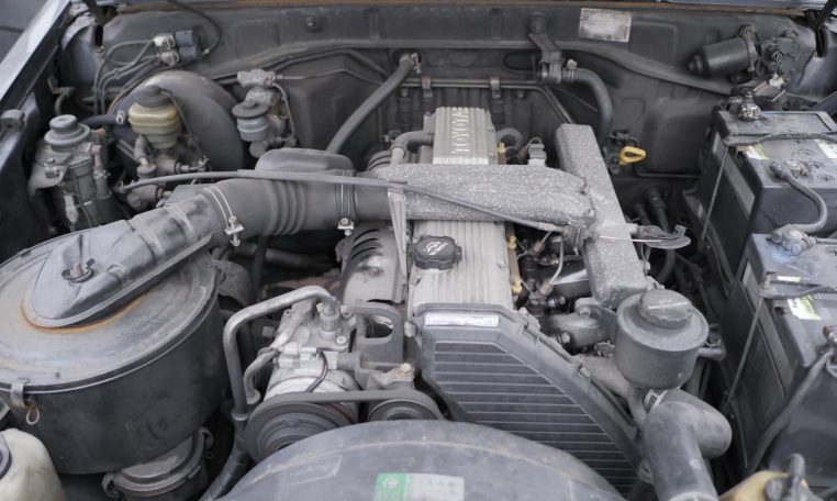

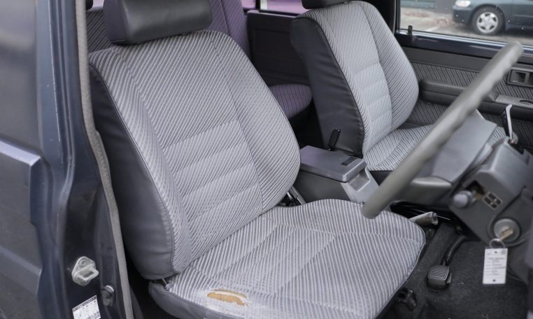

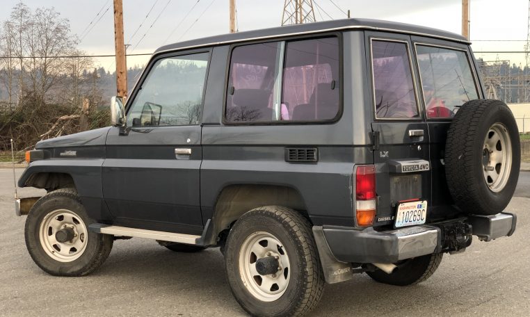

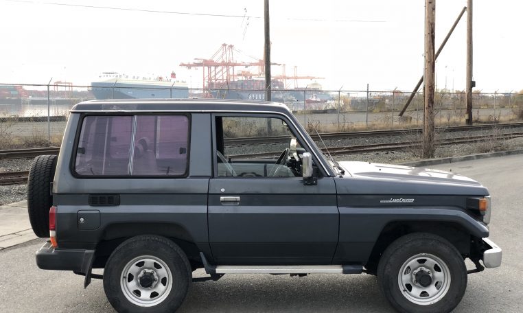

Here are a few. They don't show much I know, I did not take pictures of the vehicle while I was there. The two things I worry most about is the mileage and the steering. I know everybody says these things go forever, but nothing goes forever.

Driver's seat upholstery usually rips in that place with age.
Suspension looks somewhat sagged but normal for its age. R085 axle has a Limited Slip Differential, or LSD.

Engine bay looks clean, as do the battery terminals. Check for non-factory wiring.
The 1PZ engine is almost bulletproof.
Overall, the truck looks good and so is the price.
A great project rig in my opinion.

You can get the material on the base of the seat changed, about $212USD.
