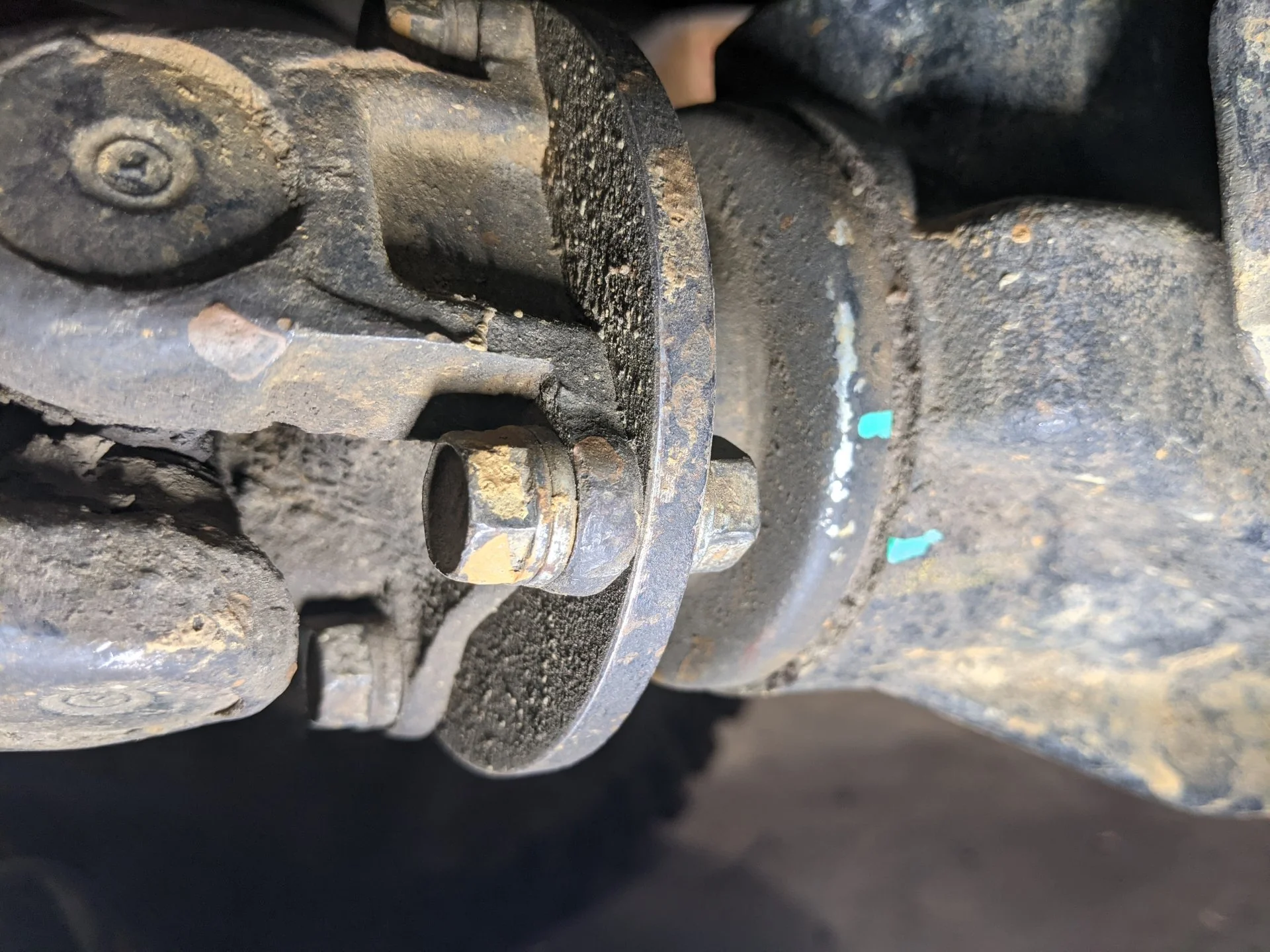

Here is a pic and vid. Hubs locked diff not.
Id say your carrier bearings and or backlash isnt set up properly. And possibly even your pinion bearing depth.
On a fresh-ish third member, properly set up, It should take atleast 1.75 ft pounds of force to get the pinion flange to rotate. That is 12" from the center line. So roughly speaking, grabbing the flange that is 4" total diam or 2" from the centerline should take 5lbs of force or 10.5lbs. That is the bearing preload. Not including the seal drag, and weight of the axle shafts. Your video looks like the pinion is loose/flopping in the wind. Hard to say from a video, but the preload doesnt look right.
If you gently grab the pinion and turn it and if the carrier preload is tight enough, you should be able to get a backlash feel. The pinion should move like.... 1/16th of an inch. Maybe less. Depends how tight they went on backlash. Probably not any more on a fresh gear set and build.
As ferg says, you could try and devise a way to hold the ring from turning to get that backlash feel, but the carrier should be tight enough to hold itself for a prelim backlash check.
Turning the pinion the way you and gnob show is checking total play from pinion to ring to spider to shaft to hub. Yours looks excessive, but Im inclined to say your excessiveness comes from an improperly set up r&p becauase you also have differential noise. To me that means either the gear depth isnt right, the backlash isnt right, or the bearing preloads arent right.

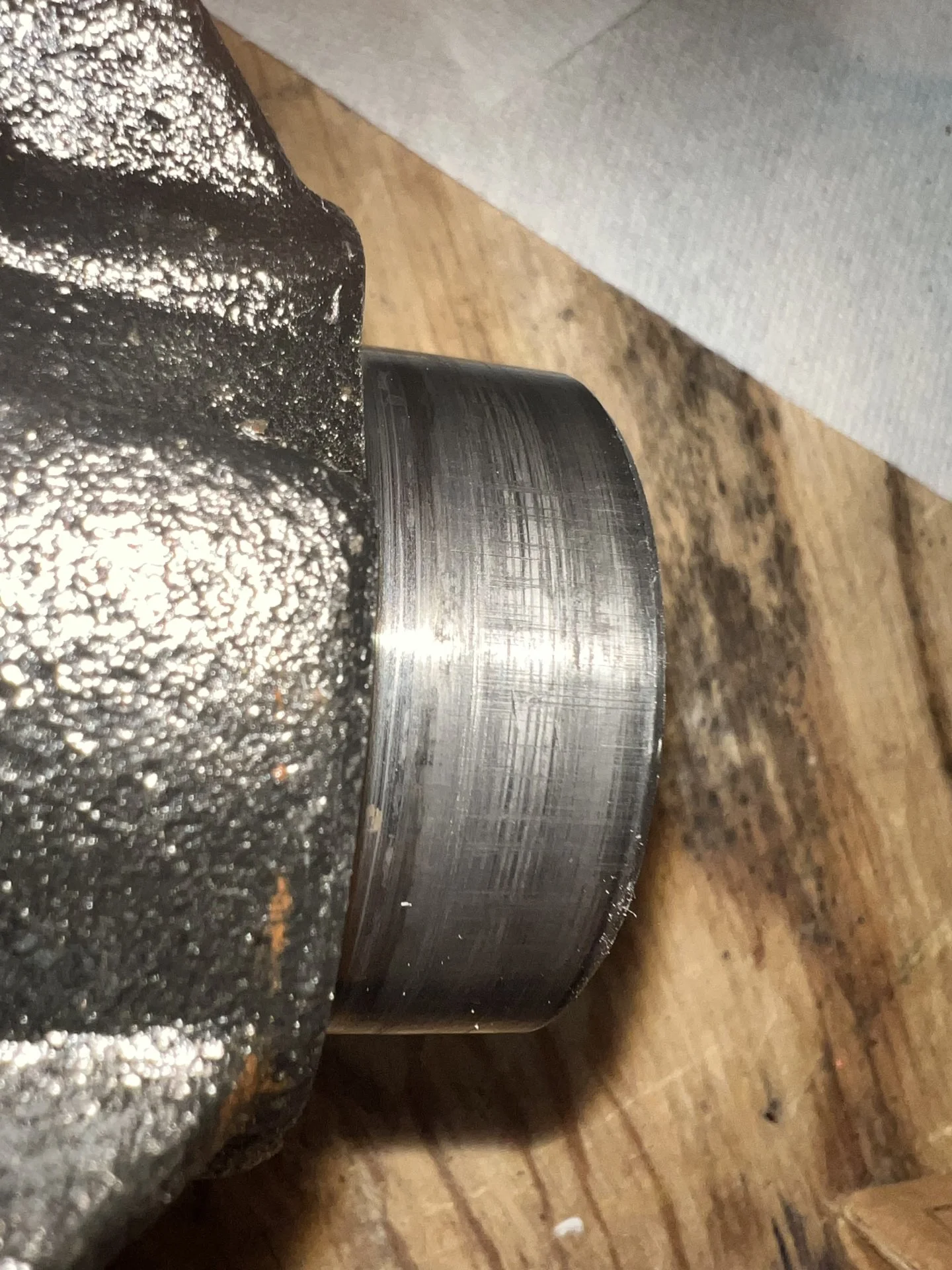

The source of the noise has been found and fixed. A bearing spun on the inner case and wreaked havoc on the other bearings. I was able to source a new case from triplecreations on eBay for a good price. They’re one of the cheapest sellers I’ve found if you can wait a week or two. Anyway, I was lazy and just ordered a complete kit from eBay with all the new bearings, crush sleeve, etc.
I still haven’t figured out where all the slop at the pinion was coming from. It’s possible that it’ll still be there when I get it reassembled. Hopefully it’s not an issue.
That’s probably a wrap for this thread. The aforementioned shop cut me a deal when they set up the diff this time, so everything worked out well for me.
Thanks to everyone who chimed in.
Here’s a photo with the worst of the damage.
