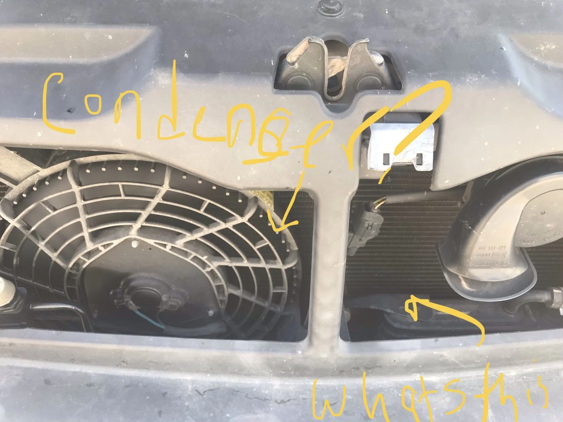

Is my condenser behind the aux fan, shown on the left of the picture? What’s the other little radiator below the horns on the right side of the picture? Is that the tranny cooler? My hoses coming off the little one below the horns are leaking and I want to identify so I can buy hoses.
That would be the trans cooler
