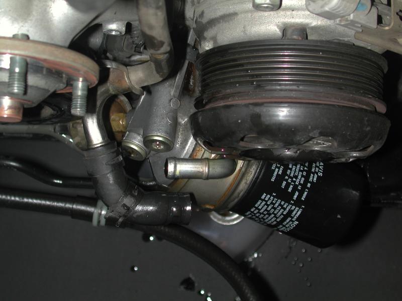

3)I'm pretty sure the cam sensor and a/c clutch wires are on the same bundle over there. You have to pull all the plugs to get enough slack to remove some of the cam cover. I would check and make sure everything is all plugged up.
You can barely see the plug in the top corner of this picture.
Check the how to section there are a few timing belt threads. I think you will see what I'm talking about.
