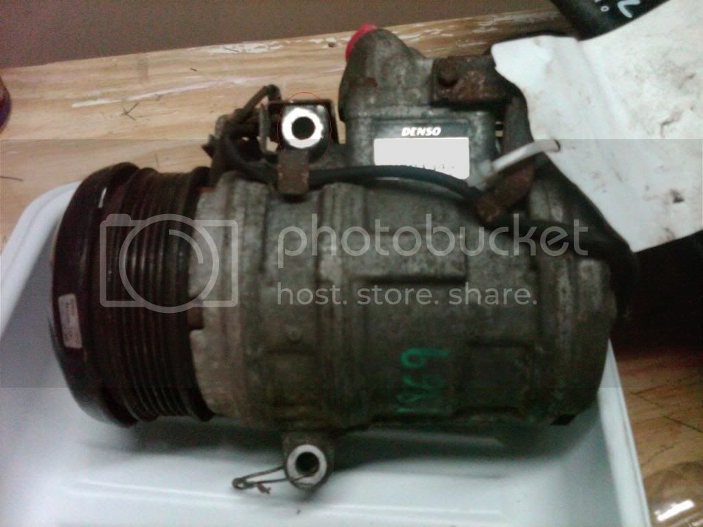

Found a used one on eBay - off a wrecked truck for about half of new cost. NOS was nearly $700.

So my AC compressor was dieing - or I thought. I found a AC Compressor off of another truck - ordered it - got to my house. I evacuated my AC system, and began the removal and replacement of the old compressor. Dropped the skid plate and when I was able to get a good look at the compressor - I noticed something missing.

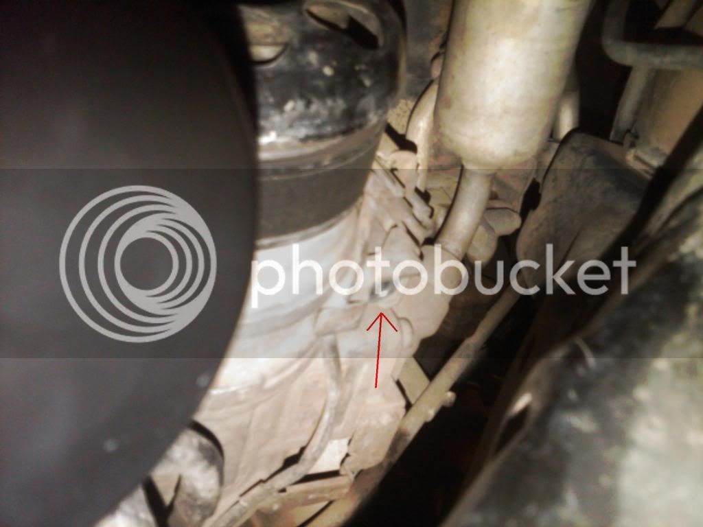

One of the three mounting bolts had backed itself out of the compressor.
The top bolt had walked its way out of the compressor and was completely gone.
I put a new one in - and all the vibrations and whining are gone. AC works again without adding load to the motor. It went from a $400 dollar repair to a $3 buck repair. Nice.
