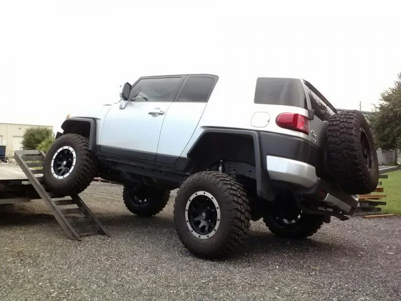

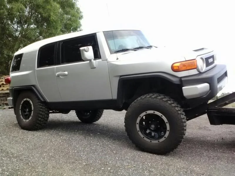

I just lifted my 07 FJ Cruiser, 6 inch Rough Country, lift installed great, rides good, very happy overall, but notice that the ABS/VSC is beeping once and activating on the faster wheel in a corner while under braking. Has anyone else had any trouble with this, also, i have 35s on it now, and no previous issues before the lift. Thanks
