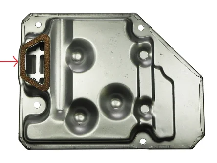

It wasn't clear; did you replace the gasket on the transmission filter with a new cork gasket before you reinstalled the filter?
Did you fiddle with any of the valve body solenoids?
If you didn't replace the filter gasket (see photo) then the transmission may suck air instead of just ATF out of the pan.
