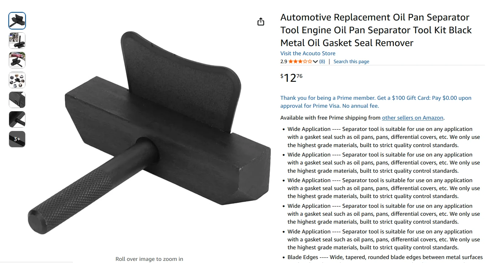

The bead breaker tool is very handy; far better than the screwdriver or putty knife. It's a little smallish for my taste, though. No need to buy the Toyota tool; it's no better than this one.
