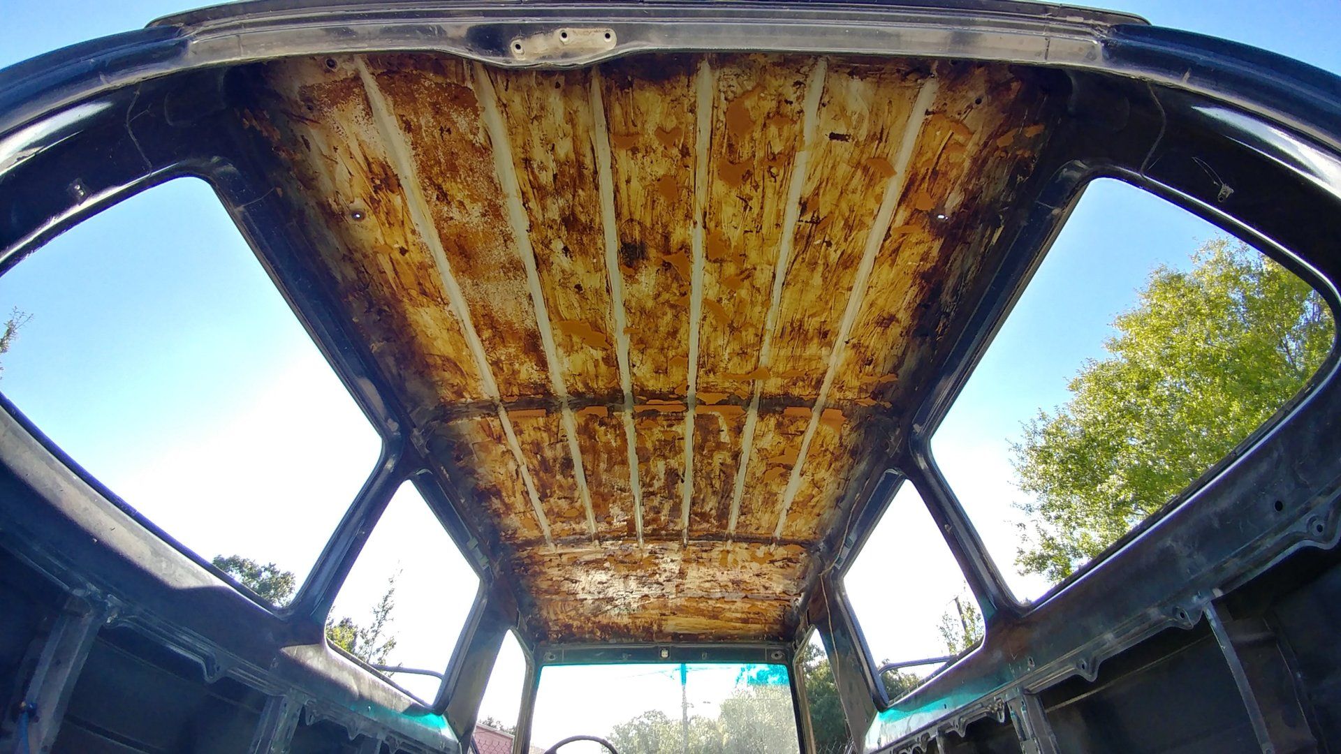

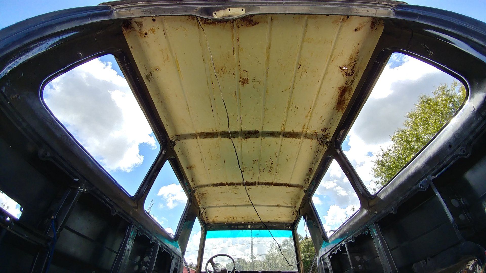

Was kind of dreading what we were going to do to remove the glue from the headliner......would not have been a fun job for the 19 year old intern. Ha.
But behold the power of the Hotsy.....and it's hot water......the glue went somewhere....not sure where but it's gone.

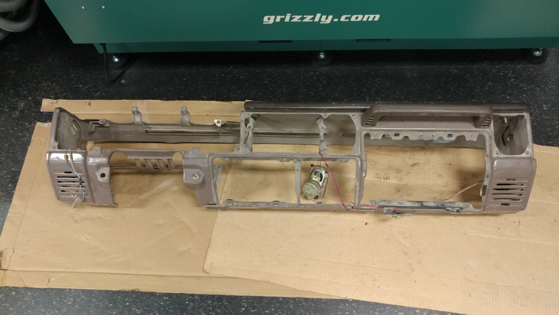

While the truck is getting body work done, we broke down the dash. It's at powdercoat. Going with a machine grey...I use it on a lot of our stuff...kind of a no-shine but not dull finish. Had to wait to get a new glove box door in so it could all get coated at the same time.
