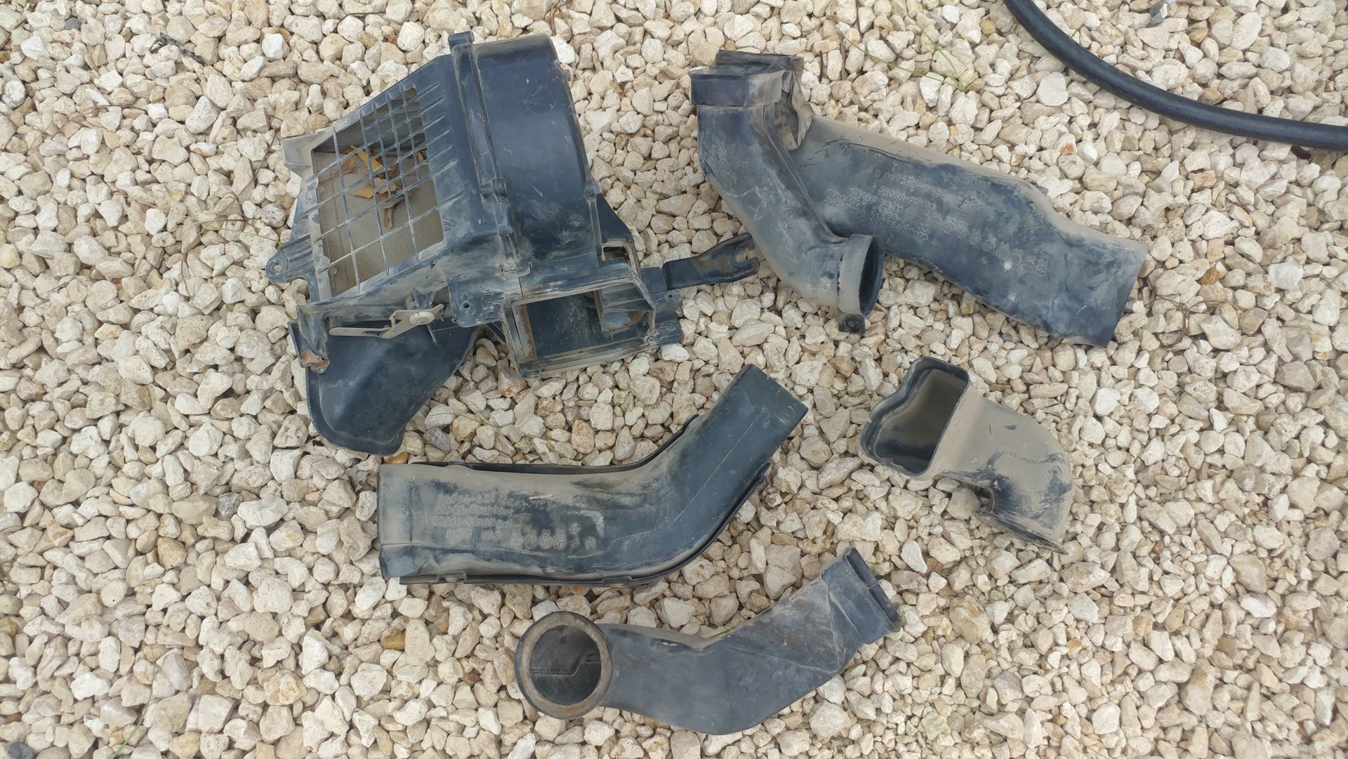

Lots of fesh-fesh in these.
Polished the clock out....looks pretty good. Pretty sure it worked.
Lots of fesh-fesh in these.View attachment 2085556
Cleans right up though... it killed me to put my AC system back together knowing that half of my ducts still look like that. But I'm trying to keep mine drive-able for now. At some point the dash will come completely apart. I know the jute insulator behind the dash has got to be caked with fesh fesh...
It's like a fesh-fesh trap back there. We'll remove ours. I think I'm going to do the usual rust treatment on the floors, sound deadener(s) and then maybe do a jute or mass loaded vinyl on the fire wall. The FZ motor is pretty quiet so not a huge amount of sound deadening needed. I think we'll do the roof too.....spray in sound deadener then the foil jute then maybe some kind of fabric headliner. No idea just yet.
Wonder if you could drag a rag thru the ducts? I think some were accessible as I recall.

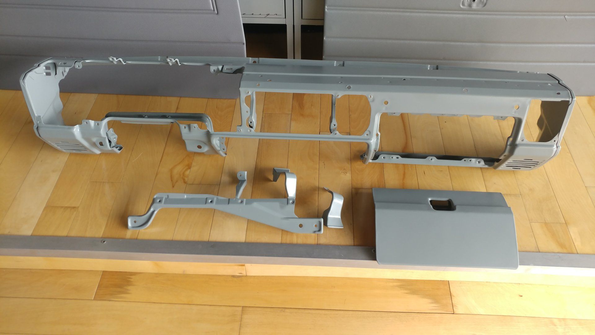

While I was playing in the TN woods with a bunch of cool people and other 70s......this stuff came back from powerdercoating. We use the color ANSI 49 for our grey.....solid industrial grey color. It's perfect for steel wheels. This was the original dash...
Hard to believe how good it turned out....like brand new.
