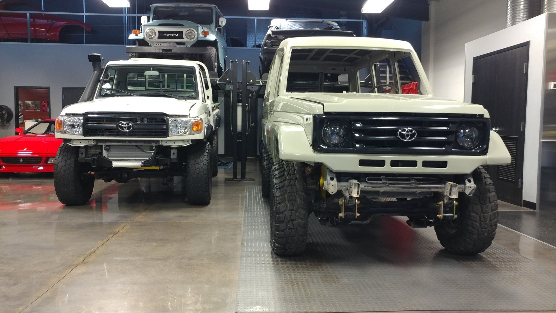

Totally forgot that we had installed some LED headlights we had leftover from an FJ40 project. Not what I typically like but they look pretty good with the new black grille we're going to use.
Troopy and 79 had a good run hanging out together for a month or so.....but we're splitting them up next week. Time to get busy on other projects.

Would you mind sharing the details of those LED Headlights please ?
No idea what the are....they look like JL Speaker lights but I don't think they are. I have another truck in the shop with JLs....let me take a look at that and see if they are the same. I think they're some kind of knockoff. JLs were super pricey the last time I bought them. $350 each I think. Maybe more.
I checked a truck we did JW Speaker LED lights in a few years back....they are identical to the ones in the Troopy....so they are JW Speakers. Nice lights.
