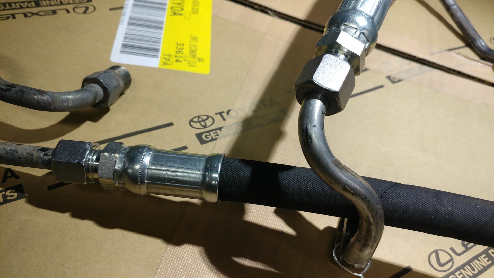

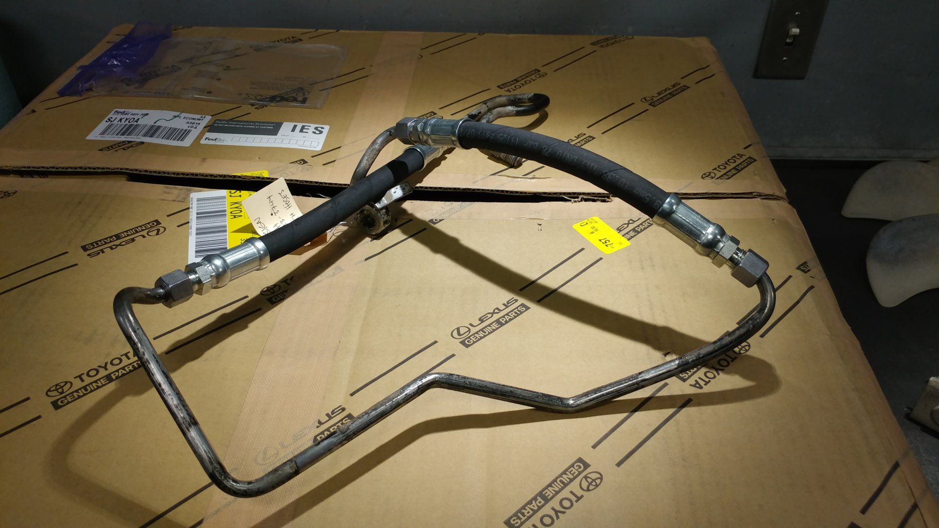

Had a leaky power steering hose.....big dollar hose too.....$380 or something. Had our local guys come up with solution which will work nicely.
