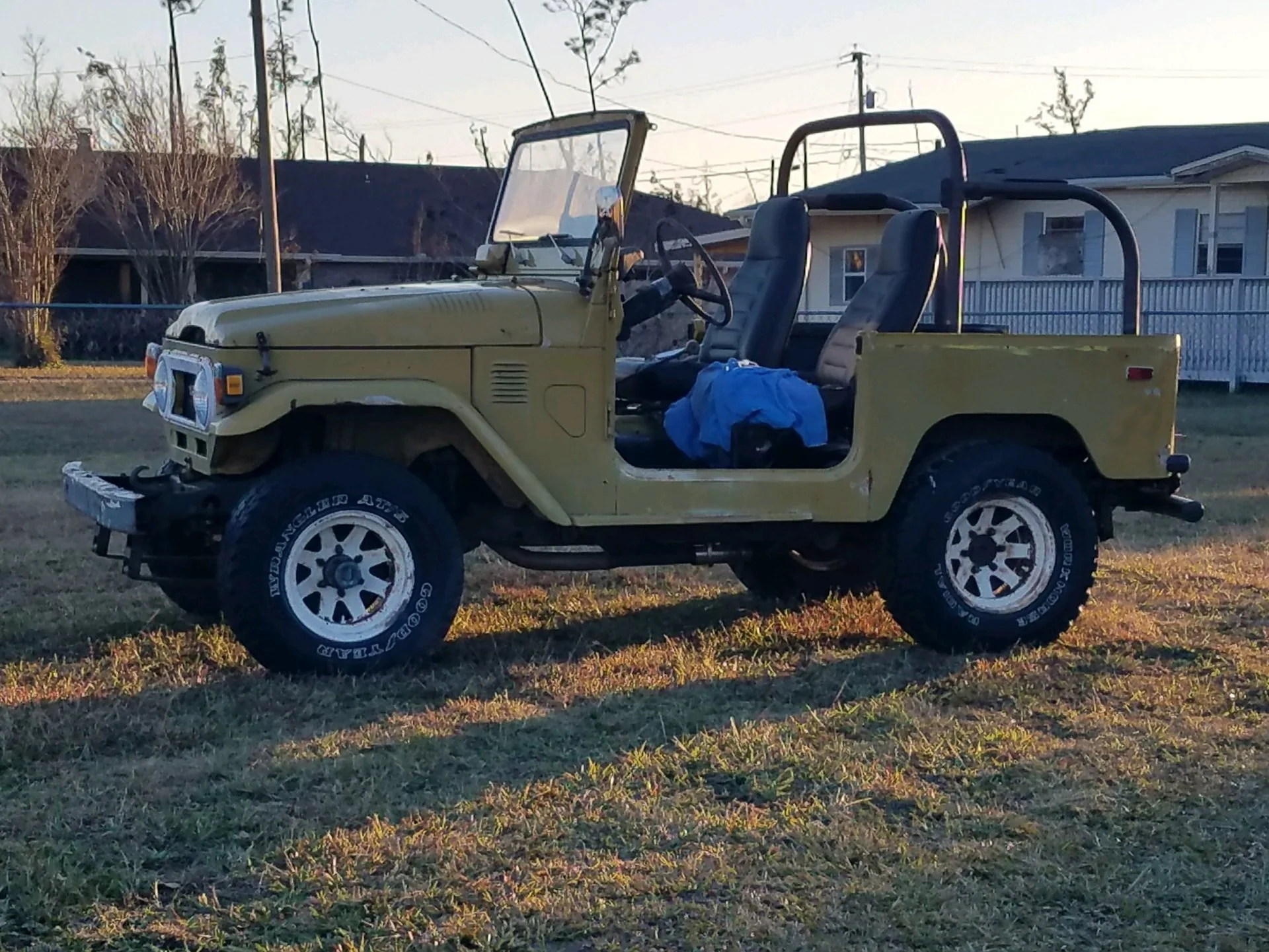

My neighbor’s FJ resto is currently rocking these old OEM wheels but I can’t find them anywhere on line, so I thought I’d toss the photo up here and see if anyone has seen these before. He thinks they are old Toyota truck wheels.
If they’re on an FJ40 they should work on my FJ62 also correct? He’s got a different wheel on the way, and has offered them to me to referb (thinking satin black powder coat) for cheap.
They look to me like the old Jackmans from the 1960's or '70s. Not Toyota wheels.
What skidplate said. I have had a couple sets of those through the years. I had to do minor grinding to the front caliper or use 1/4" wheel spacers to make them fit any of the Cruisers I had them on.
