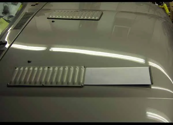

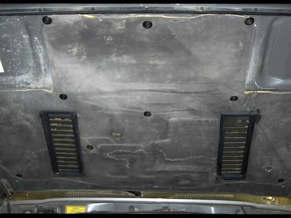

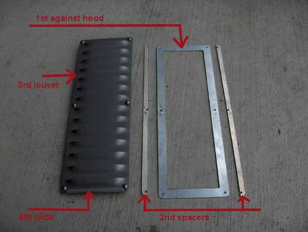

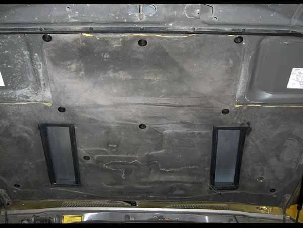

Some pictures from an old thread of a way I made to be able to close off louvers. The idea at the time in addition to blocking some water was to possibly be able to retain under hood heat for winter.
Space louver off hood

Slide to close off louver
attachment.php
Showing how slide would go in to close louver

Picture of underneath louvers closed

Louvers open with slides removed

Front picture with close off slides installed
