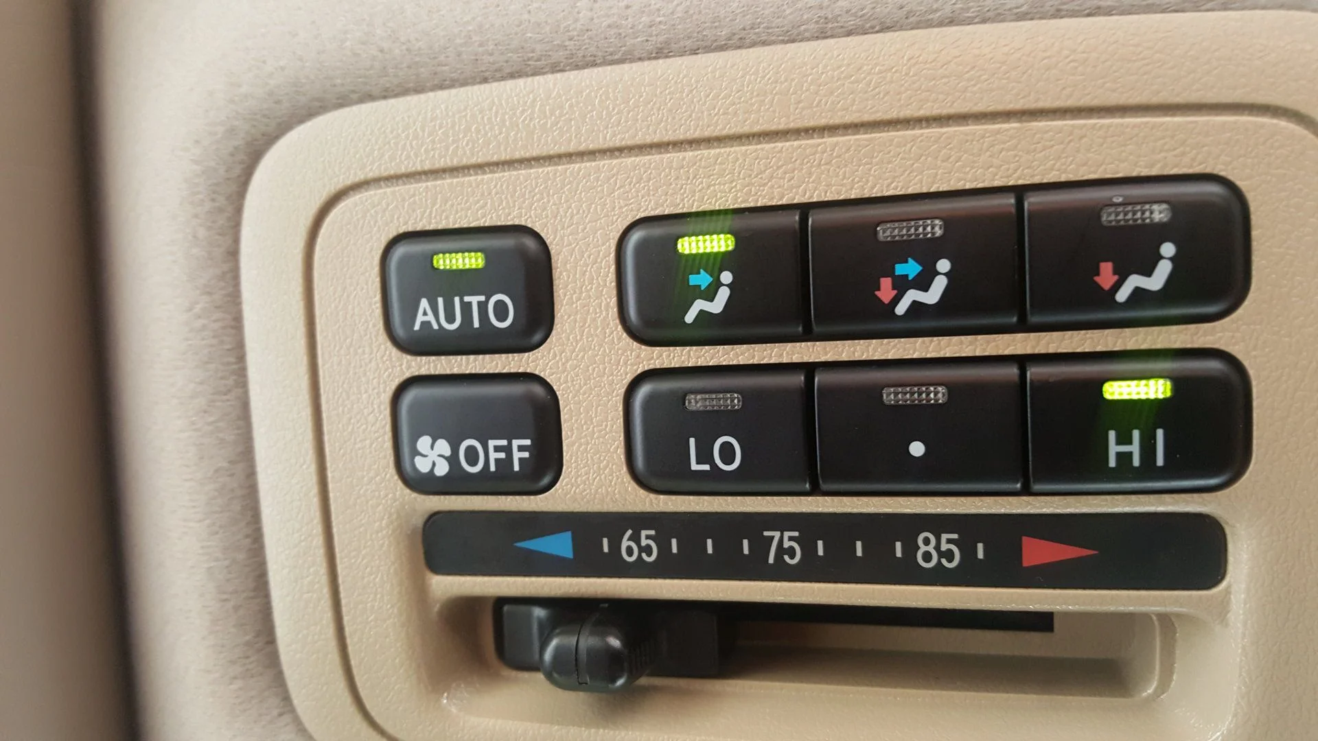

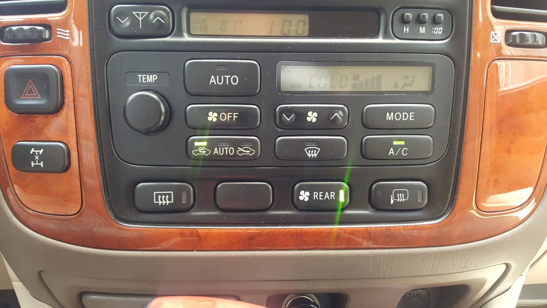

I have a 2000 LX470, front A/C blows cold however the rear ceiling vents do not, they blow slightly cooler air then air in the cab. Not really warm but not nearly as cold as the front vents. It doesn't matter whether the temp controls is switch to REAR on the front panel (meaning that the air is controlled up front) or if they are controlled by the rear controls in the ceiling behind the 2nd row and switched to cold temp, the rear air just doesn't get cold.
Thanks in advance for he help.
Here are the pics
Ceiling controls behind 2nd row

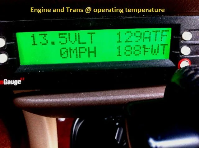

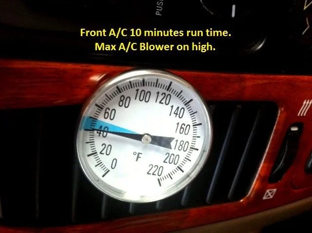

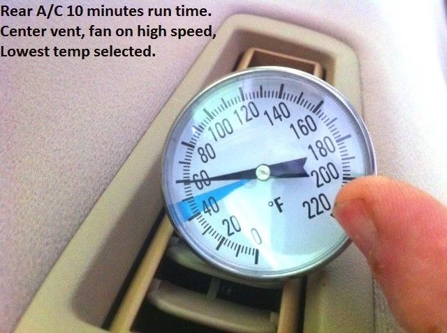

Compared my Front and Rear A/C vent temps.
Conditions:
Ambient 92° F.
Vehicle started from cold engine. Idle speed throughout.
Both A/C units turned on at same time engine was started.
Both units had fans set to high speed and lowest temp selected.
Elapsed time until readings taken: 10 minutes.
Results:
Roughly 20°F. difference in front and rear vent temps. I am confident with more run time (as interior cools off) and greater engine speed (vehicle traveling), the rear temp would come down another 5-8° F.

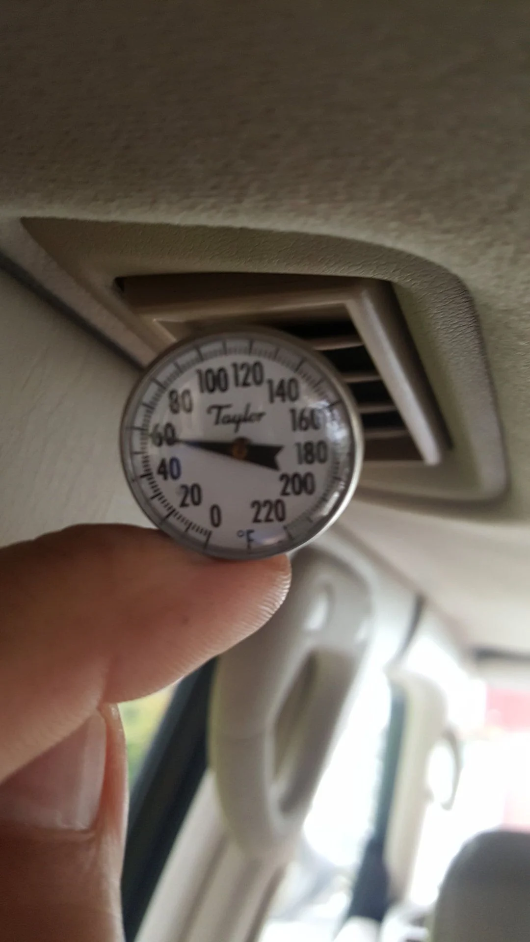

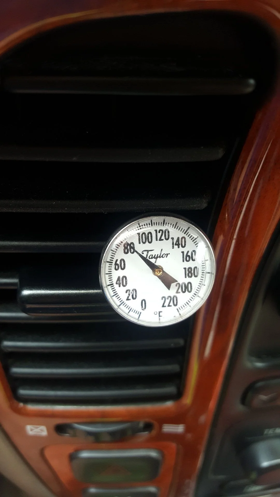

Compared my front, mid and rear vent temps.
Conditions:
Ambient 80°F
Both units had fans set to high speed and lowest temp taken: 10 mins
Results:
Ambient 80°F
Front 44°F
Mid 58°F
Rear 62°F
A 14°F difference from front to mid, a 4°F difference from mid to rear, and a 22°F difference from front to rear.
sorry the pictures are so big the post was uploaded from my phone.
I now feel it is safe to say that there is not a leak and this drop in temp from the front A/C vent temp to the mid and then rear is standard with our LC and LX470's.
Thanks to all who helped in this topic.
