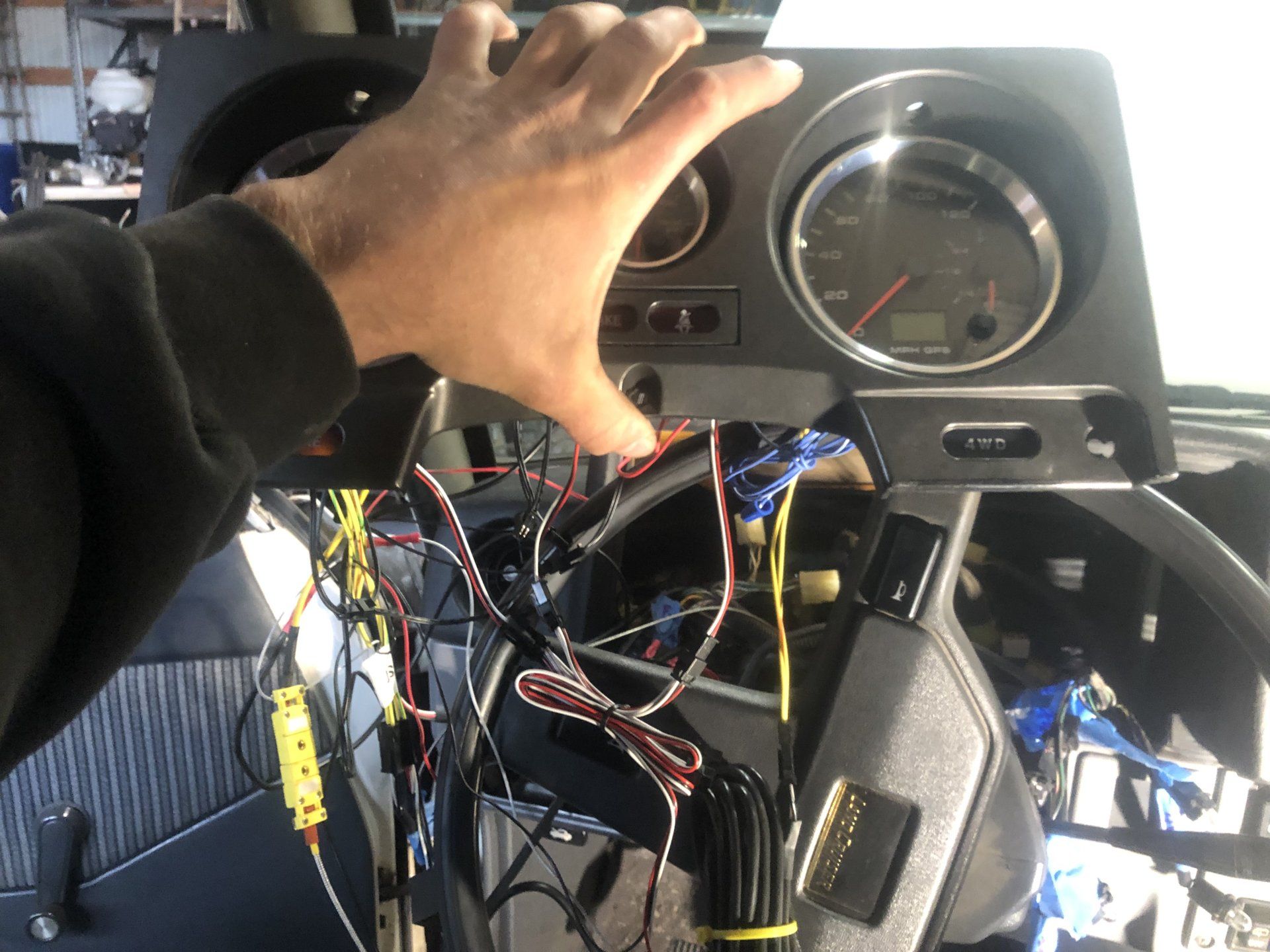

All wires and sensor leads ran in and connected to the instrument panel.
Got the water temp sensor installed in the back of the block. Tested the unit on my lap. Calibrated fuel gauge. Decided to take it for a test drive. Below is picture while on test drive.

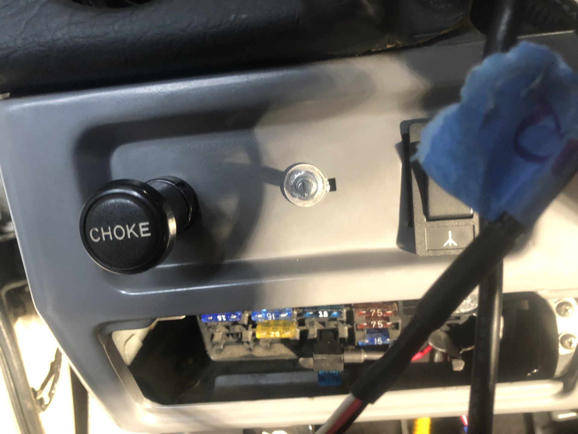

Only issue is my gauge lighting isn’t working. Adjust dial and nothing happens.
Also my water temp didn’t get any higher than about 150F. Got back to shop and opened the hood. Thermostat opened to radiator as it was hot. Wondering why my water temp didn’t get higher?
@FJ60Cam I believe I have a bad inverter...
Where did you tie in to the factory wiring for the backlighting? The dimmer switch? Do you get +12V to the inverter when you turn the headlights on?
@FJ60Cam ... and possibly my water temp sensor isn’t accurate.
Are you using the same temp sender location as before? Can you check the radiator/hose with an IR gun to see what it should be reading?
No lights with headlights on.
I should be able to check with heat gun on Monday.
Other than the backlighting not working I’m totally happy. The fuel level calibration was fairly easy and the speedometer acquired satellite and started working.
Put the dimmer switch in the factory location.

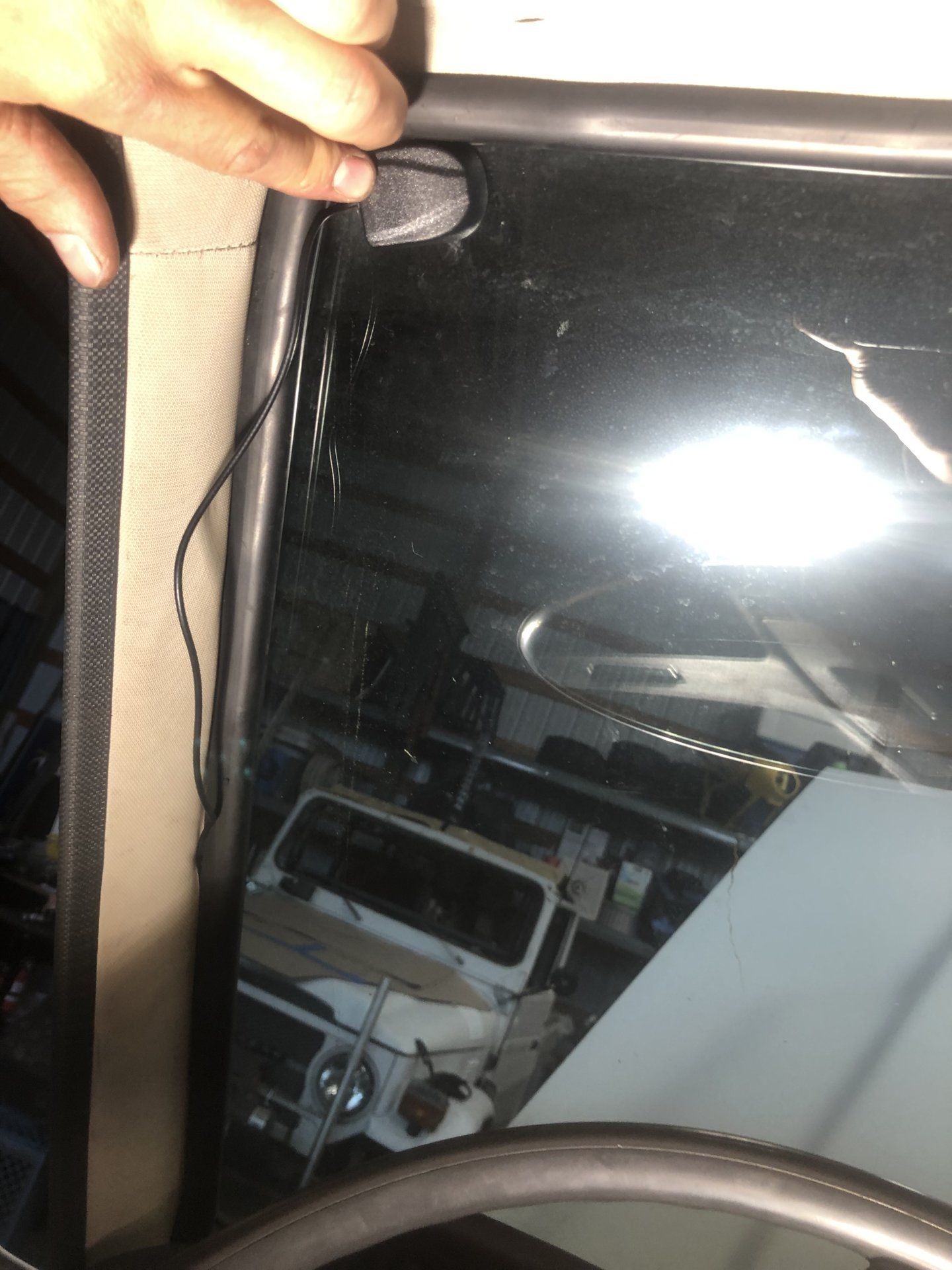

Ran the GPS speedo sensor cable inside the windshield trim molding with double sticky tape to attach to windshield. After finished could only see the GPS sensor.
