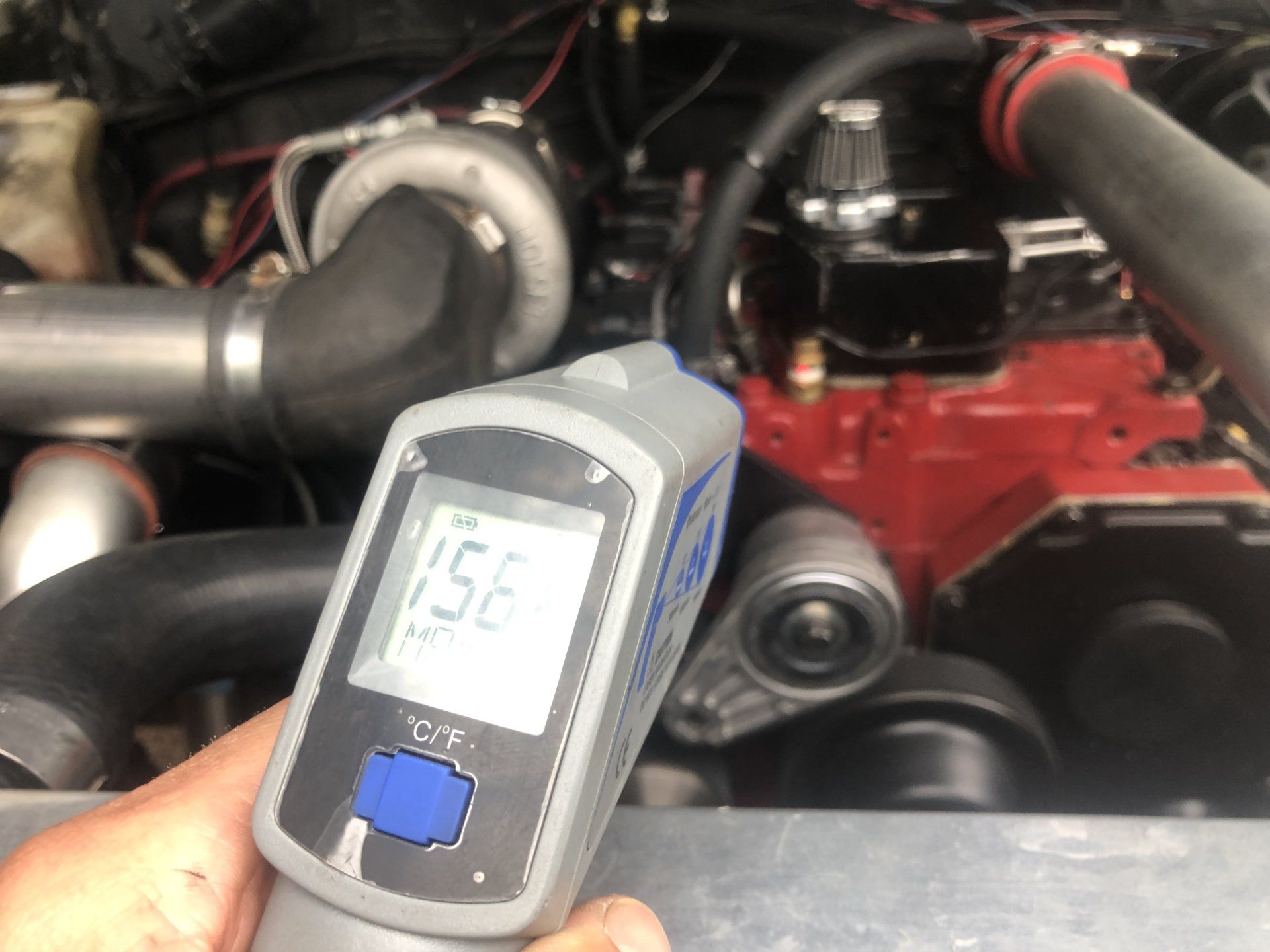

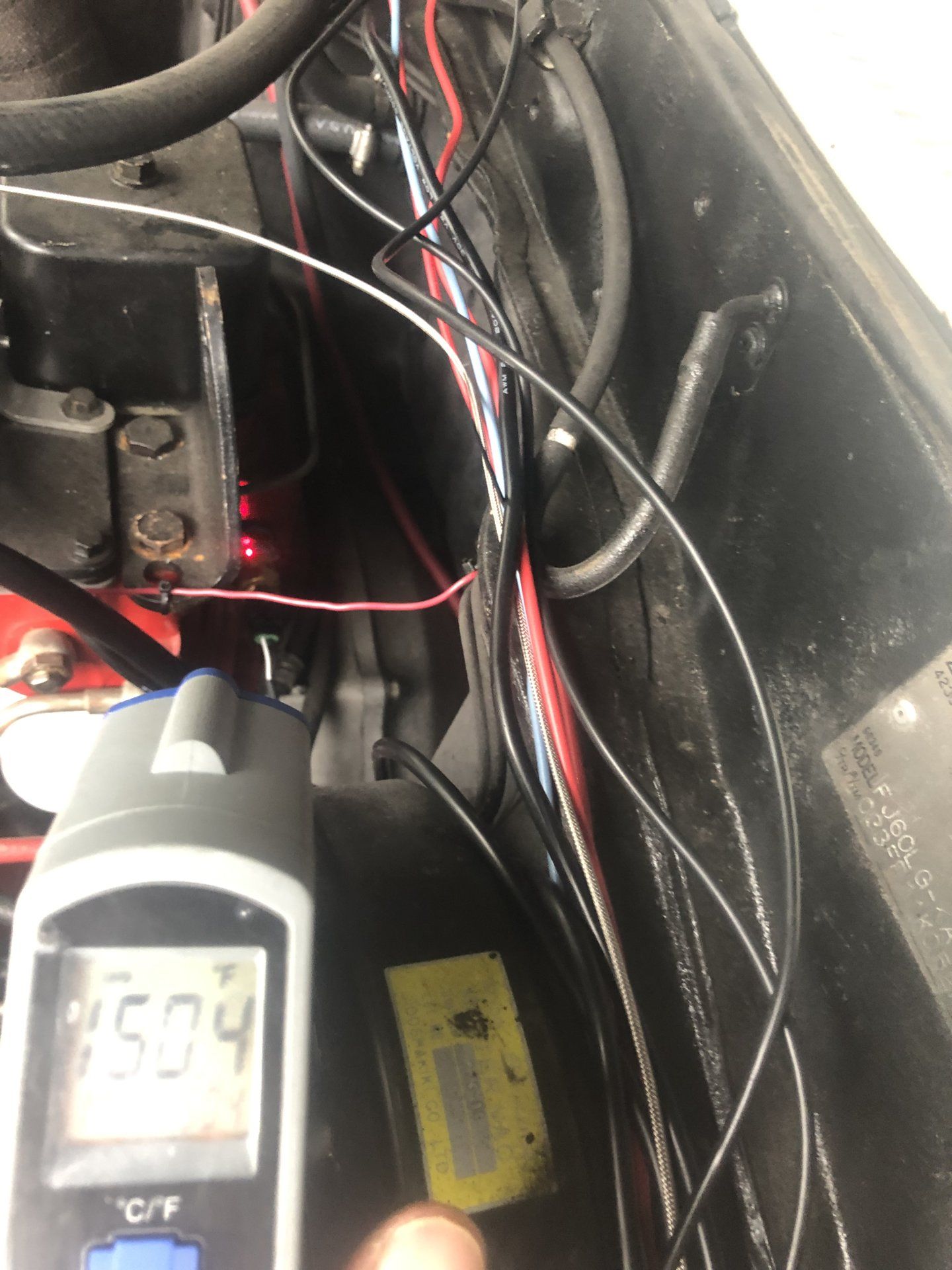

Drove it home from my buddy Brian with temp gun to check my water temp.
Temp at fan controller sensor
Temp at back of motor at the water temp sensor

With the heat gun I noticed the front of the motor runs hotter than the back. I stopped 3 times on the way back to check temp and the front was always 5-10F hotter.
Got home and let 60 idle. Water temp got up to 180F by time I climbed up 1,000’ in elevation from Eagle Fern Park. The fans didn’t come on at all. Let the 60 idle and temp climbed to about 205F and still no fans. Time to play with the Derale fan controller. Turned off 60 and slowly backed off on the temp screw. The first fan came on and ran. May need to adjust but it came on at about 180F.

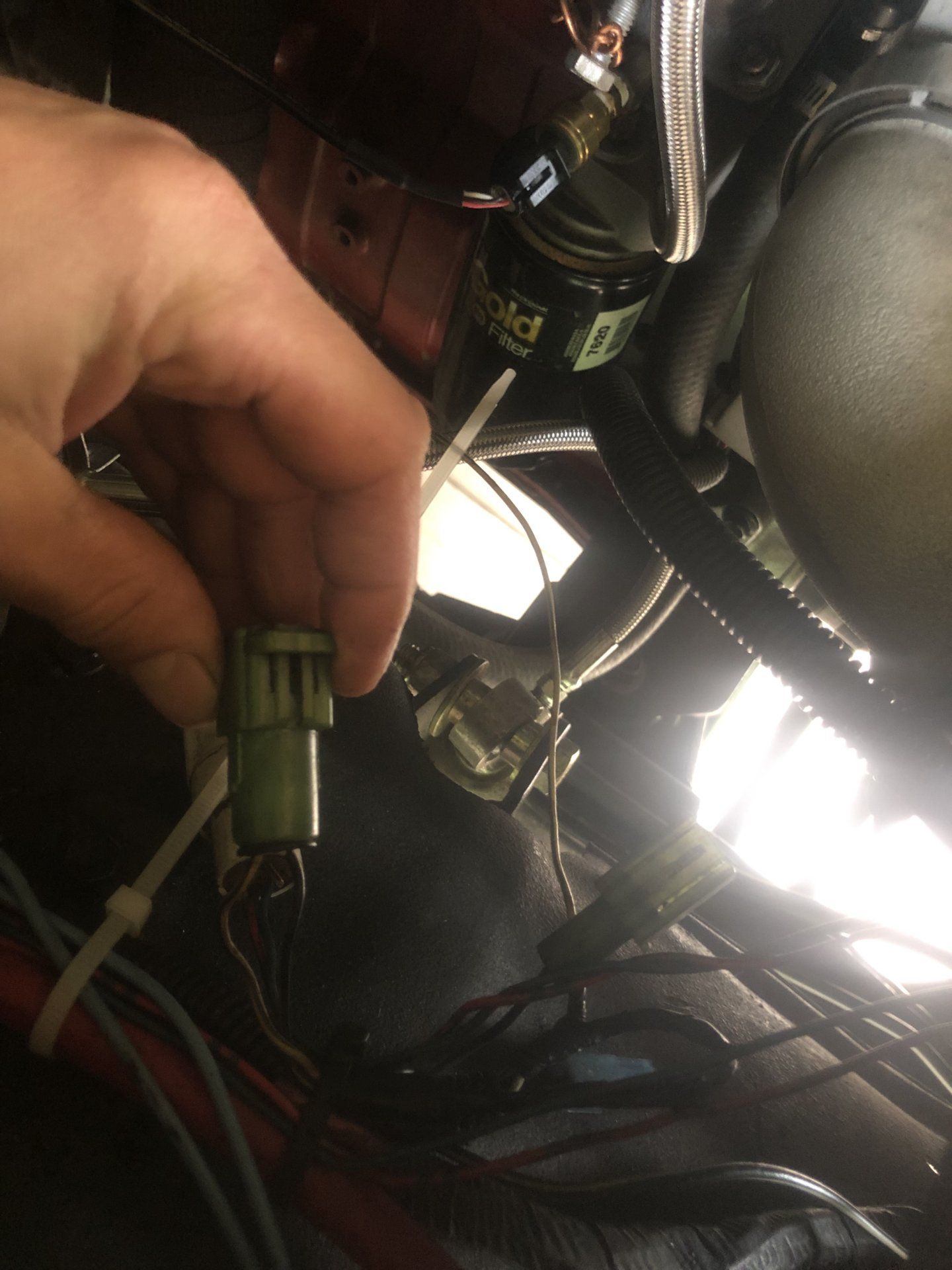

My 4WD lamp won’t light up in the instrument panel. Bulbs are good. Under the 60 on the t-case is I believe the switch that turns the light on when put into 4WD.
The wires got cut somewhere along the swap. Does the switch unthread from the case?
I also found the same colored wires from the lamp in engine bay on the passenger side. Are these the ones that go to the 4WD switch on the T-case?
Yes the switch unthreads from the case i can get a pic tomorrow of the reverse light and 4wd light plug both are in the same pigtail

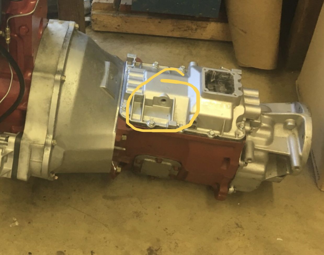

The reverse light wiring is along with it do your reverse lights work i know the nv4500 has its own reverse light switch on it
The reverse switch looks like it’s this port from what I can tell. Felt like there’s threads in there.
