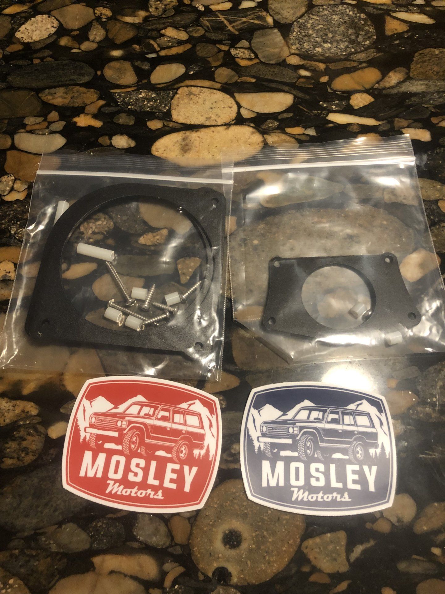

Can’t wait for the new Speedhut gauges to be in. Just waiting for the mounting plate from @FJ60Cam. Then I’ll have actual temperatures to go by. The single fan ran off the kill switch in the 60 as a manual on switch ran great.
@FJ60Cam just sent me picture of the Speedhut gauges mounting plates

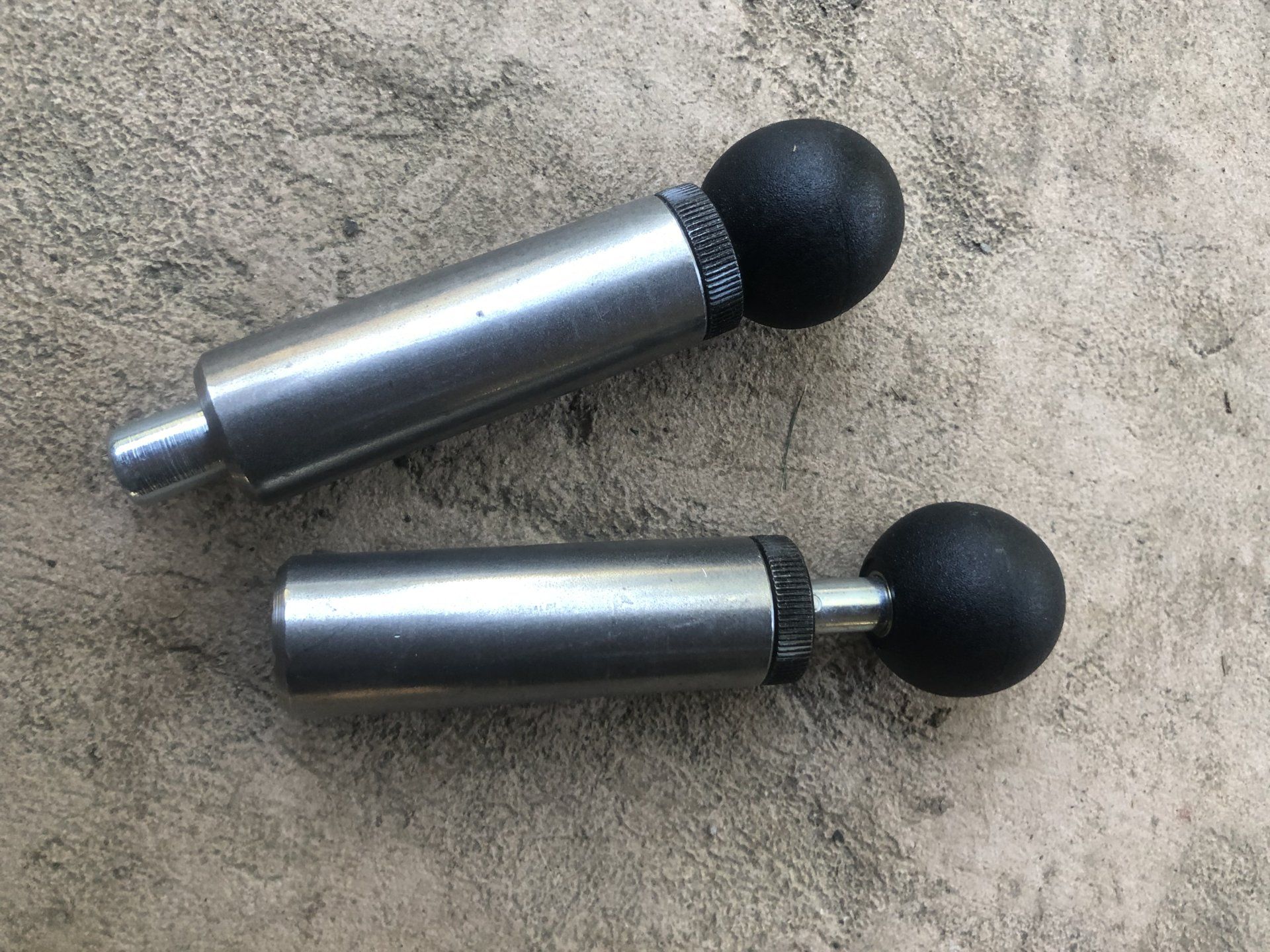

Just ordered my Ruffstuff spindles and swing out latches. They were not on their Easter Sale but Dana gave me the 17% off sale anyhow. Ruffstuff Specially rocks:bounce::bounce2:
I need to get some of these for my trailer. Thanks for the reminder.
Edit -I meant those chain hangers you got. I need some of those for my Hilux trailer
How do you like the shifter being that long? On the 80 I have it cut down a bit but on the 75 it's long at the moment until I drive it to see how I like it.

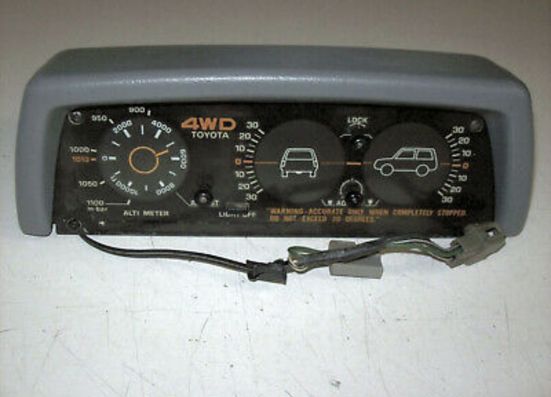

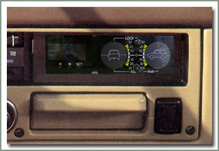

Putting in the new gauges and I now longing for a Inclinometer which came in the 4Runner. Have no idea why it didn’t come in the 60? One of these would be awesome on the dash.
Wish I pulled mine when I sold it.
I thought they did come in the 60 in the lower part of the dash? I have seen a few that have them. If not @joekatana has some from 70 series pod like the 4Runner in the classified section at the moment.
I think some 60’s had them on the roof actually ...... or am I mixing things up now ?
Looks like it doesnt have altimeter. Instead it has the clock.

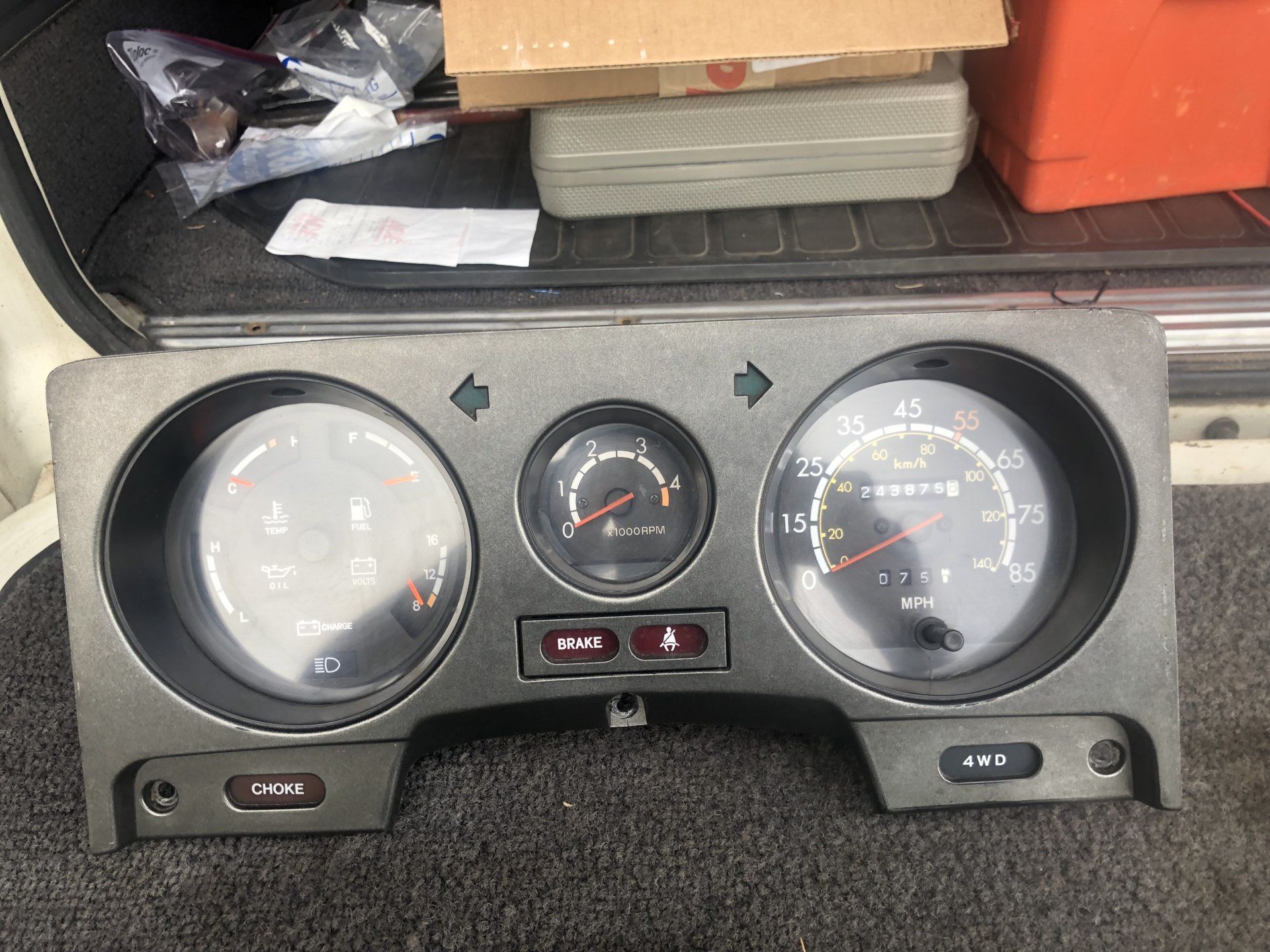

I got the instrument panel out and pulled sensor wires into the cab. Installed the oil pressure sensor. The Derale fan sensor bushing was a PITA. The sensor was 3/8” NPT but was straight thread. The bushing in the block was 3/8” x 1/2”. The sensor only went in one thread. I got the water temp sensor and it went in a good 4 threads. Frustrated I went to ACE hardware and got a new bushing and tried to thread fan sensor bushing into several new ones. It was still tight at one thread. They had a 3/8” die and the older dude took me into the back room and we chased the threads. Got the die to take material off the starting threads. Ran it on the bushing and it went on about 3 threads. Went back to Brian’s and tried it on the existing bushing. Went in a lot better. Put on some thread tape and tightened in nicely. Stupid hour delay.
