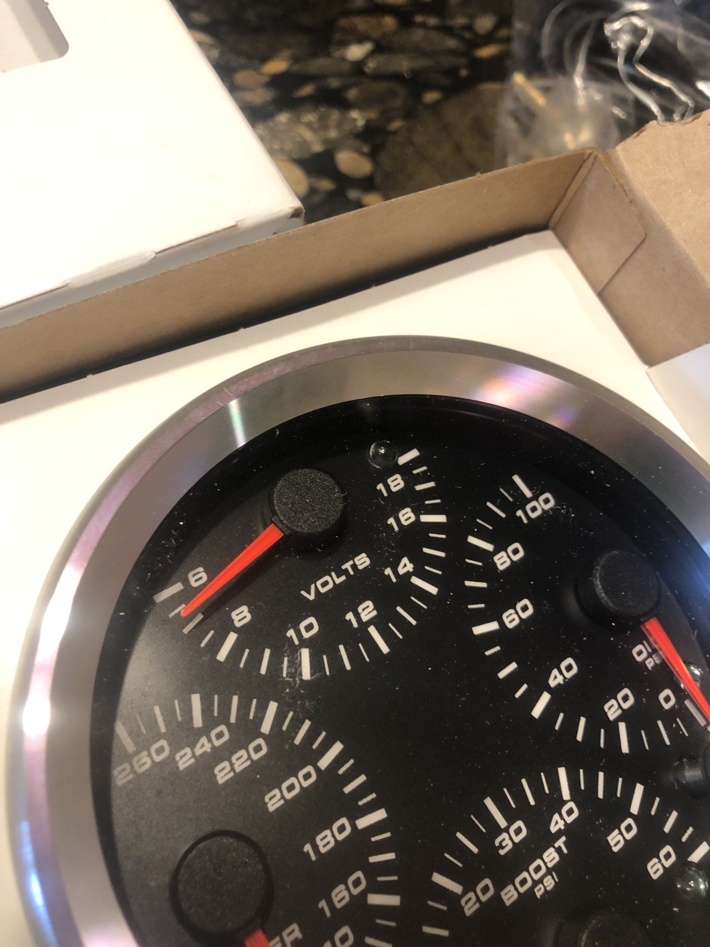

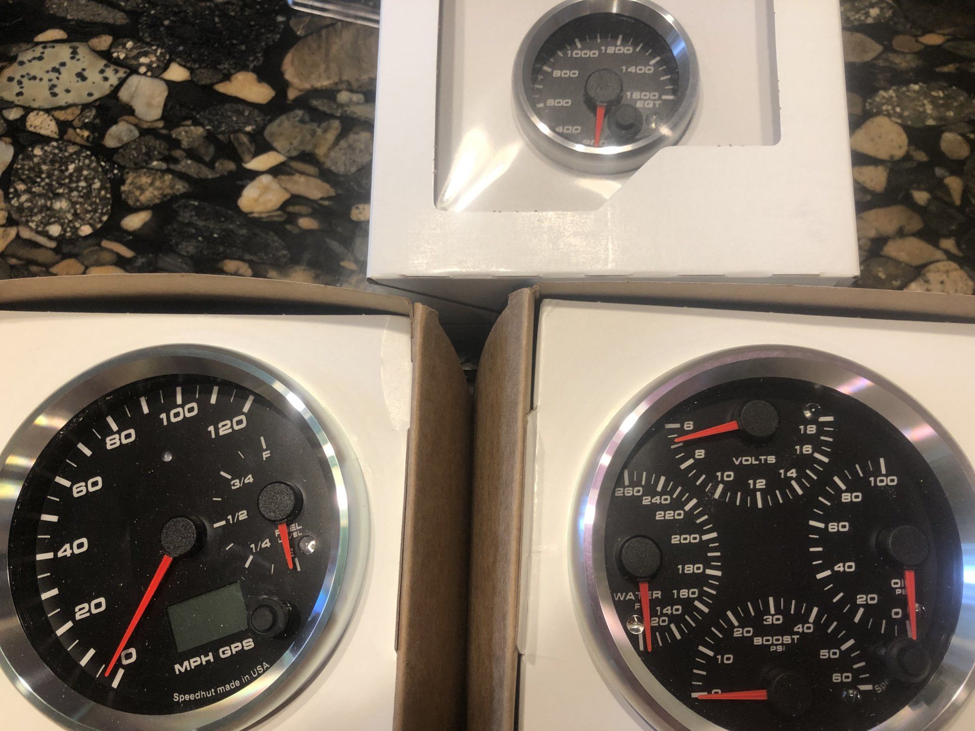

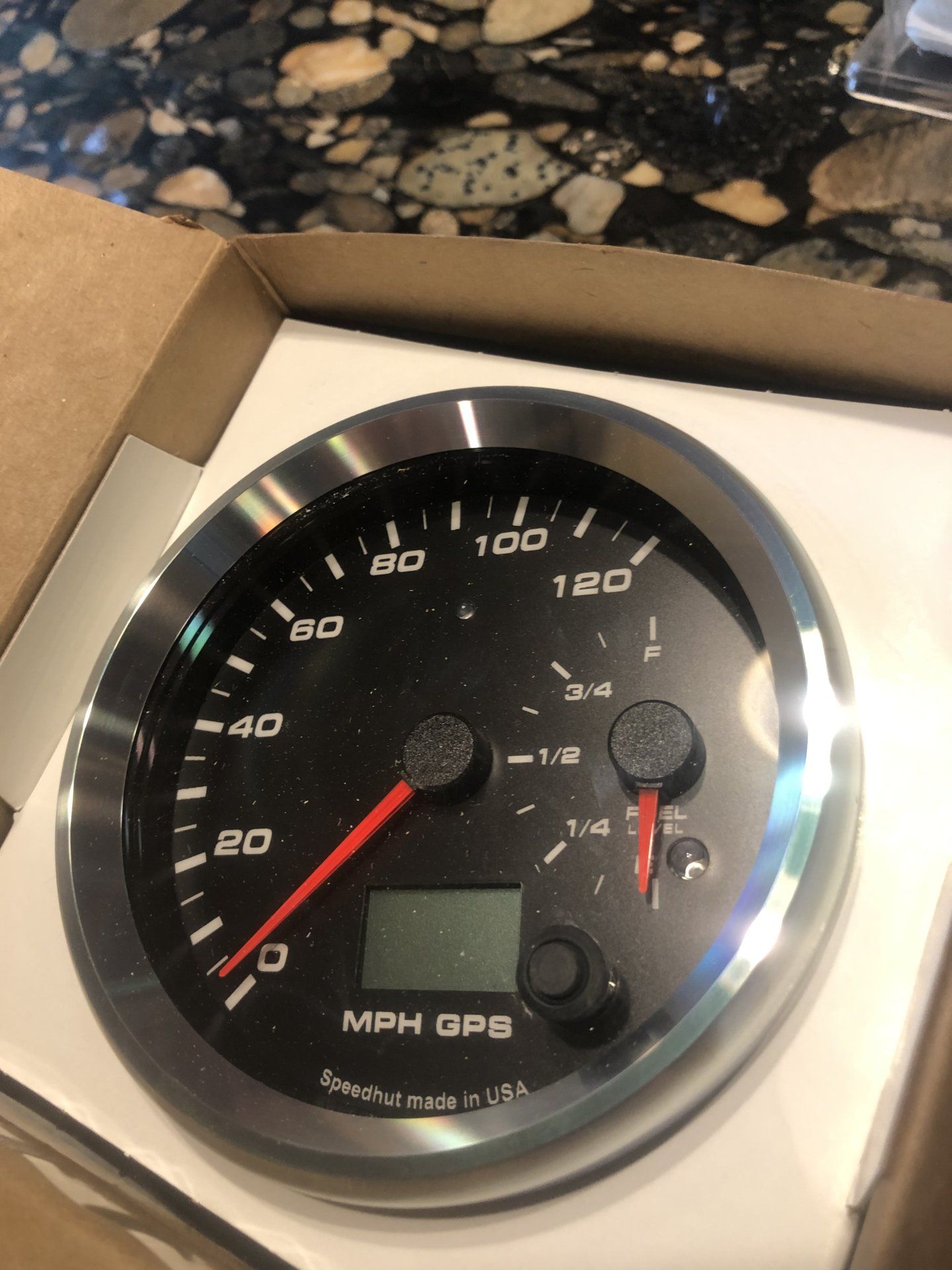

Got my Speedhut gauges yesterday from @FJ60Cam, thanks.
The volts is not bottomed out. Was wondering if the new gauge is bad or just stuck. Don’t want to install it and it has an issue.
Can you try to hook up 12V from a battery just to the voltmeter leads with some jumper wires? That would tell you if it's accurate.
I am excited to see what you are boosting at once that part it installed.
Yeah. I hit up Cam yesterday just to see what Speedhut thought.

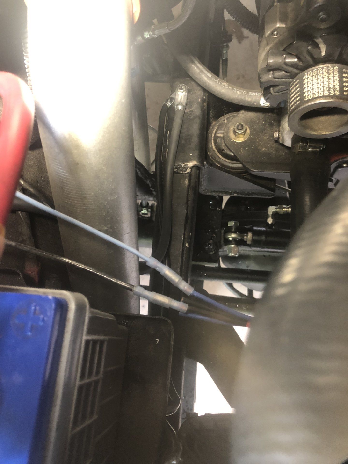

Mounted the dual Maradyne fans this morning. The fan holes didn’t quite match the Champion radiator mounting holes so I had to make them oblong. The bottom of fan shroud makes contact with the radiator but the top has about a half inch gap.

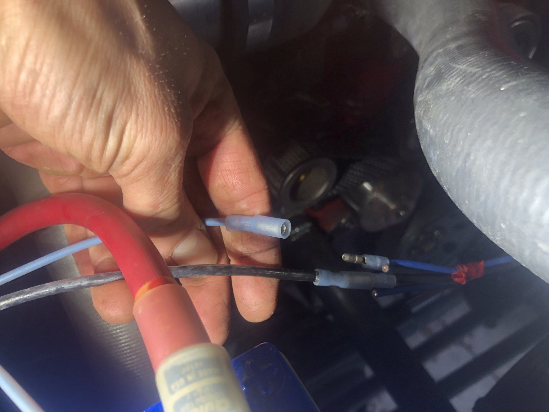

With the fans in I decided I wanted to drive the 60 and see how well they work. Decided to wire only one in to test. Had these insulated male and female butt connectors.

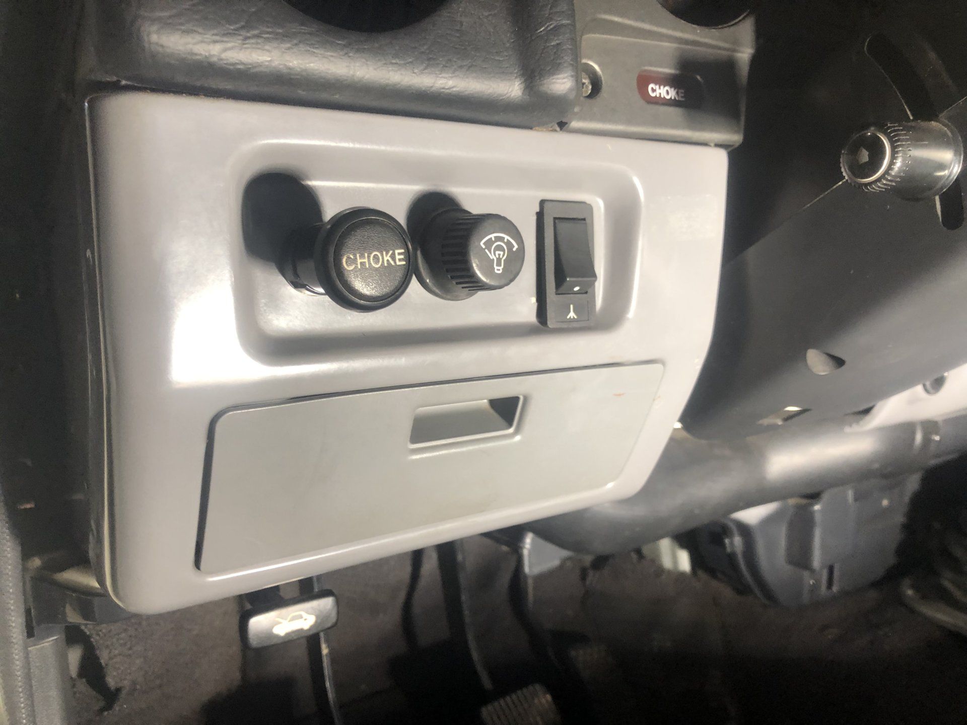

I thought with these it’s easy to have a manual switch setup Incase the controller ever quits. Ran wires into the cab and used the kill switch as a manual fan controller.
Up is off for fan and down is on. Now test drive time.

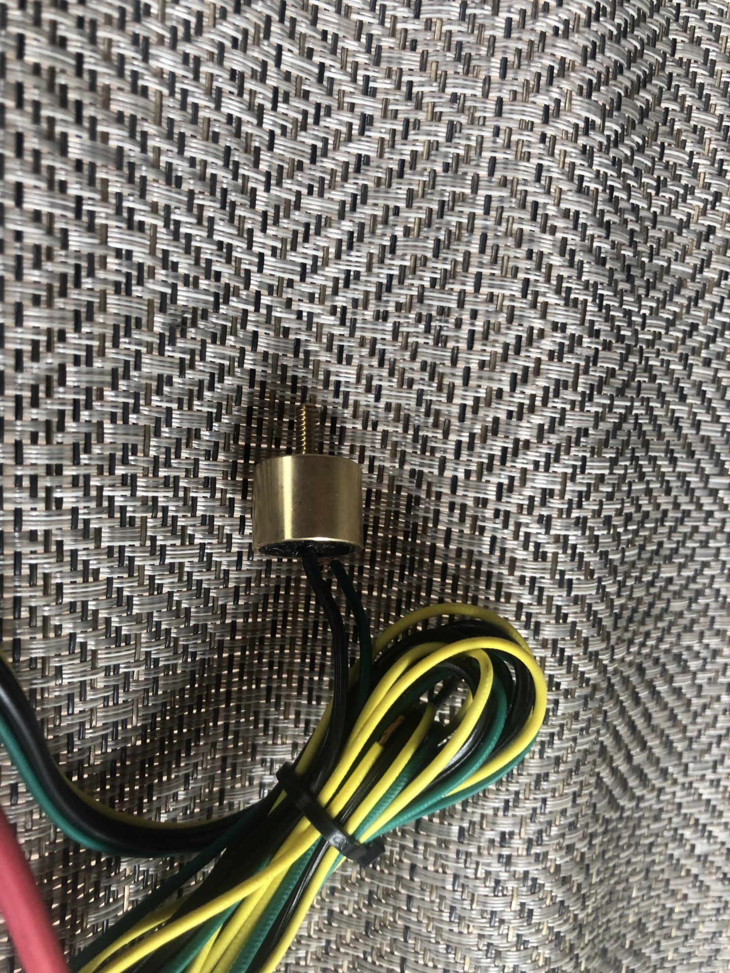

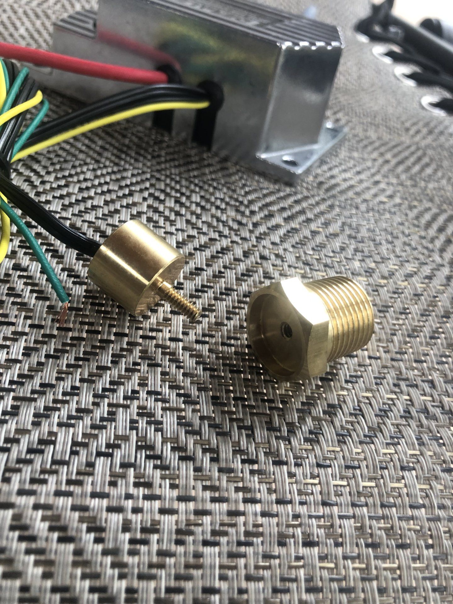

Started working on the Derale dual fan controller
The probe screws into the brass bushing into the block. It’s hard wired to the controller. In order to install it I was to cut the wire so I can screw the probe in. Should I phase the wire or does it not matter? If nobody knows I’ll call CPP diesel. Sucks they don’t have a screw in terminal. Also wondering if cutting the wire will effect its accuracy.
The unit has an ignition wire but doesn’t really say what it should go to. Anything that has 12V when the ignition is turned on and motor is running?

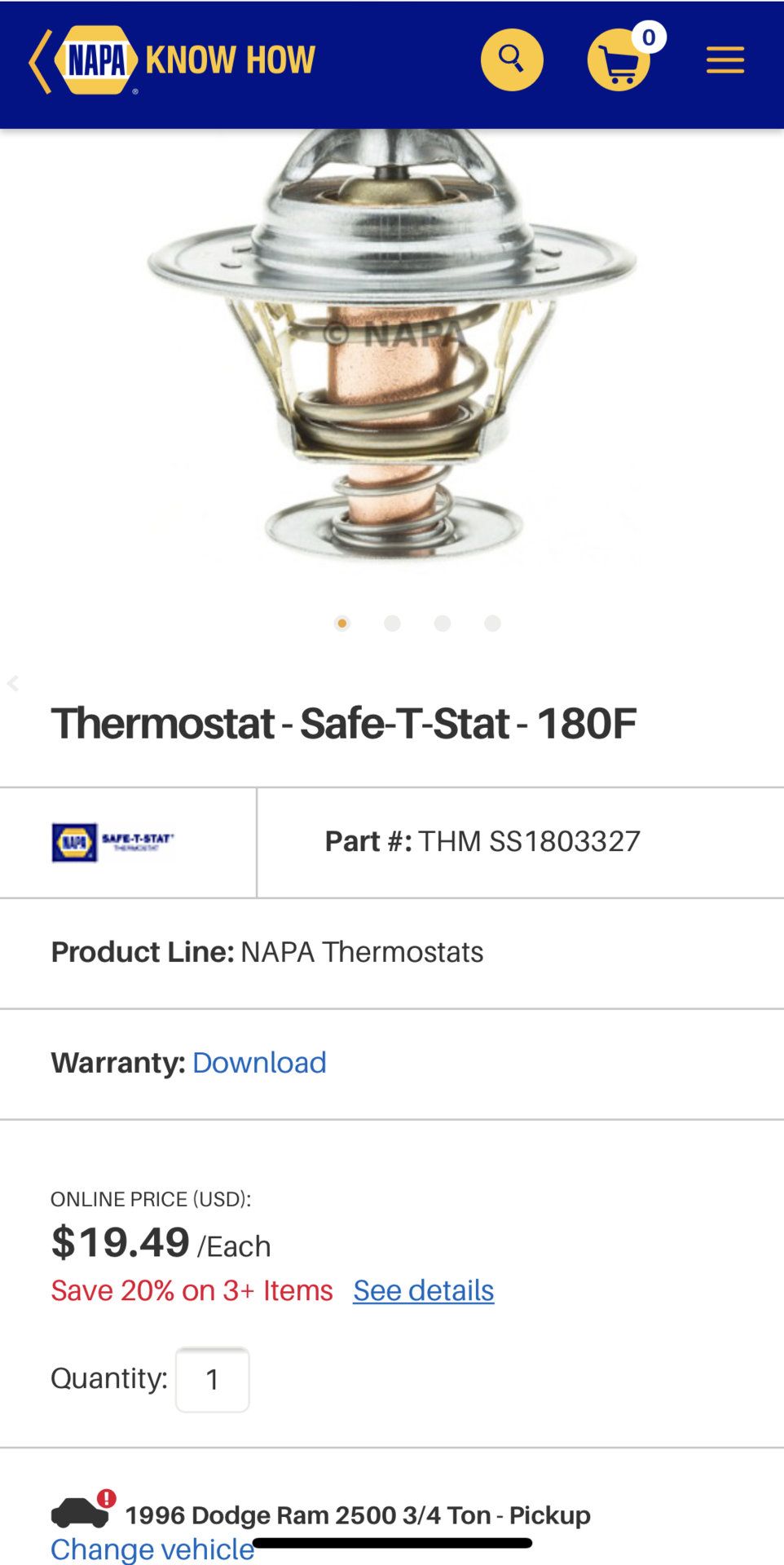

On Saturday while running the 60 I watched the water temp gauge closely. Drove to my friend Glen’s house about 5 miles away and temp stayed mid range on the 60 gauge. The thermostat didn’t even open as the radiator was still cold. Drove up to the top of my loop and climbed 500’ in elevation and it ran high but not hot while running a single fan with the manual switch I installed.
Drove on the logging roads just fine with it staying 3/4 up on the gauge. While coming down the grade temp lowered.
Pulled over at a spot and looked for elk about a few minutes leaving the 60 idling. Took off and gauge immediately shot up to hot. Backed off on throttle and it jumped down quick. Was able to get home with no problem. Water temp stayed in the mid range.
I’m thinking I’ve got a thermostat issue. Any thoughts. New Speedhut gauges are coming next.

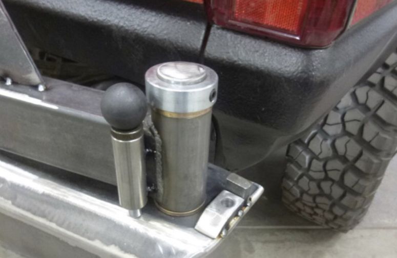

Starting my rear tire carrier build soon.
Ordered my pop-pins from Trail Tailor.
