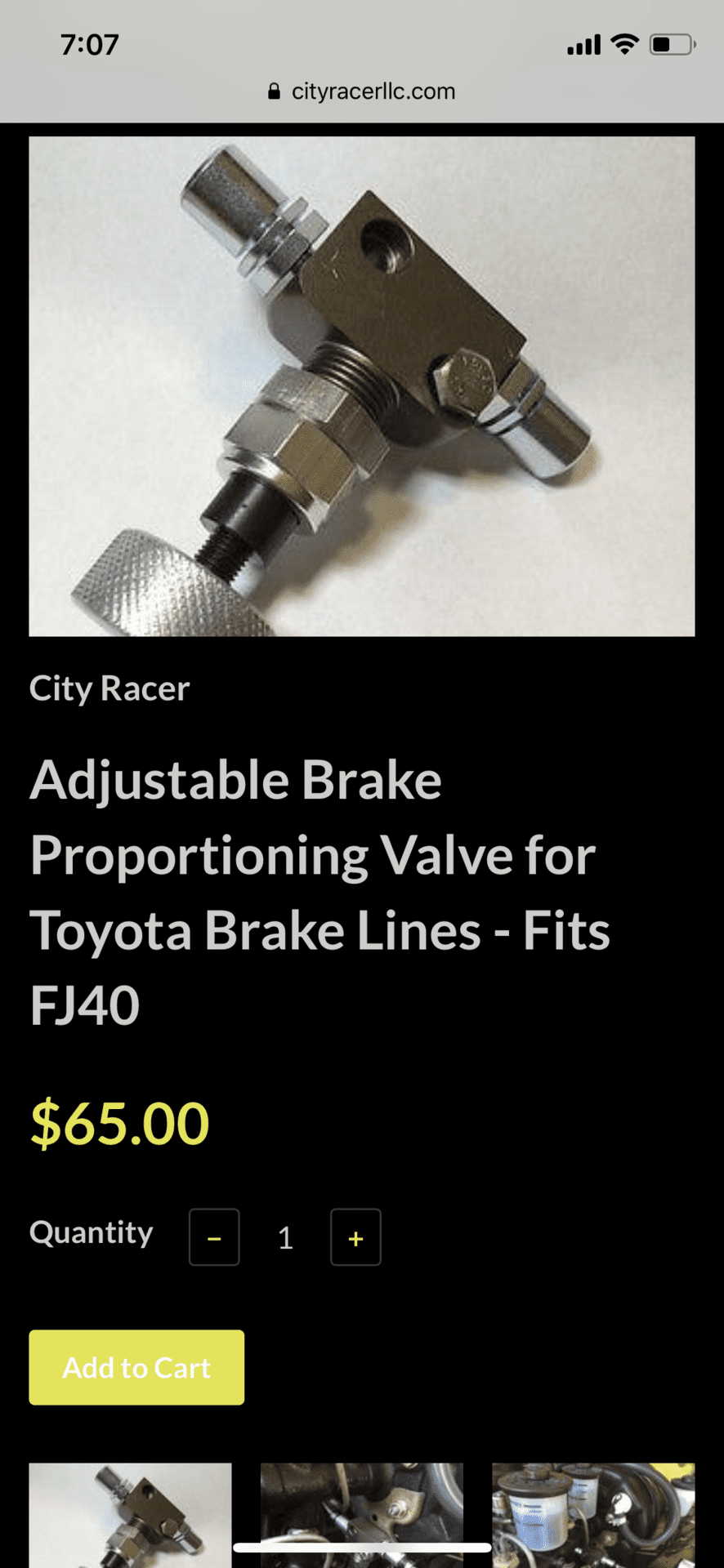

No, the adjustable valve goes in the rear brake circuit and cuts off a percentage of fluid flow to the rear brakes.
I wouldn’t run the factory 60 valve with the rear discs. You want to be able to adjust it.
Yes
There is this one which looks non adjustable.
Or this one which only says FJ40.
@Racer65 says the FJ40 one is two port for rear brakes only. Isn’t this what I want?
Yep. Looks like a nice piece too.
