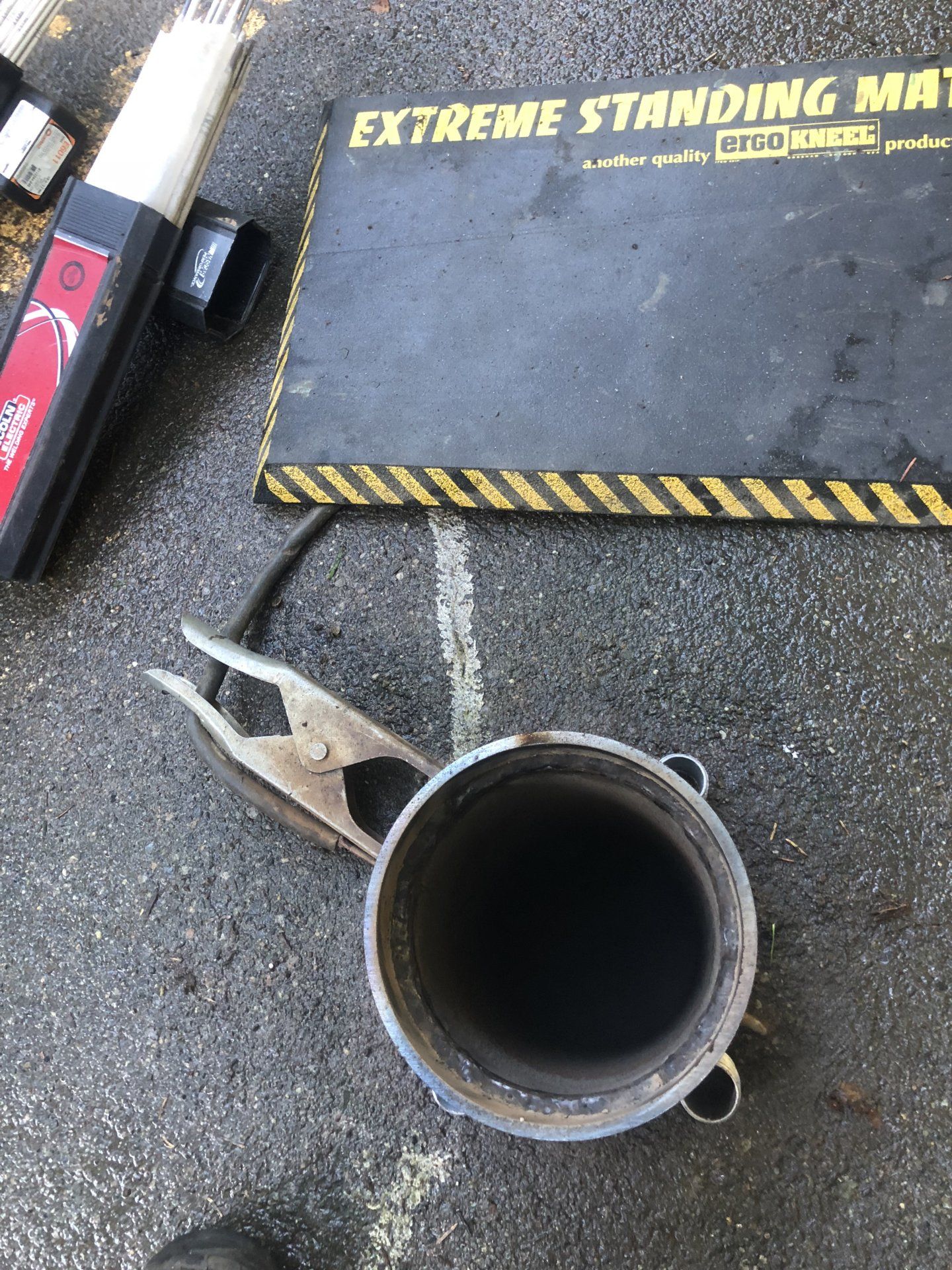

Worked today for the Oregon Department of Forestry at Spruce Run Campground on the Nehalem River. Job was to replace an aging hand pump for the well and install a submersible pump. The Ranger mentioned Cascade Cruiser group camping at the campground. When I had some time I wandered over to meet them. All the rigs were newer and not all were cruisers. Not one 60:(. I chatted a bit then went back to work. The 6” steel well casing was too low to the concrete pad potentially causing contamination so I welded on a foot of new well casing.
Installed the submersible and hand pump in the same well.
