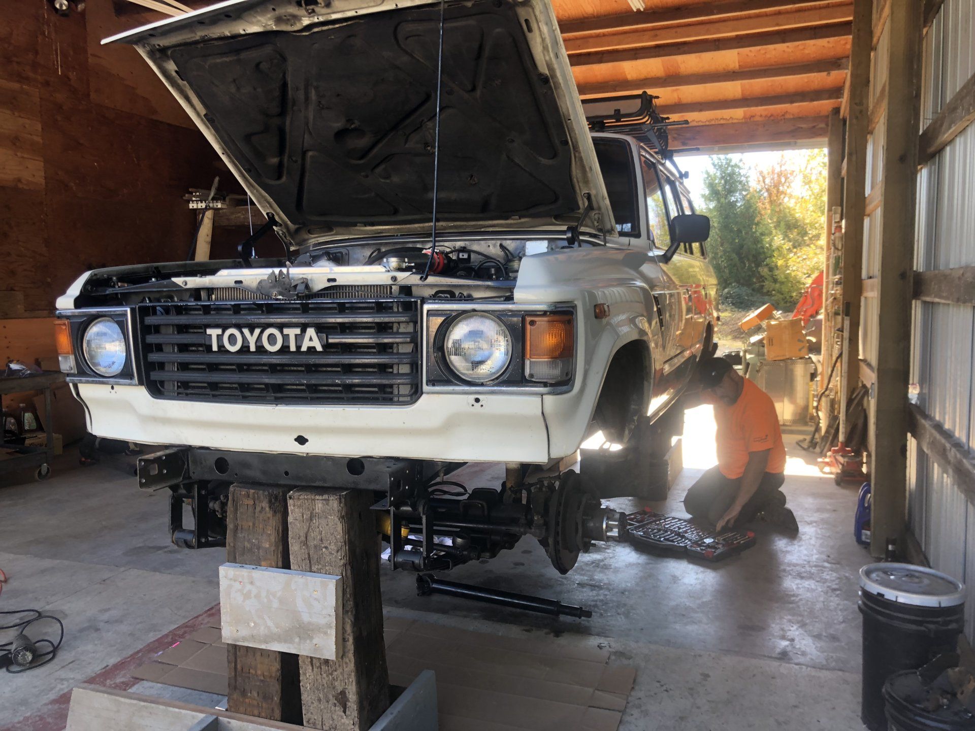

A great day with Mike, Matt and Jeremy. Lifted the 60 off the ground with forklift. Blocked and stabilized the cruiser with timbers in the rear and front.

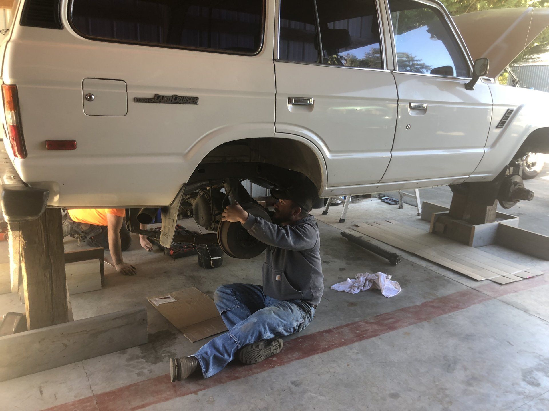

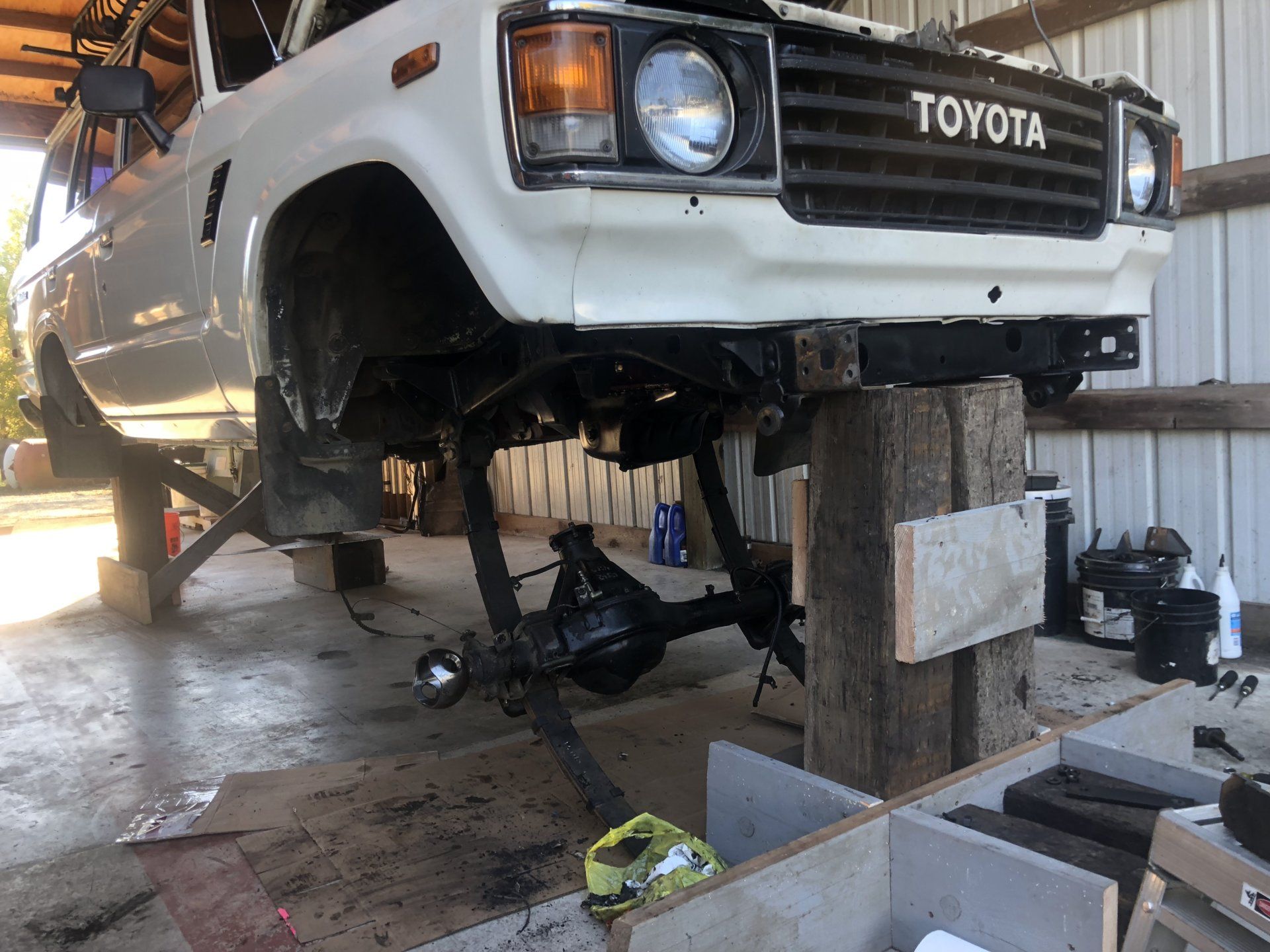

Hojack lowering the front axle with floor jack. Kept the rear end of the spring attached so it swing down making the axle easier to remove.
I thought I took more pictures but that gets in the way of progress. Plus my hands were so covered in grease and oil pictures weren’t on my mind. We mocked up and tack welded the passenger side rear hanger. Welded the front shackle hanger. Decided 4” would be the best length for the front shackle length.

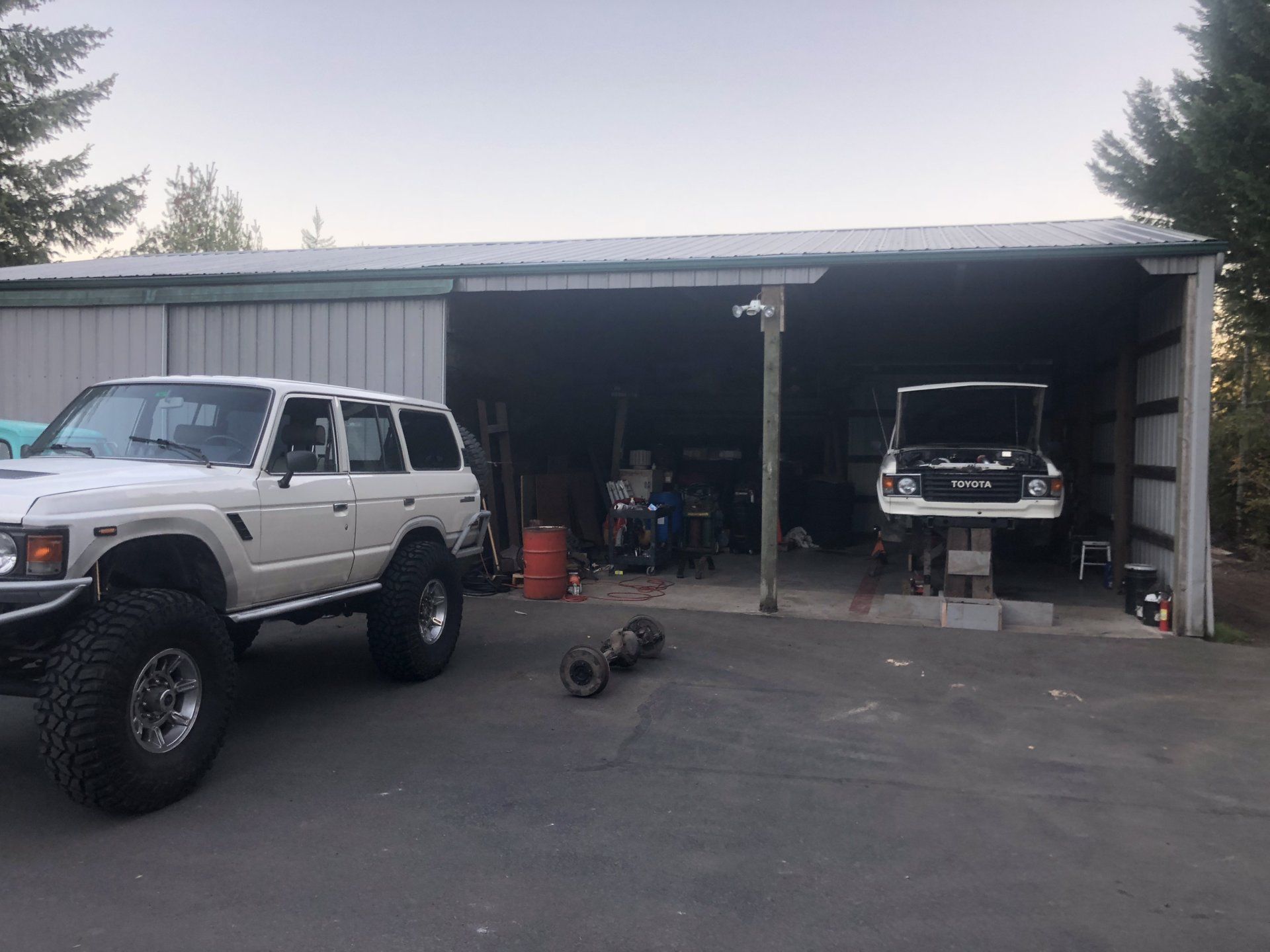

End of day picture of mine and Mikes cruiser. Really appreciate all the first hand knowledge and great day of hard work on the 60. :clap:

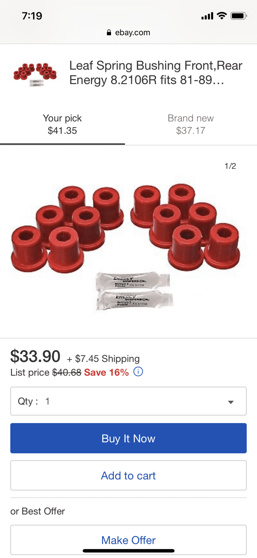

Bushings for rear FJ60 and Chevy 63s

FJ60 spring poly bushings

Looking at the Chevy 63 bushing kit and there is 2 based off years. Unknown what year mine are from so I’ll have to measure or see if there is anything on the spring.

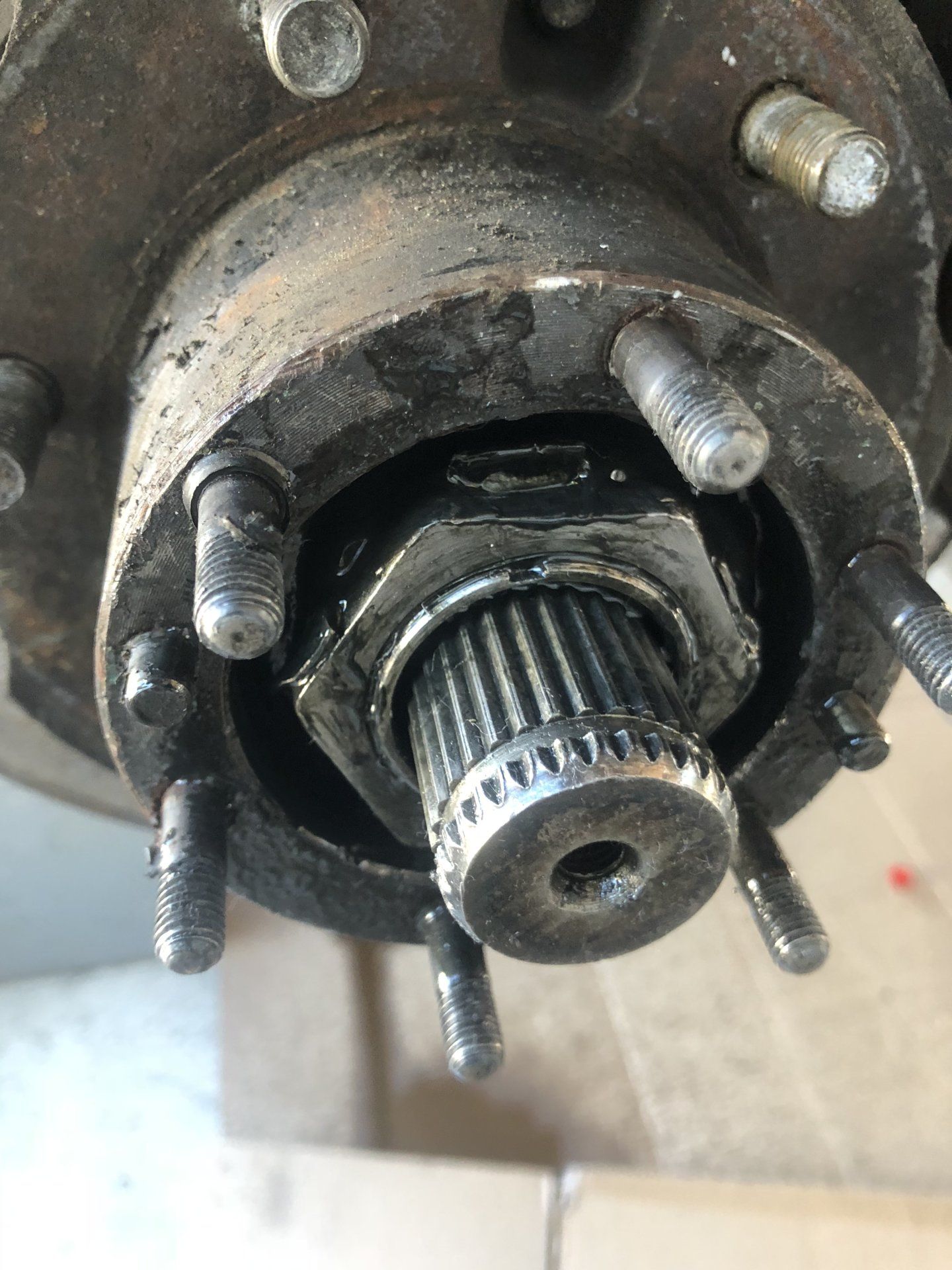

We got a lot done in one day! The previous owner/whoever serviced that front axle before was definitely a silicone junkie. No paper seals anywhere, all silicone sealant. It'll be great to scrape all that off and get the right gaskets. Glad you got the more soupy side on the front axle. :)

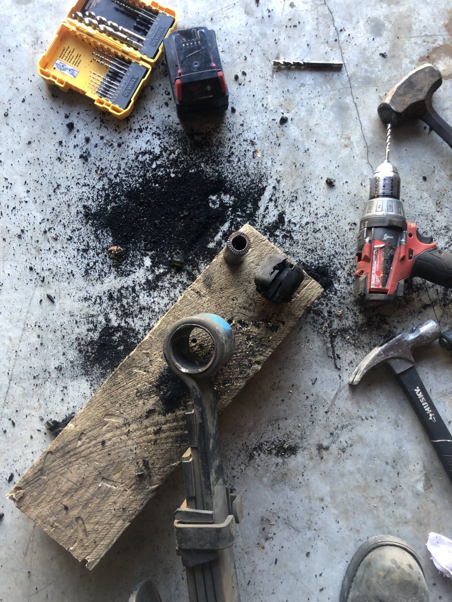

Spent 1/2 hr today getting one of the Chevy bushings out. Drilled numerous holes with drill bit on both sides weakening the rubber. Eventually was able to get a section out and remove the metal tube from the rubber. 3 more to go...
