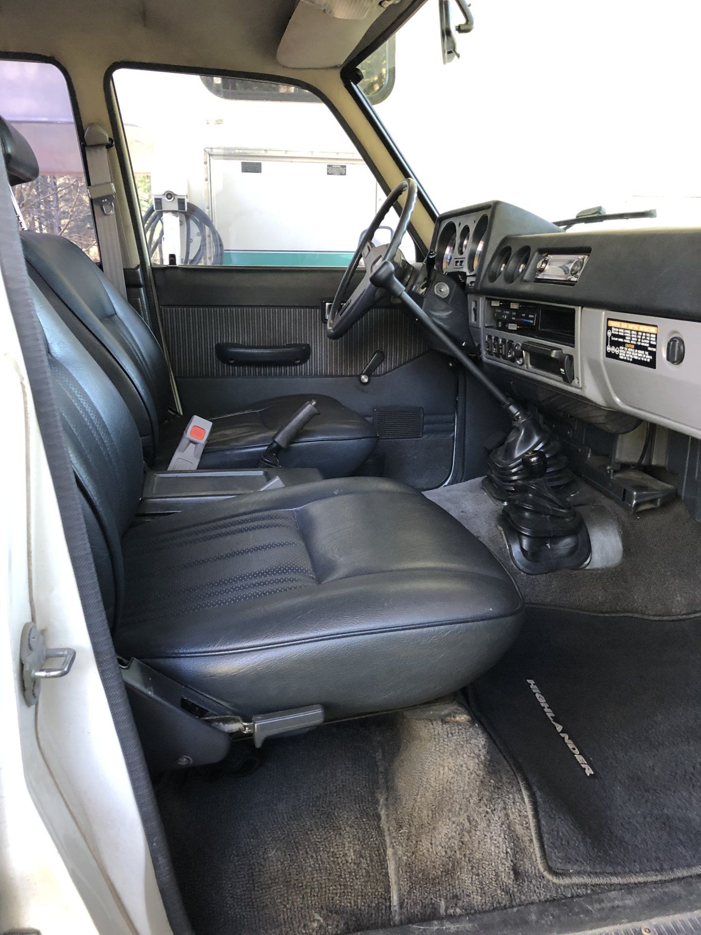

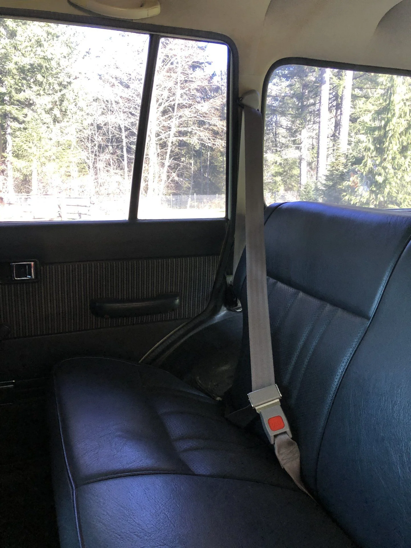

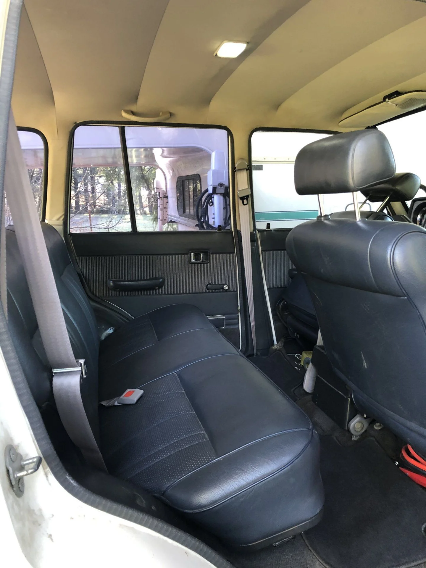

Rear passenger seatbelt
View attachment 2144588View attachment 2144584
Had about a half hour so replaced the drivers front seatbelt.
Rear retractable set took about an hour.

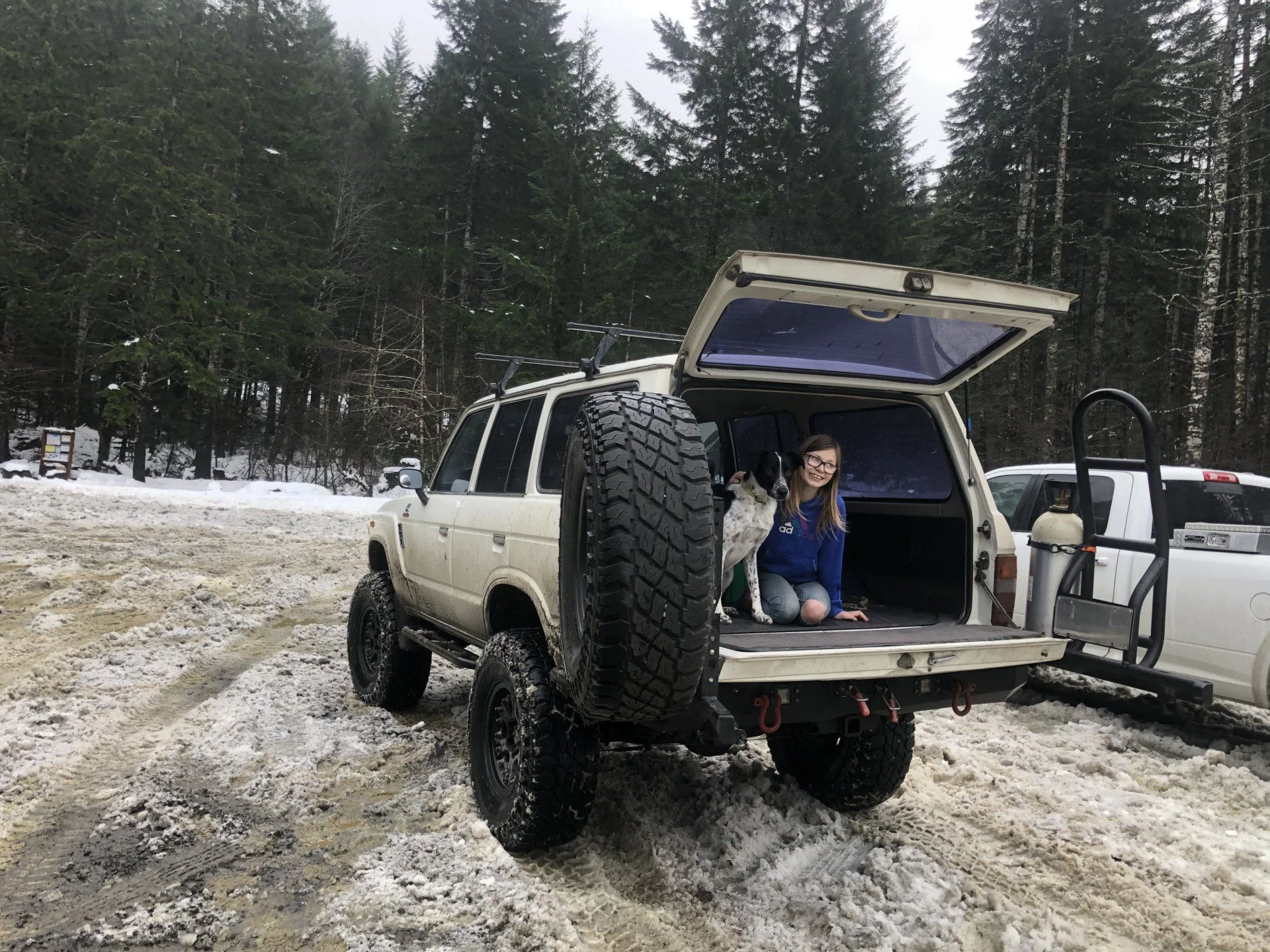

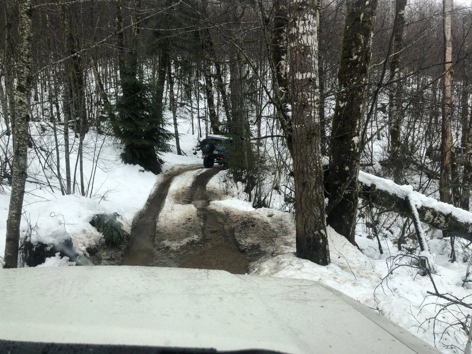

Time for an update. Today was a trip to Browns Camp OHV area in Oregon’s Coast Range. My kids came along, my daughter took the liberty of recording a few sections of trail.
Squeezing between a huge old growth stump on drivers side and a fir tree on the passenger side.
@boots4 in the lead and @FF LC FREAK in between us and @brokenparts taking up the rear.

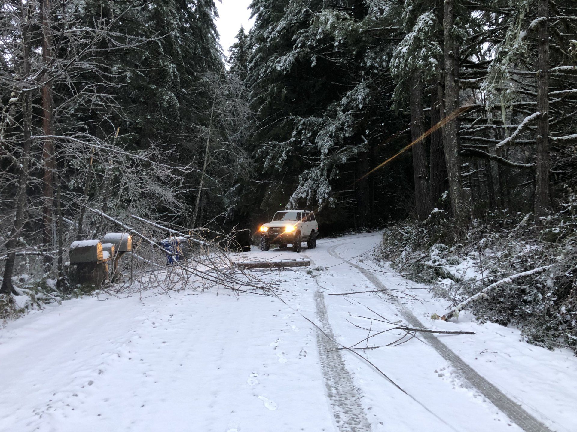

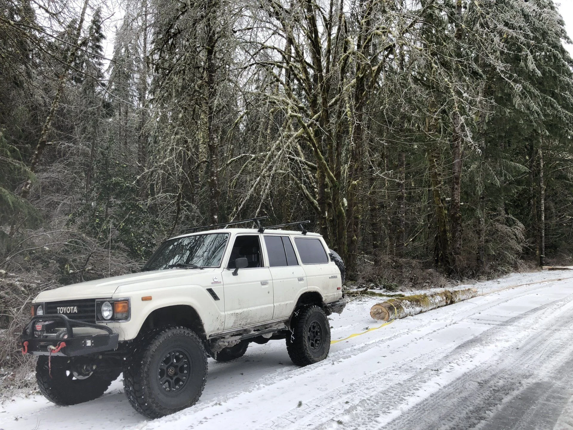

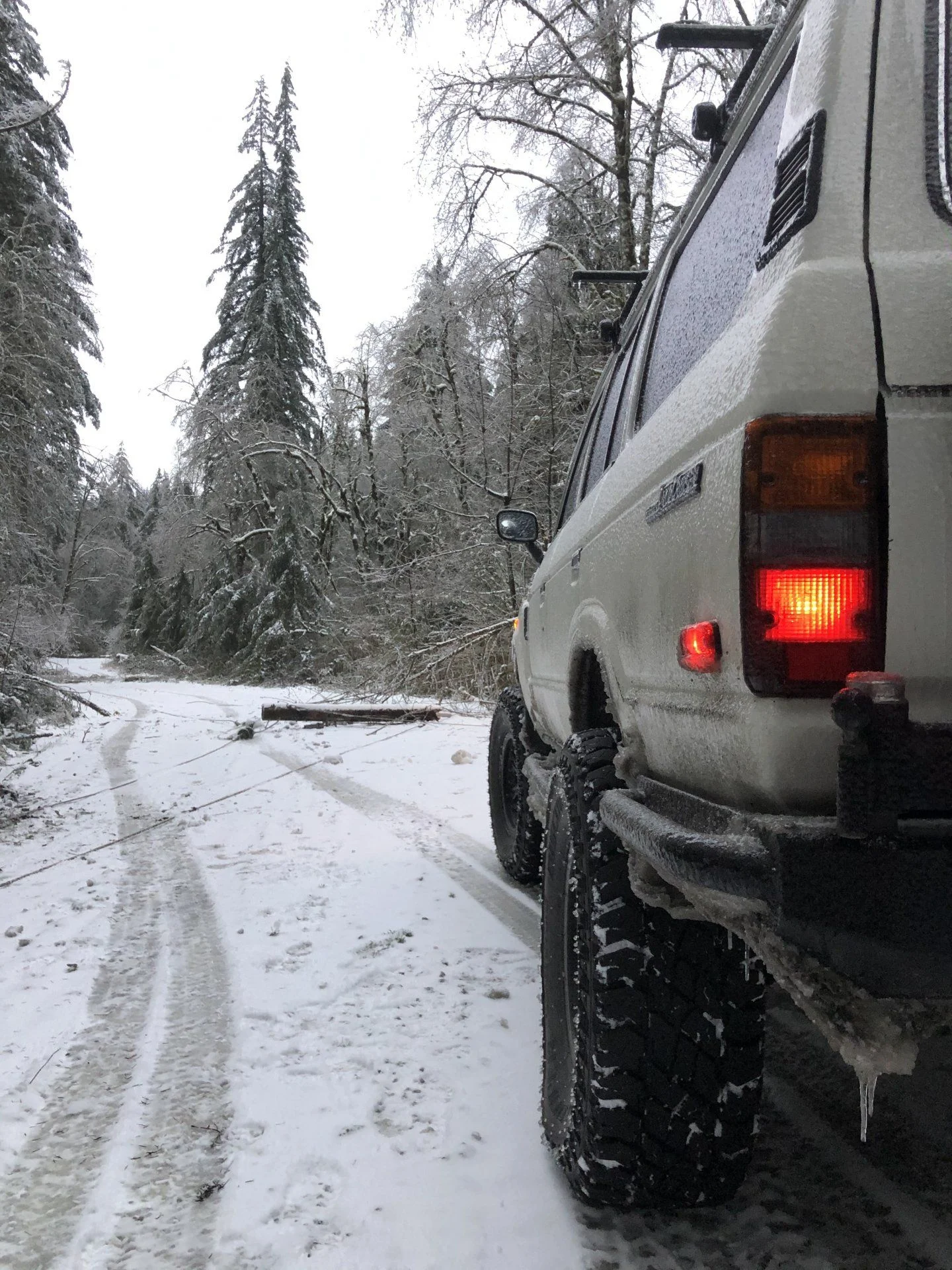

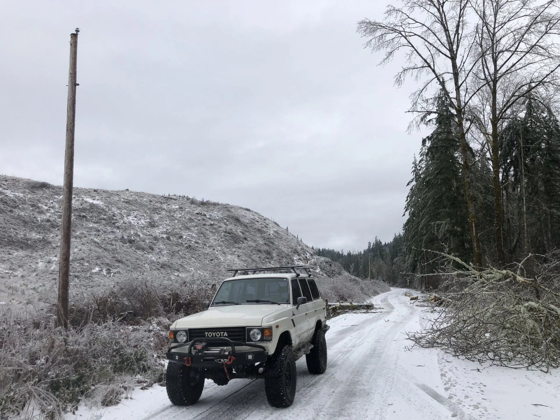

This winter has been mild. Have only had 3 snowfalls around an inch which is unusual in the Cascade Foothills. We typically get multiple snowfalls of 6” plus. Over 30” during December 2008, with over 100” for the 08-09 winter. The hammer came down Thursday with sleet and freezing rain that changed to 4” of snow, went back to sleet and then 3/4” of freezing rain which changed back to snow adding another inch. We lost power Thursday afternoon but got it back that night. Friday evening when we got the heavy freezing rain we lost it. Made it home from friends, aired down the tires to 10 psi navigating the backwood country roads among fallen trees and power lines. Saturday morning I got up early to survey the damage. Got a crew of locals together with chainsaws to clear the fallen timber.
5’ top of the power pole snapped off flung into our road.
Used the tow strap to drag logs out of the road. Parking anywhere down there was dangerous. One of the neighbors was hit on the nose with falling ice and was bleeding. The 60 was hit on the roof and only damaged my flashing on the rain gutters. Very impressed with the 60s performance and really was thinking of naming the Sherman Tank😆

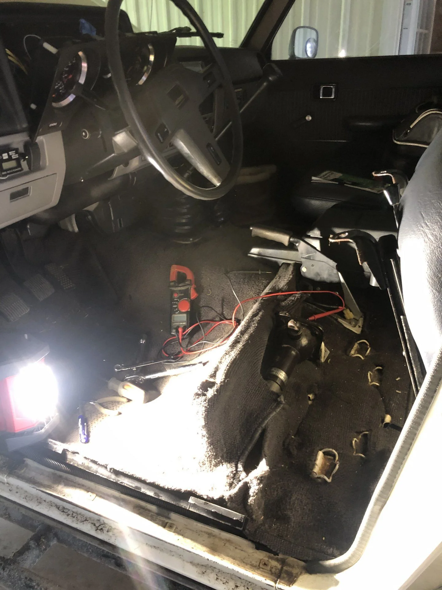

The weekend of the big snow and ice storm while out driving my BRAKE warning ⚠️ light came on. Played with parking brake handle and look for something interfering but it would not turn off unless I turned the 60 off and restarted. Then it would come on again. Durning the diesel swap the brake fluid sensor was removed and has not been an issue. I noticed when it did my volts started to drop off on my volts gauge.
Last weekend I started trouble shooting.

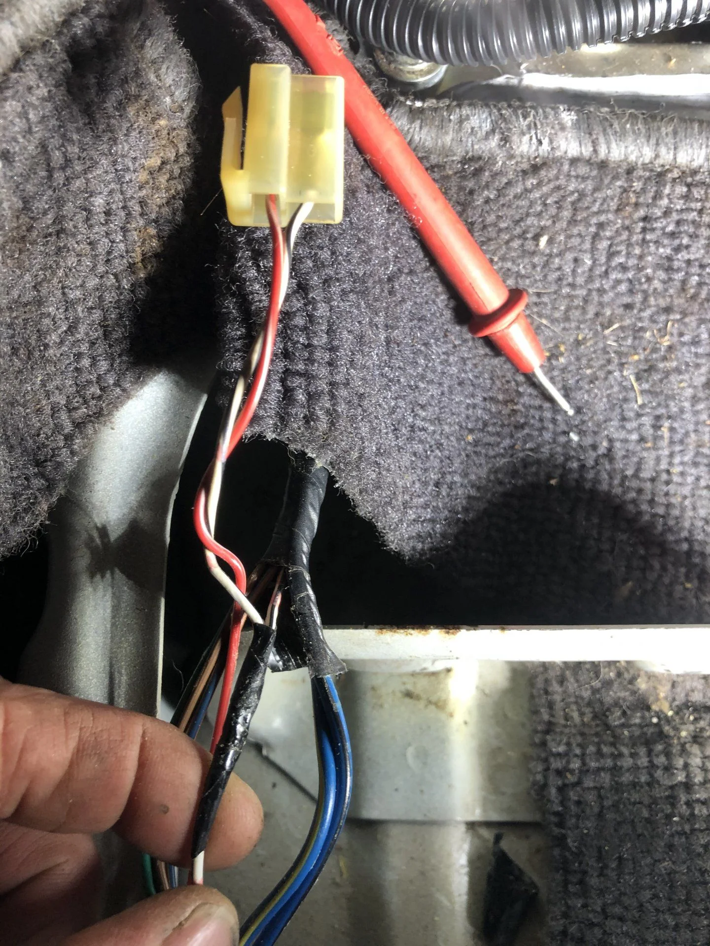

Removed the drivers seat to inspect the wire between the kick panel to the parking brake switch. I check the wire for any damage to the wire insulation. Suspect was the parking brake switch. But the switch operated open when handle down and closed with brake set.
As most 60s owner with the parking brake is the number one reason the BRAKE warning light comes on. It’s with due to the switch being bad or the handle isn’t quite picking down the switch enough to open the circuit. The other source is the brake fluid level switch which was removed during the diesel conversion. Removed the gauge cluster panel and started testing behind the dash. Black w/ yellow tracer with ignition off has continuity to ground. Turn ignition and no continuity and after starting. Install bulb and it lights up.
Tested with 12V tester and no power, til second click in ignition then the black w/ tracer lights up.
Decided to try removing fuse to BRAKE warning light circuit and that did nothing to allow my alternator to start charging system. Put battery on the trickle charger and test later Monday at work.
Put volt meter on battery terminals. Turn key and BRAKE warning light turns on and then crank starter, engine starts and BRAKE light turns off. The parking brake handle is off in video. I can set the brake and the BRAKE light turns on, take the parking brake off and so does the light. Go to the engine and check battery voltage. Shows alternator is charging. Rev the throttle cable and my volts start to slowly drop off. Go to gauge panel to see volts dropping on volt gauge. Volt meter at battery shows my slowly dropping voltage. This leads me to believe the alternator is dying. Any tech support would be appreciated. I also found another helpful thread. Here’s one I’d been posting on with little help.
And a better thread my buddy Brian sent me. Too bad the thread title didn’t come up in my IH8MUD search engine.
Hope this helps me and others understand the BRAKE warning ⚠️ light better.
I take my alternators to a local shop and they test/rebuild, sell me parts if I feel like fixing it. Using ground for a return path always messes with my electrician brain..

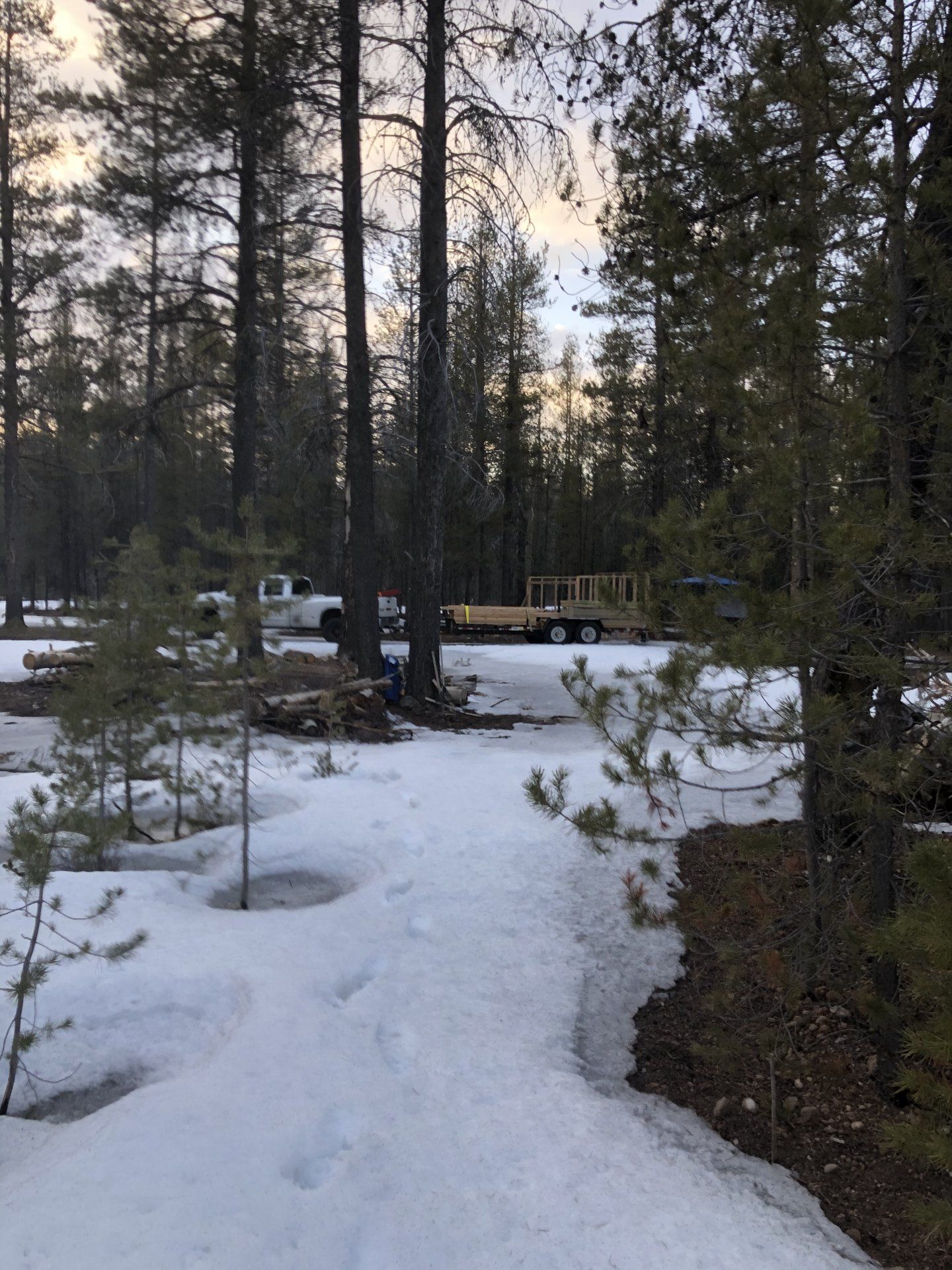

Got to the property and started on my pumphouse for the well lot while Travis’s lot had too much snow to get the truck to his. Thankfully Walter was able to come over with his tractor and clear the snow.
First stud wall.
The bathroom pad was covered with snow still and had a thick layer of ice under the snow. Before I left Friday decided to clear the pad in case I had time to start that building.
Looking from my bathroom pad at the pumphouse.
