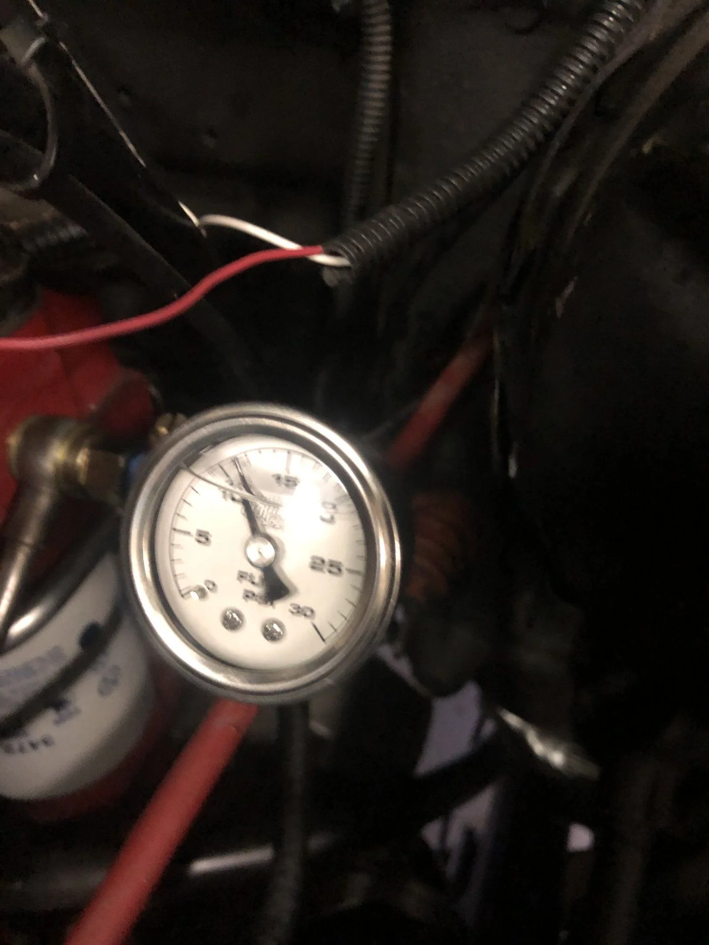

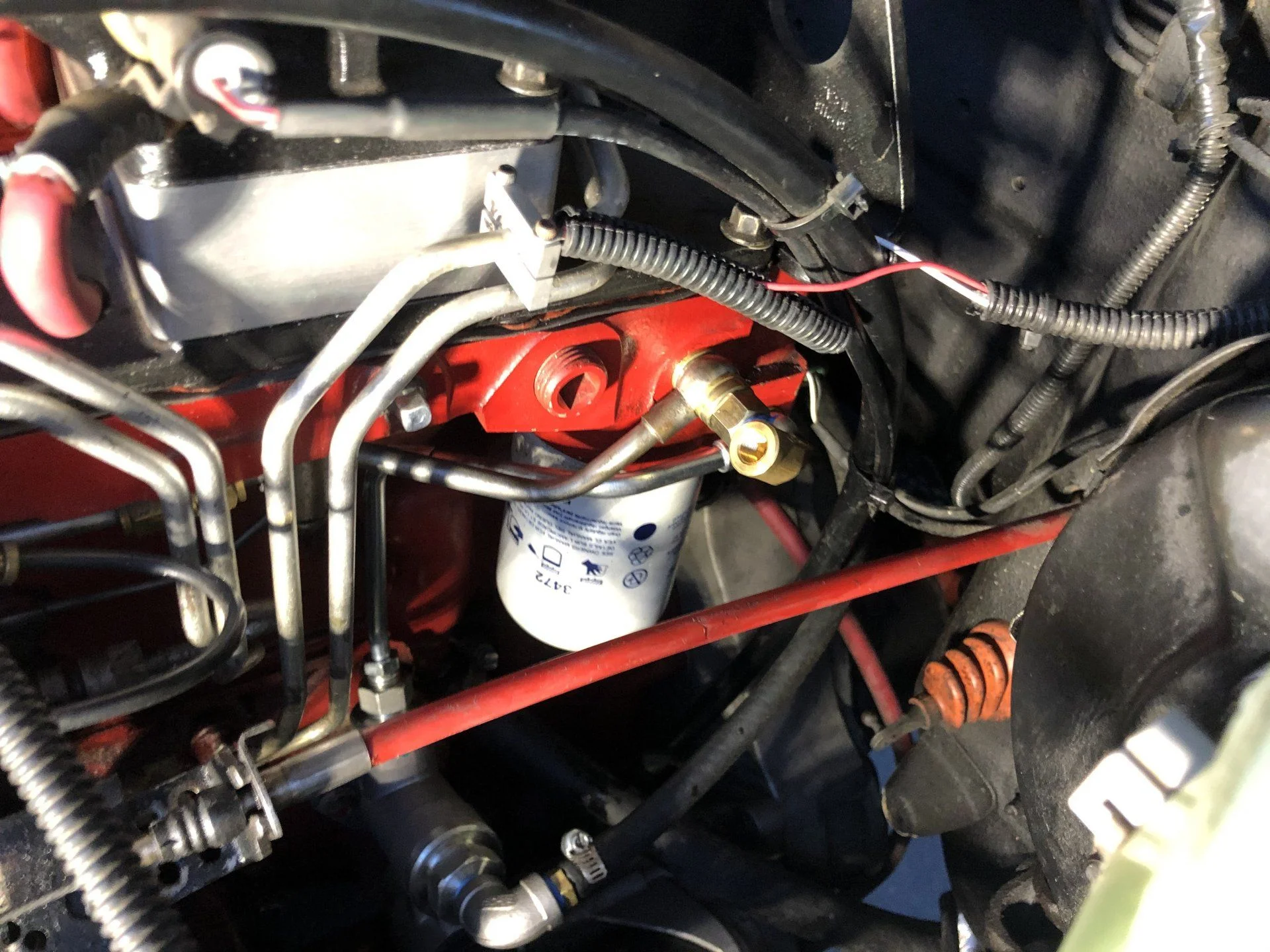

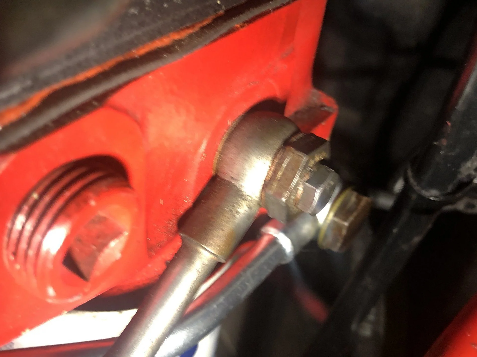

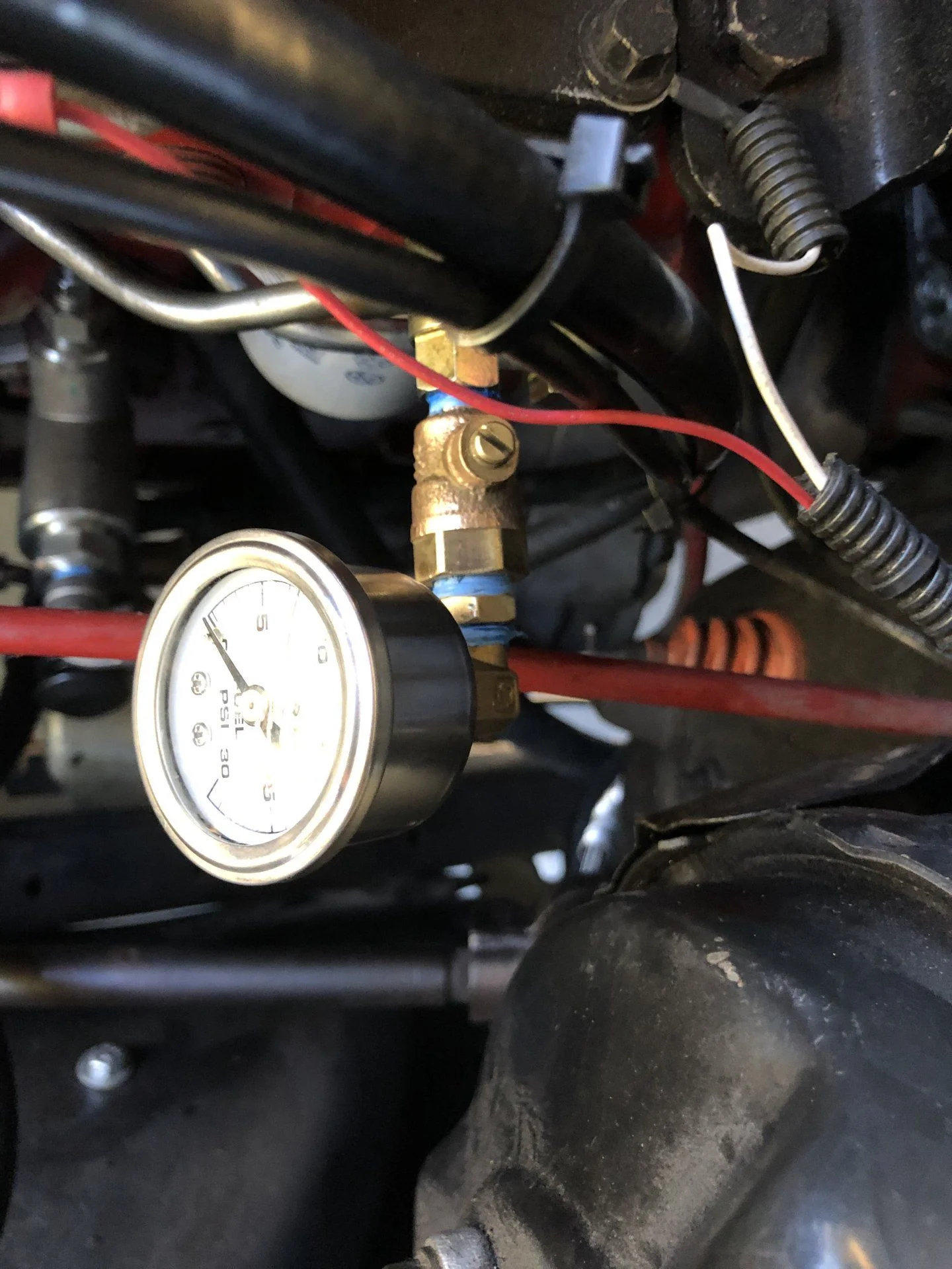

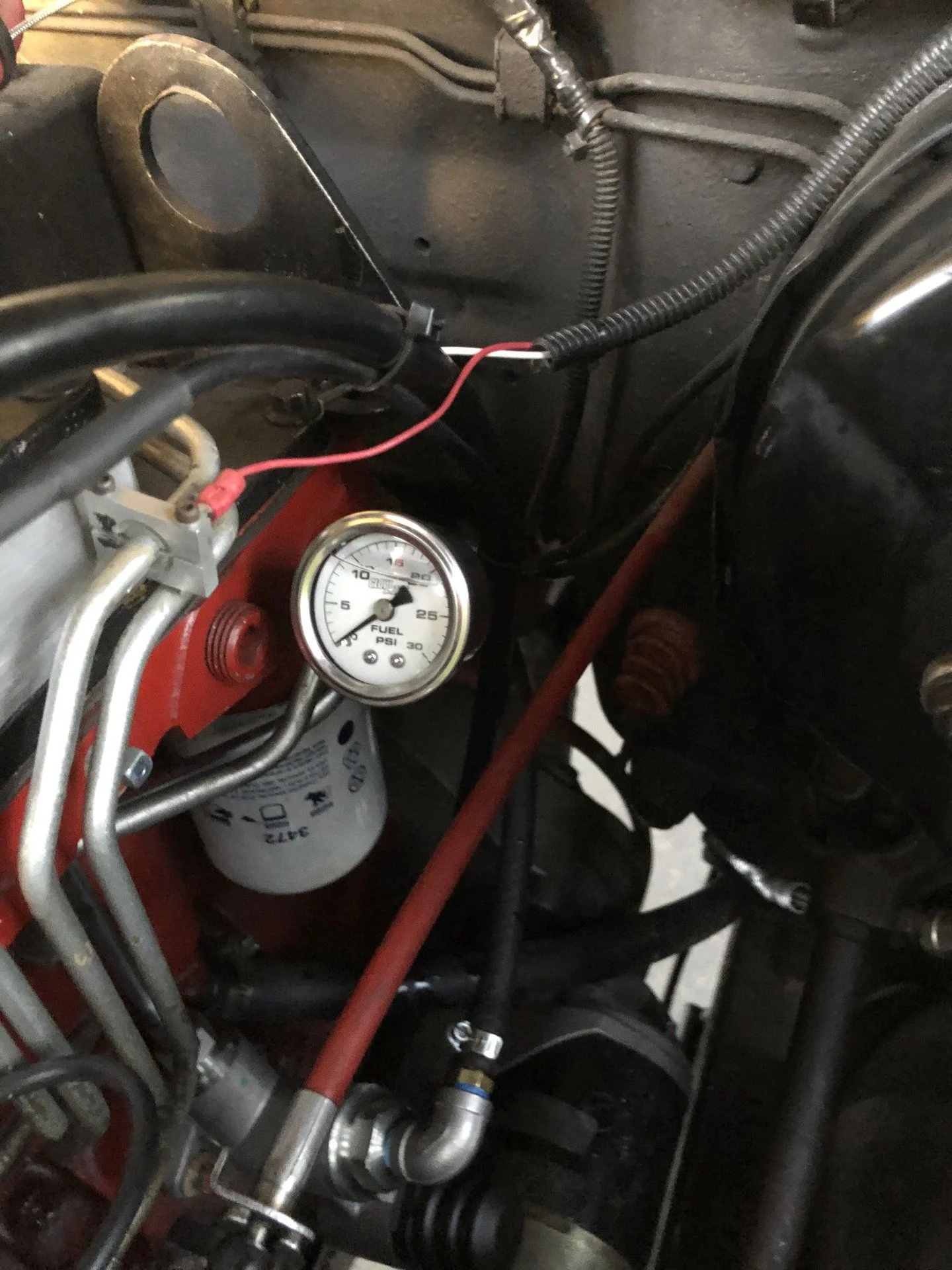

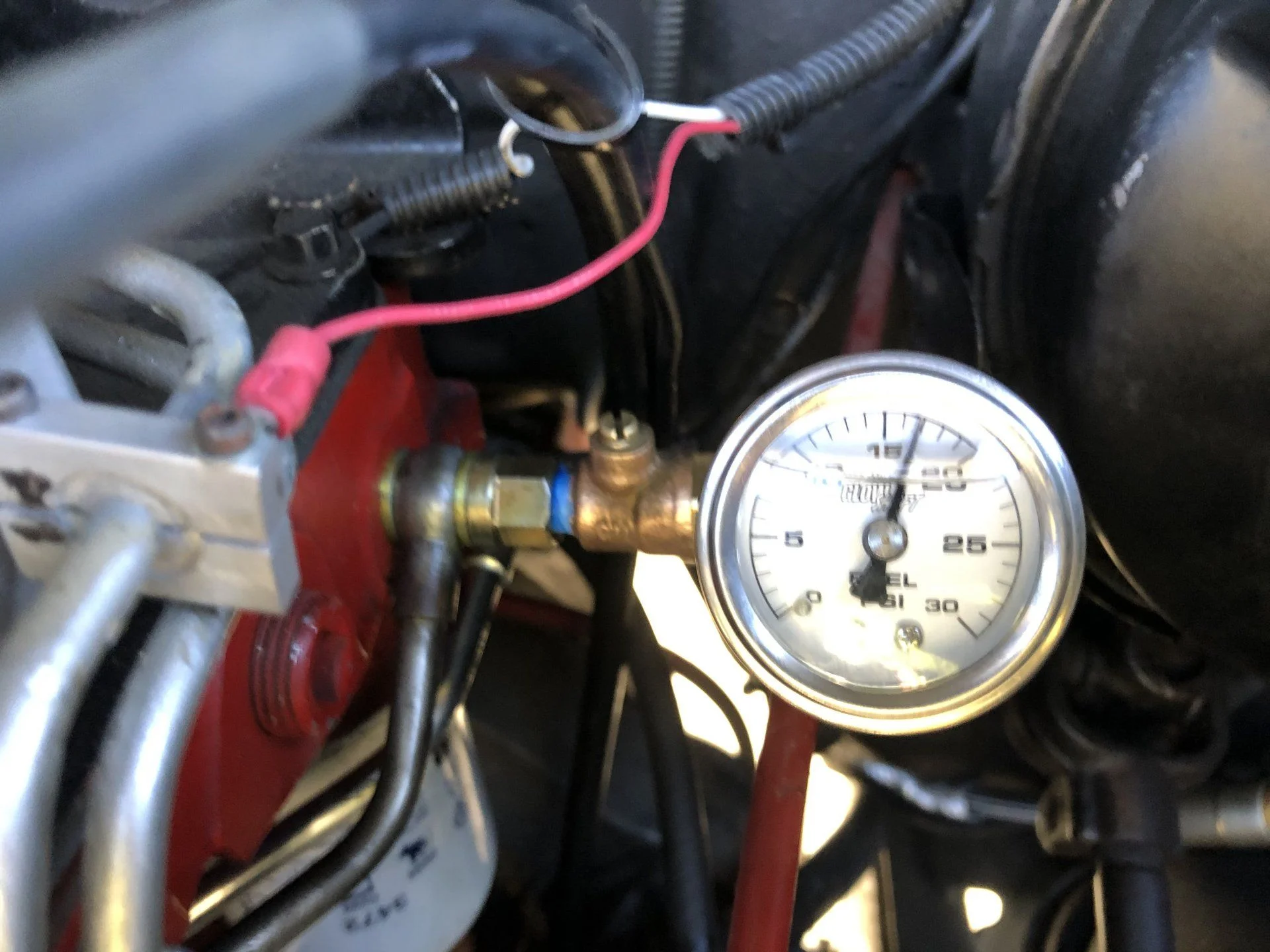

Banjo bolt with bleeder screw on the fuel line between the fuel filter and VE pump.

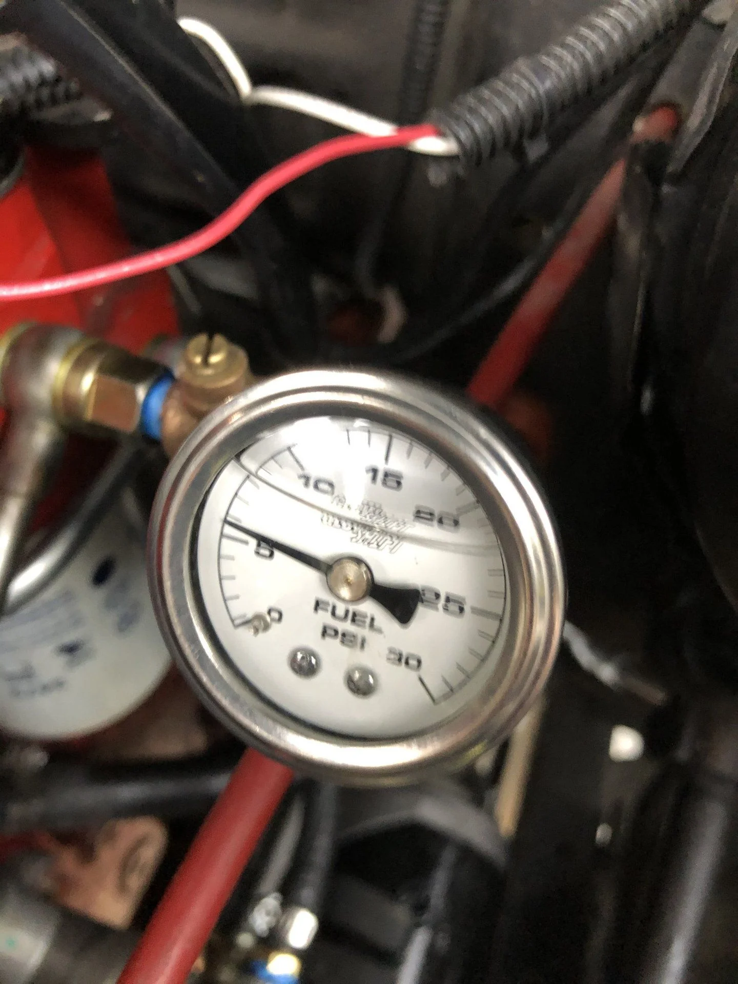

I got a tapped banjo bolt and installed a Glowshift 30psi fuel gauge. The gauge came with a 1/8” brass street 90 which made seeing the gauge
View attachment 2514878View attachment 2514883
Even with a liquid gauge the needles still oscillates. Have a 1/8” brass ball valve at work I can put on to help stop the gauge from swinging.
If you put a pipe straight up and a hole in the hood you could see it while you drive!

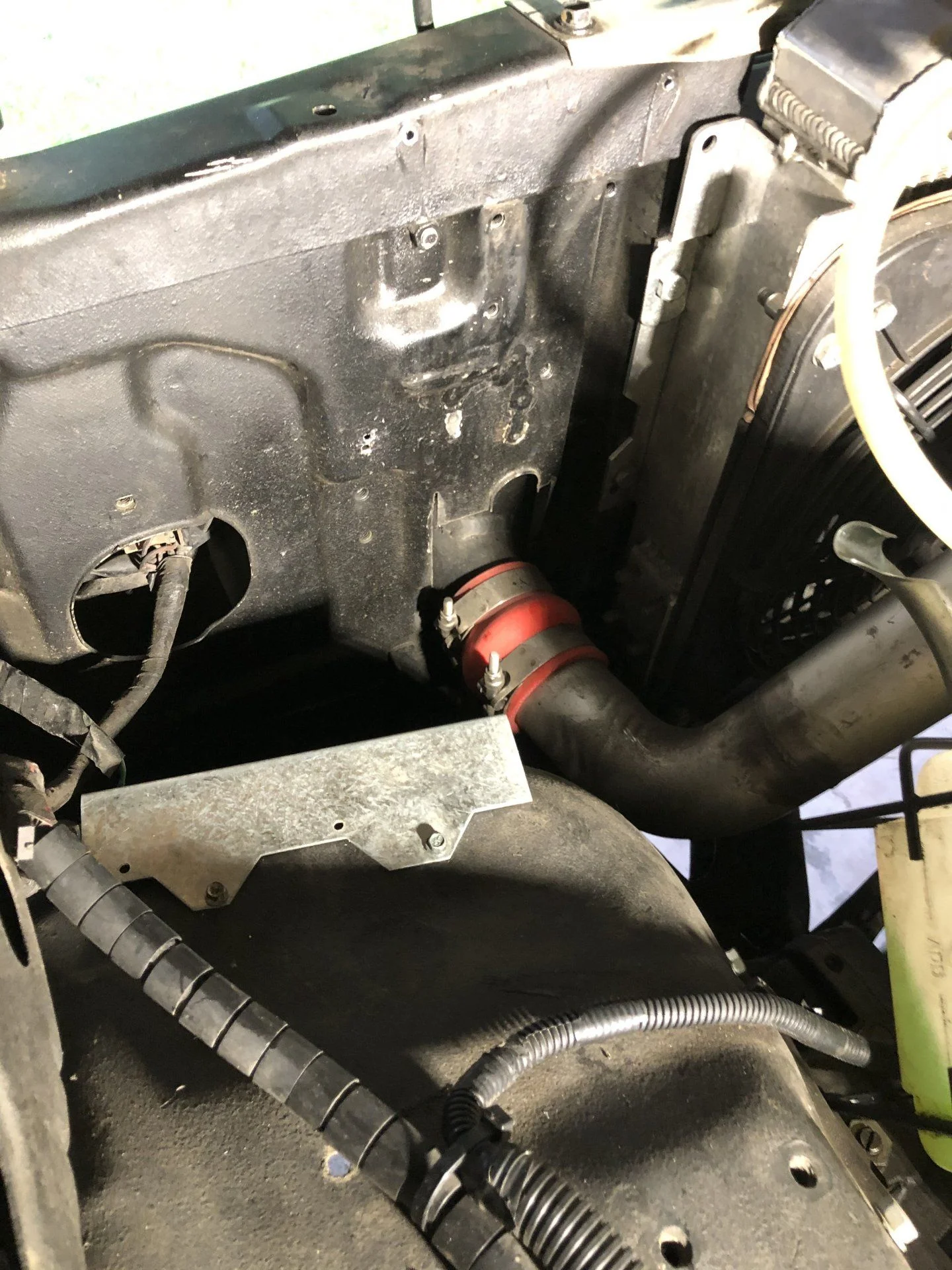

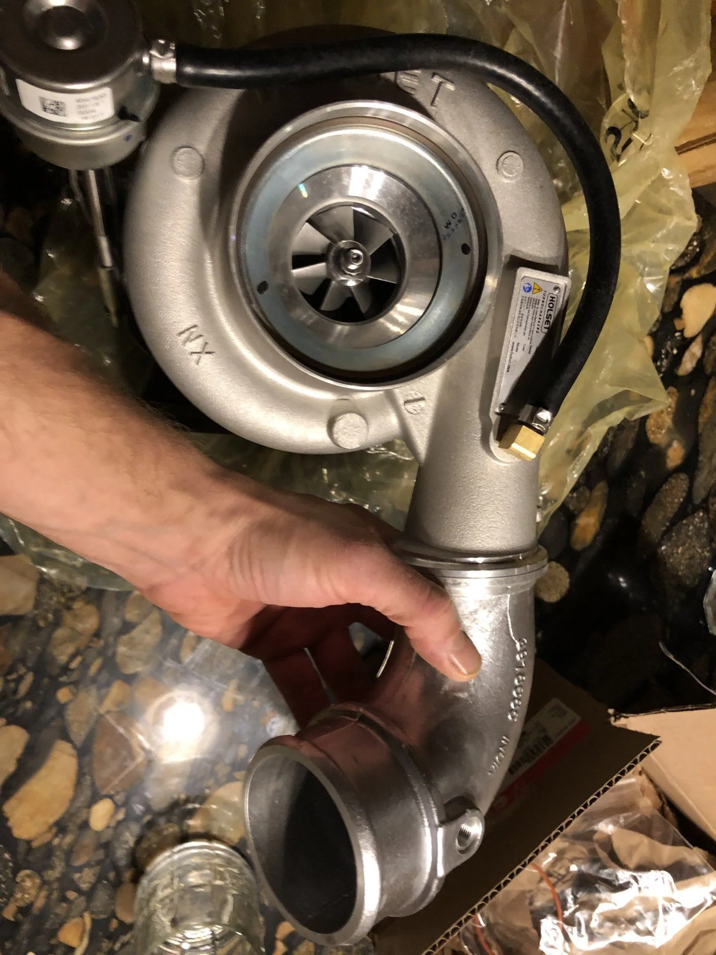

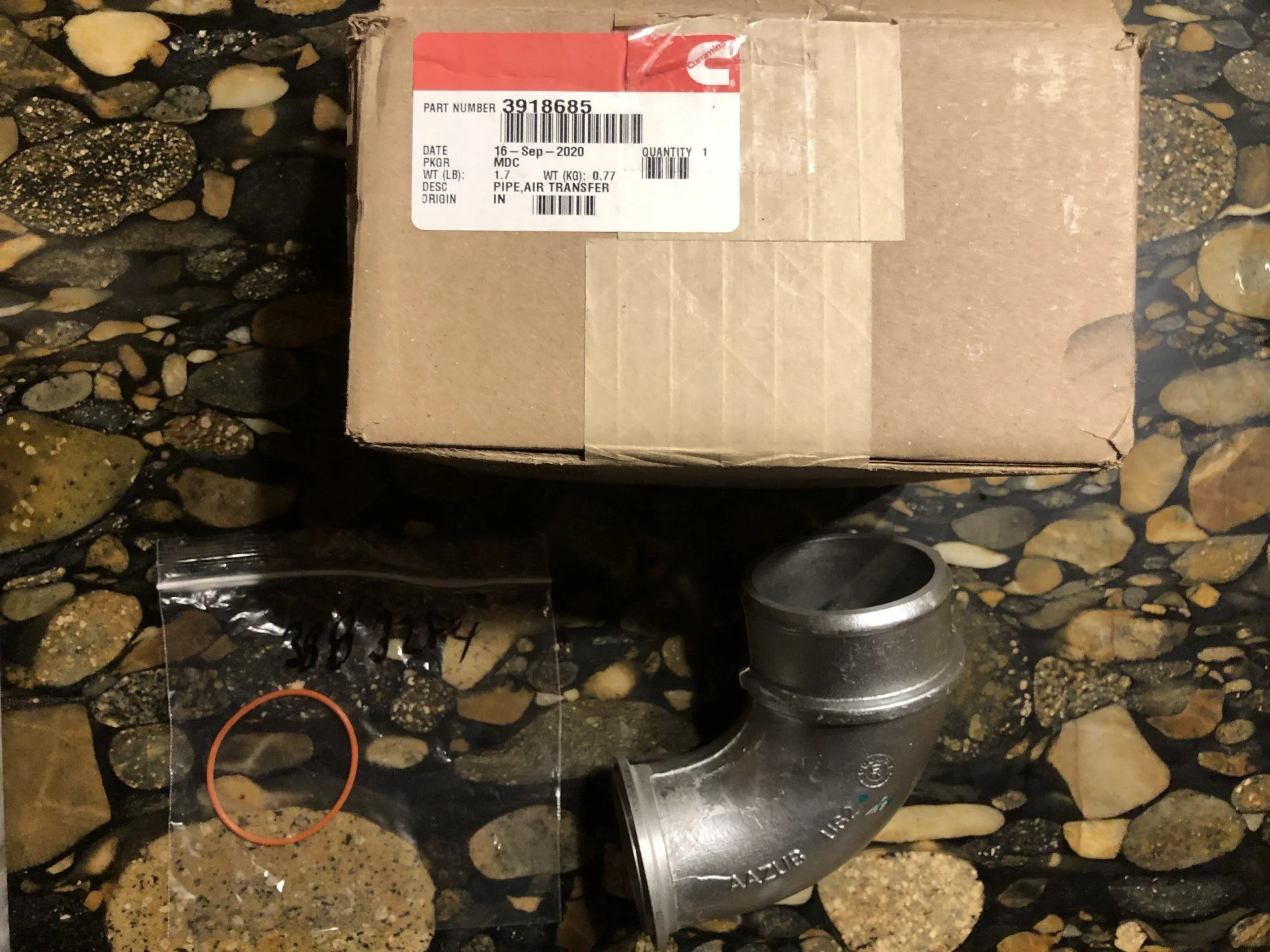

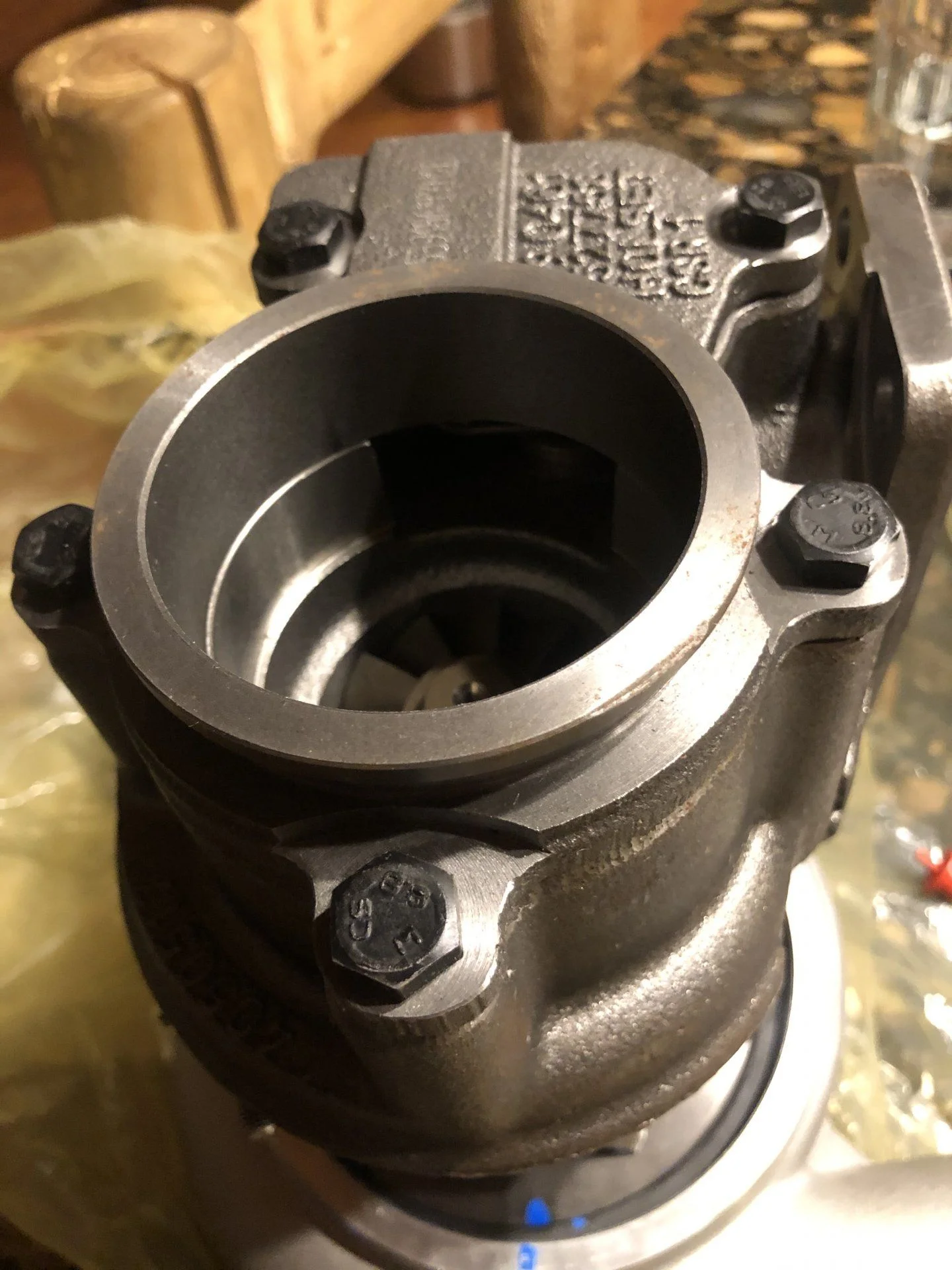

Tonight got the HX35 compressor elbow.
Took out the HX30 super and check to make sure it’fit.

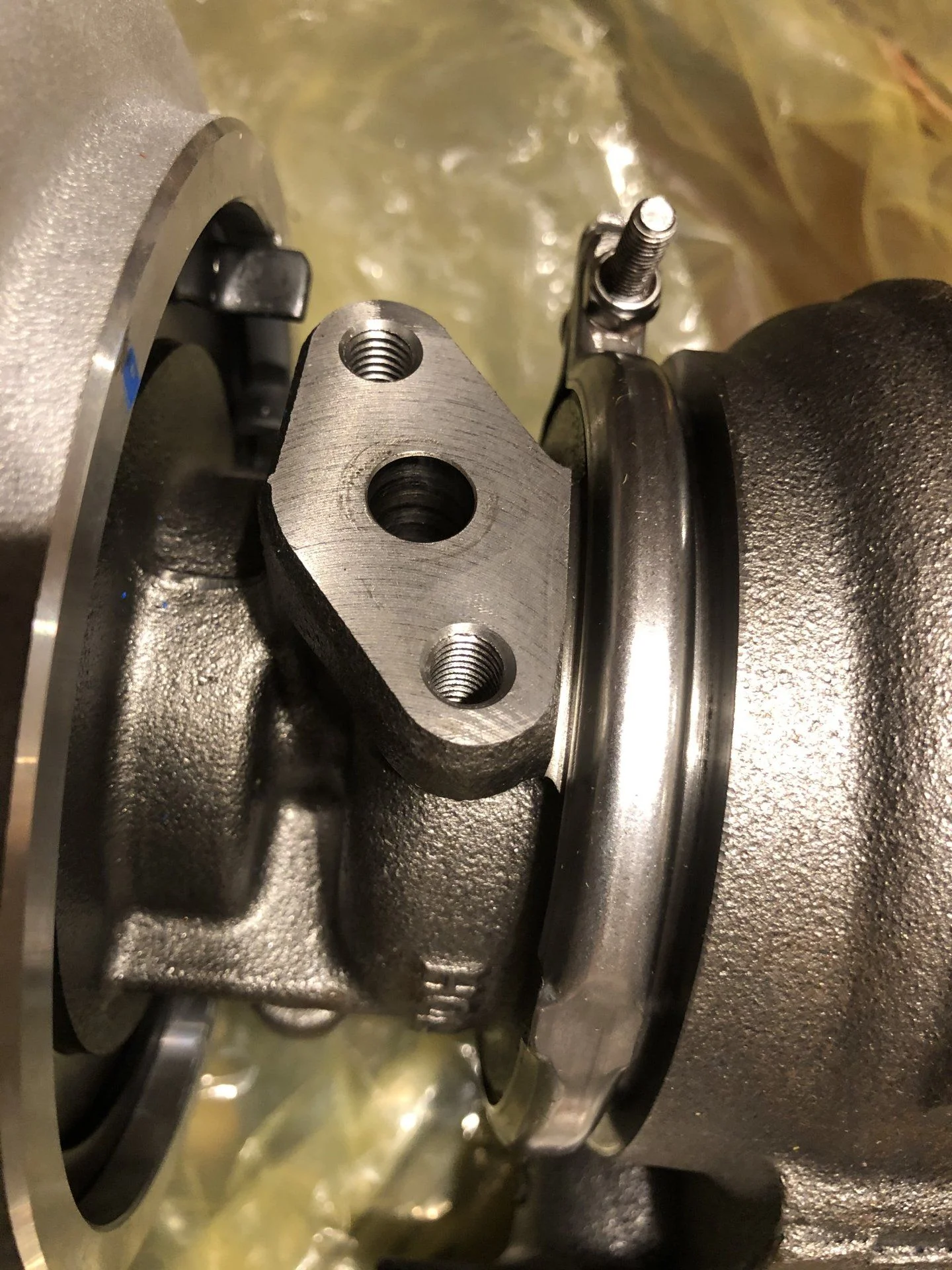

Holset HX30 super has a flanged oil feed supply, DieselTuff has a oil feed kit for $69 + freight.
If I can find the right flange I could make one for a lot less. Help with sourcing a flange would be awesome.View attachment 2514887
Is bolted half of exhaust HX30 and HX30 Super interchangeable?
My HX30 has a Marmon flange welded on which would be nice if I could just remove it and bolt it to the HX30 Super. Also wondering if the oil return flange is the same as the HX30?
@GLTHFJ60 ?

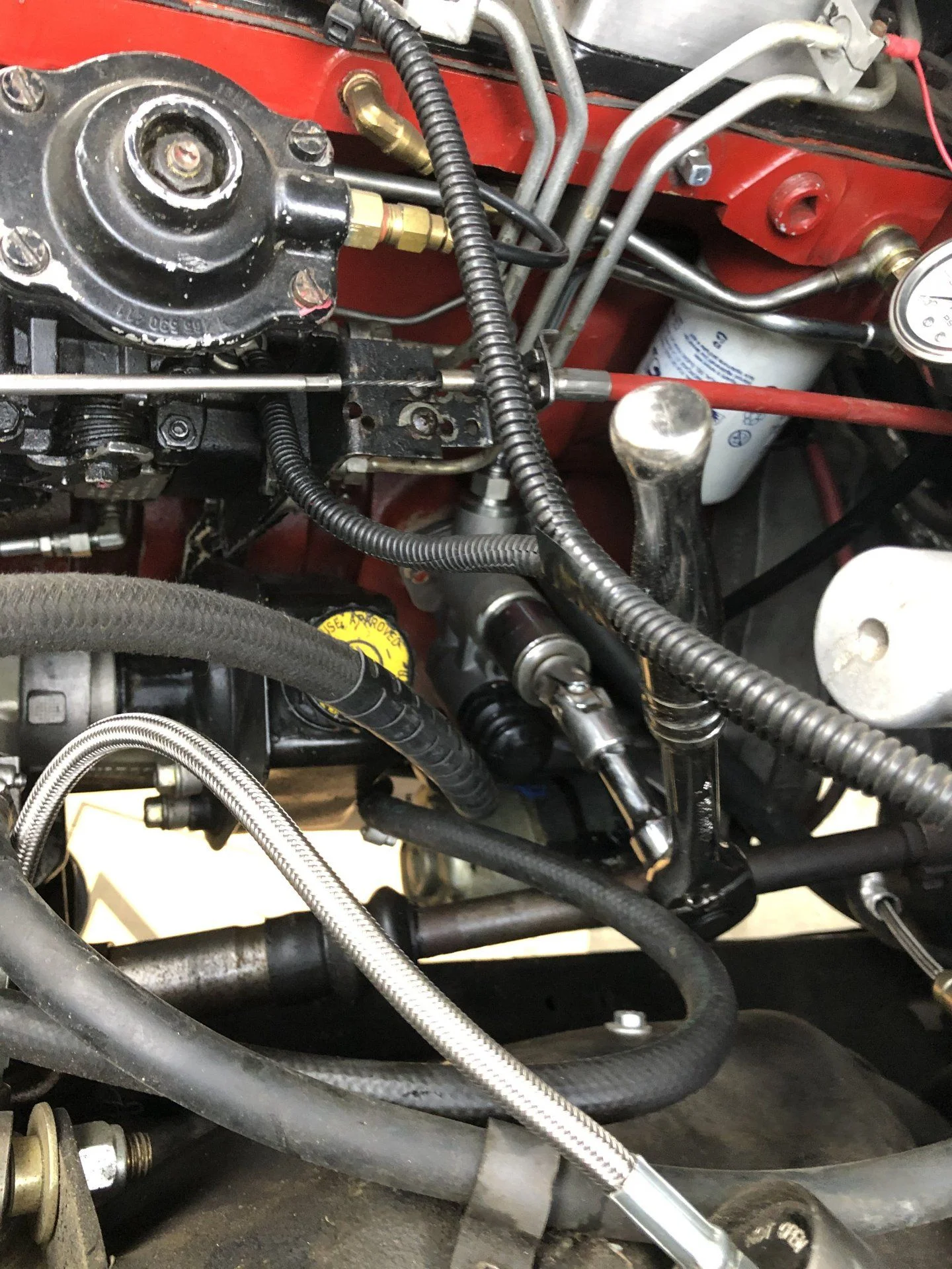

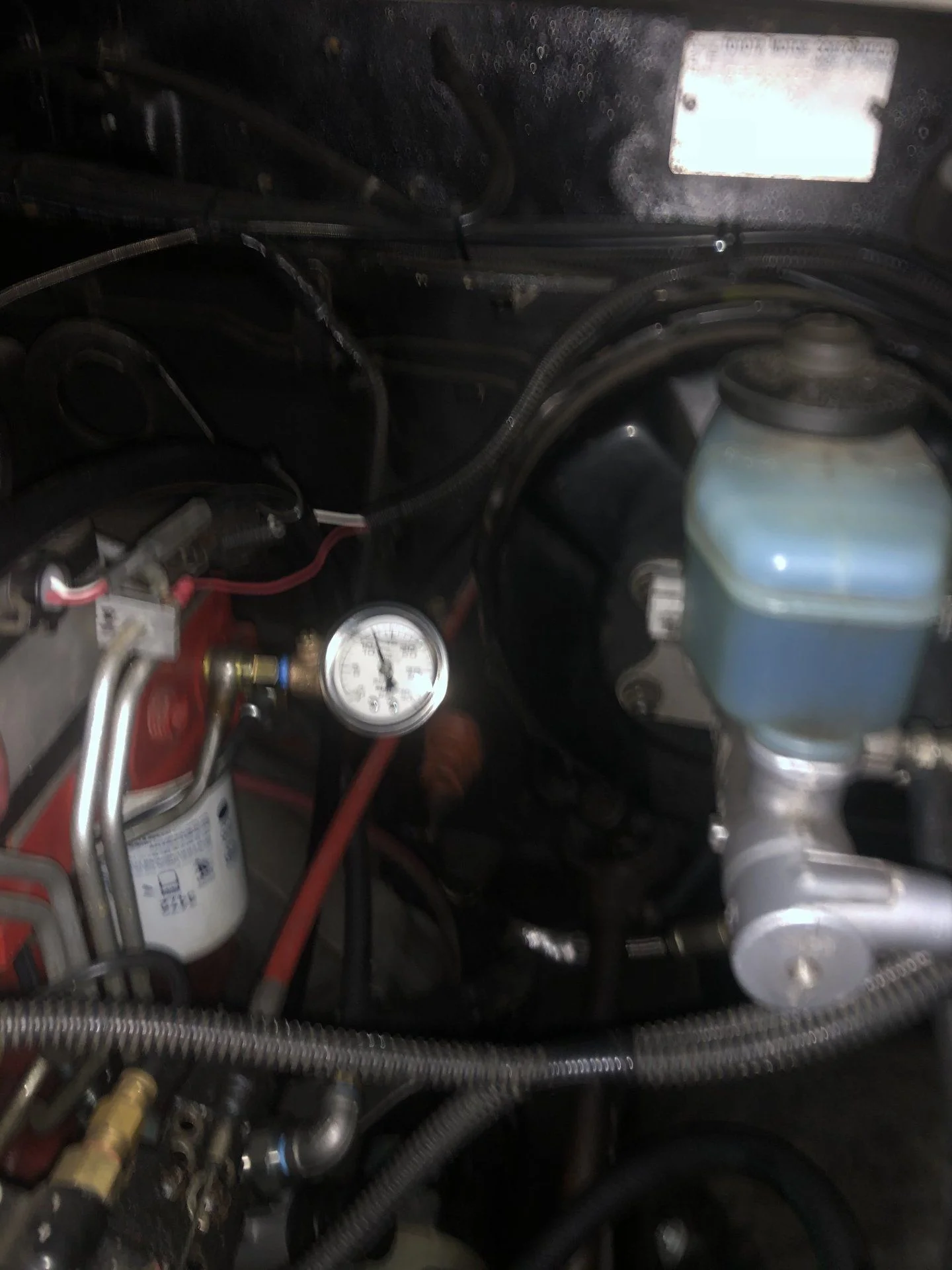

I installed a 1/8” brass pet cock valve today to remove the oscillation in the liquid filled fuel gauge.
Worked like a charm. Warming up and the gauge is 17psi. @ idle.
Got home driving 17 miles and the gauge reads 12psi. @ idle.
Reving the engine and it didn’t climb past 14psi.
The oscillating fuel gauge is because fuel pressure oscillates in the head. The piston lift pump adds pressure at a rate dictated by the cam. The injection pump either consumes it, or it's returned through the return regulator. My digital gauge oscillates a bit, no biggie. Take out the valve, just another thing to fail.
Yes the super hx30w return is the same as the hx30w. Yes, the 6 bolt flange is the same as well. I used a generic t3 flange on the chra for pressure feed, with a -6an adapter, and used ptfe fittings/line. I like that I can route the line however I want, and make it the perfect length. It's all in my thread.
Remember, the super hx30w is the same as all other hx30s, just with a different pressure feed, and a different intake size.
Thanks Johnny @GLTHFJ60 for the HX30 super answers.
I do like having the valve on the fuel gauge. I know with water gauges that have the oscillation they don’t last too long. Liquid filled help but don’t always take all the oscillation away. I set the valve so the valve is closed just enough to get the gauge relatively steady without a 5 psi needle swing.
What would you rather see, the actual instantaneous pressure reading, or a "rolling average"?
The pressure will go up around 18ish during high rpm decel. Engine spinning fast, so the pump is working hard, but the injection pump isn't consuming any fuel. Hasn't been a problem for me yet, *knock on wood*, but it does happen.
I'm on the side of keeping a "snubber" like this or a needle valve in the fuel pressure line going to the gauge. It's still accurate, it just smooths out the pulses coming from the lift pump and allows one to read the value easier.

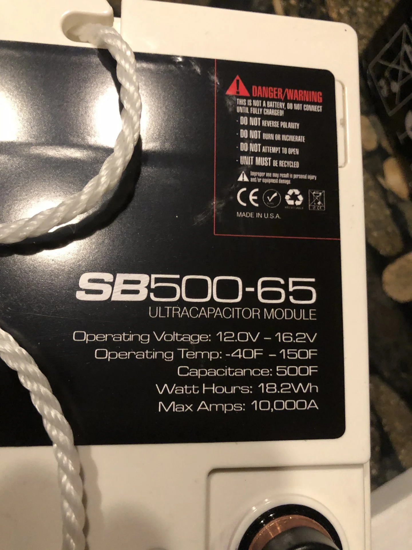

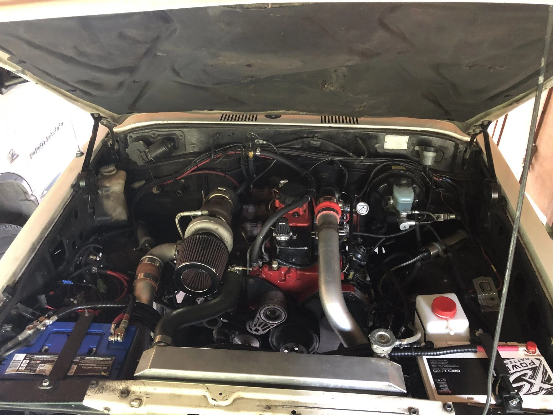

My XS Power SuperBANK ultra capacitor showed up today.
This will be a nice addition to aid in starting the diesel down at the Crater Lake property in 0F weather.

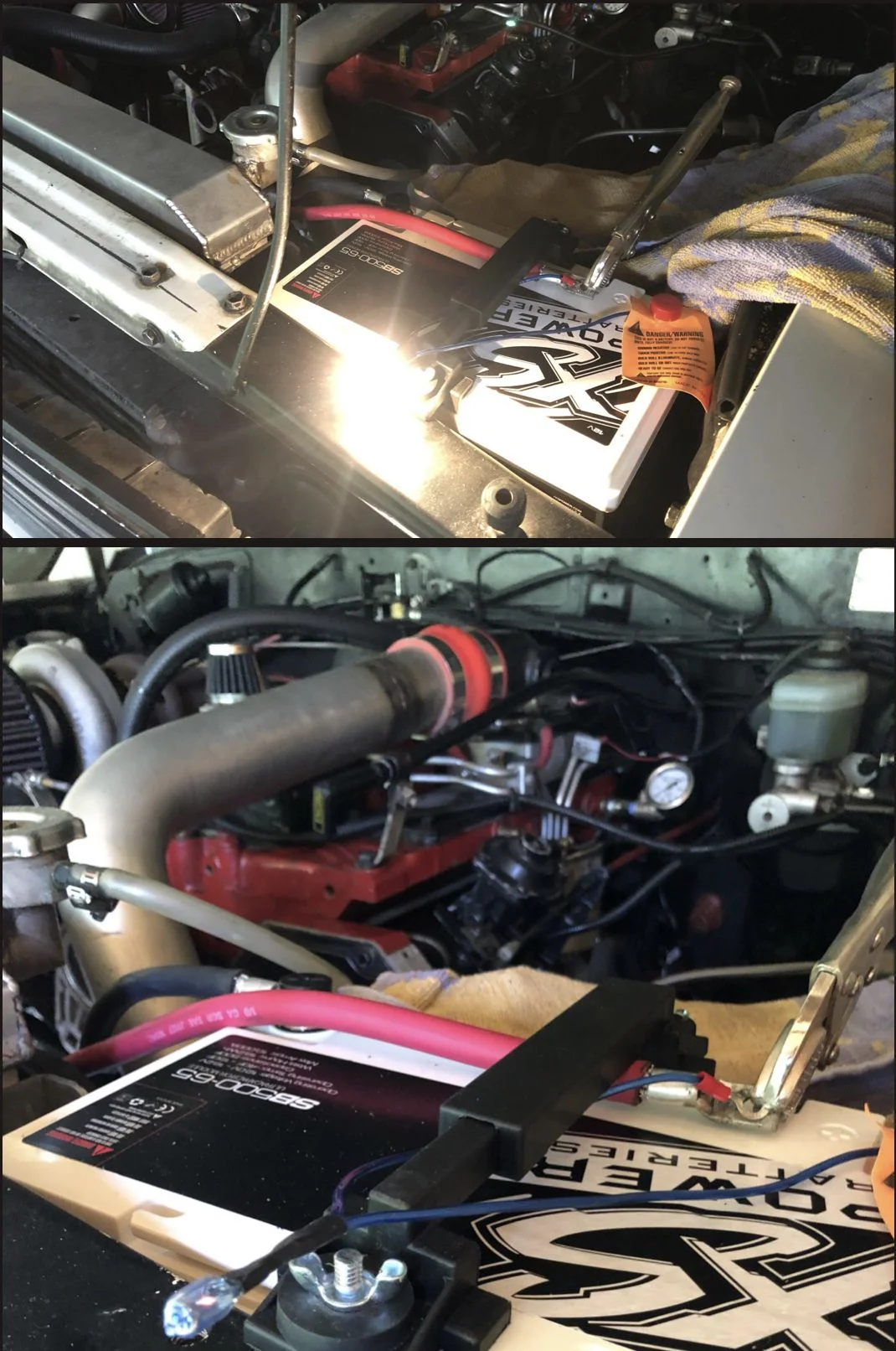

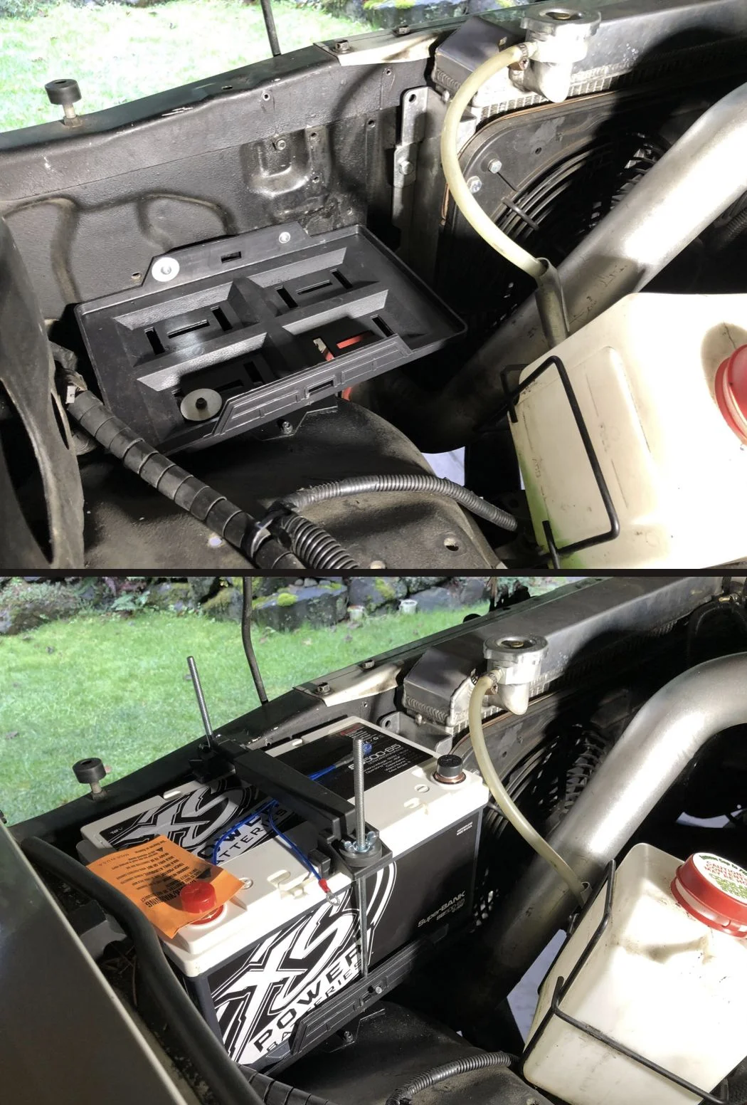

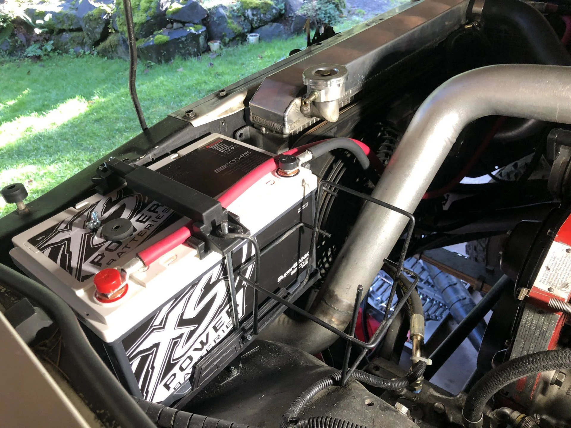

Time for XS Power SuperBANK Ultra Capacitor installation. I bought the Ultra Cap and battery tray from JEGS. I had plenty of real estate for the Ultra Capacitor, just had to move my coolant overflow bottle. The battery tray the salesman at JEGS sold me had no mounting hardware, also was 1/4” too narrow. I used my Milwaukee fine tool to remove the lip of tray on one side to make it fit. The curvature of the inside wheel wheel dropped off too steep. Dug through my framing hardware and found a L-bracket which worked nicely.
Secured the battery tray and was ready to get the ultra capacitor installed.
Next was getting wire distance measured. Solder on terminal adapters to the wire. Run wire from battery to ultra capacitor. Hook up negative. Use vice grips and crimp positive wire to the supplied charging regulating light. When first hooked up the light is brightly illuminated but as the ultra capacitor charges the light slowly dims out when fully charged.
Remove the light and connect positive battery wire to the positive ultra capacitor terminal. Next was figuring how to reinstall my coolant overflow bottle. Modified the bracket reinstall.
Ran wire loom and zip tied the wire out of the way and was ready for startup.
I decided to take a short video of my cold start the other day to compare the difference between just a 930CCA battery startup and startup with the addition of the SuperBANK ultra capacitor.
Startup with cranking volts dropping close to 8volts.
Startup with cranking volts dropping to 10.5volts. Much smoother and stronger starting power. Now just ready for some cold arctic weather. Unlike batteries that struggle as temps get too hot or too cold, ultra capacitors are rated -40F to 150F.

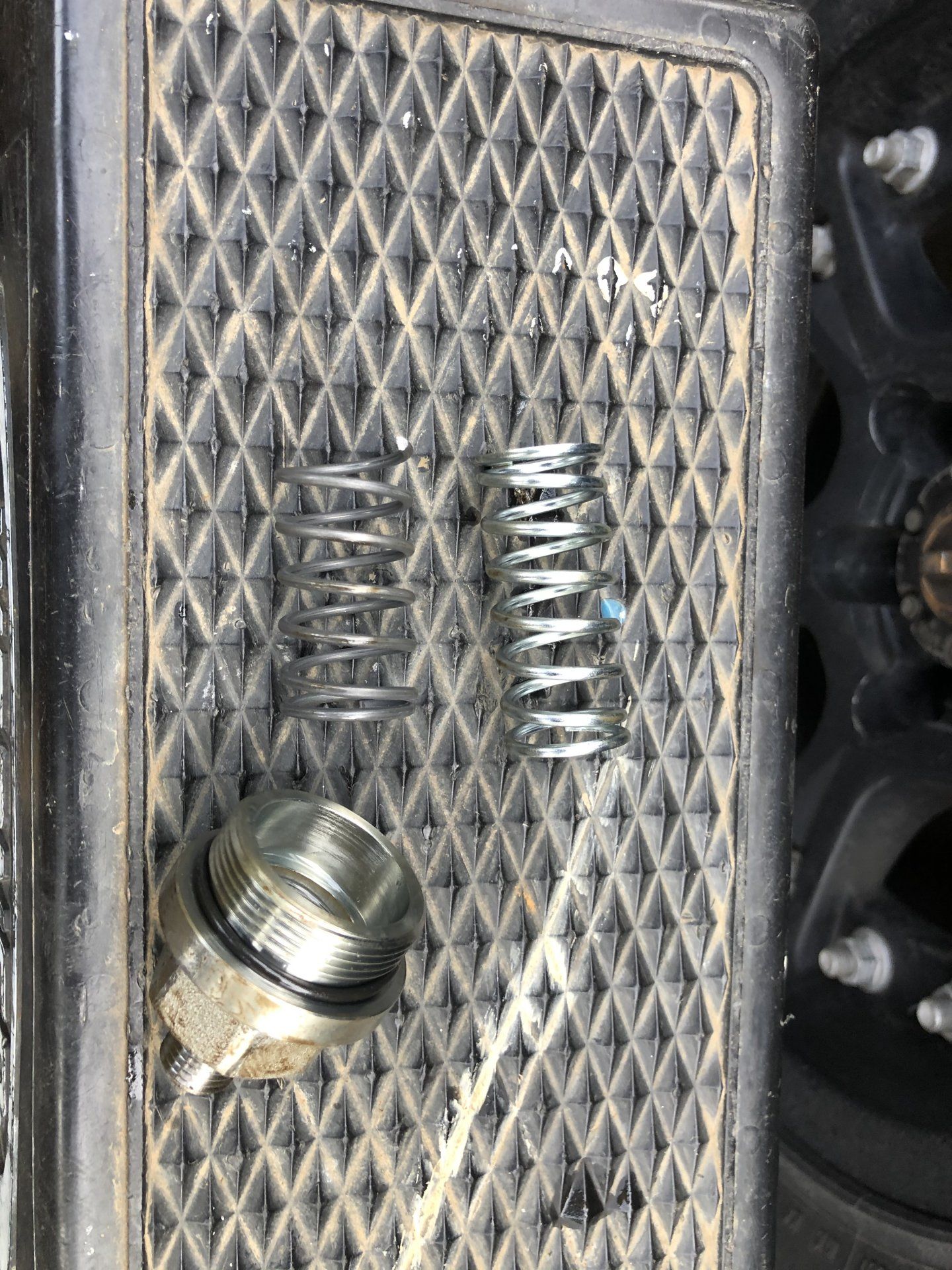

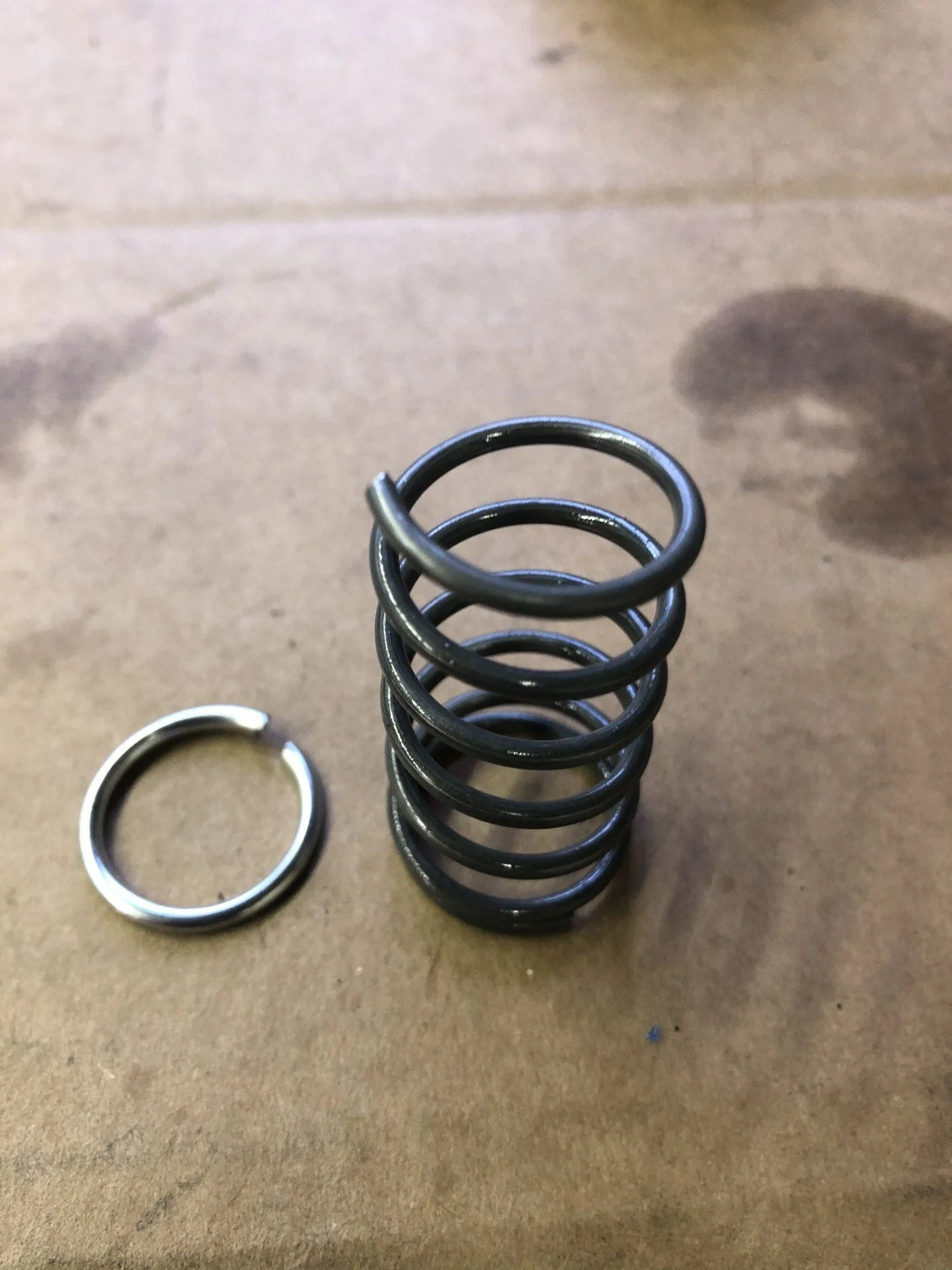

Changed the lift pump spring I picked up from @boots4 and changed the spring today.
Idle is now 6psi. Down from 16-17psi. Took Snowball❄ for 5 mile drive and check pressure and it was down to 3psi. Drove back to shop and removed the spring in lift pump. Cut off one full loop of the original spring.
Reinstall original modified spring.
Now it’s idling at 11psi.
Merry Christmas IH8MUD family
Perfect, this is one of the reasons having the pressure gauge is awesome. For me that spring got me 7 psi on my gauge but snipping your original worked out just right. Glad you got the pressure back to a safe range.

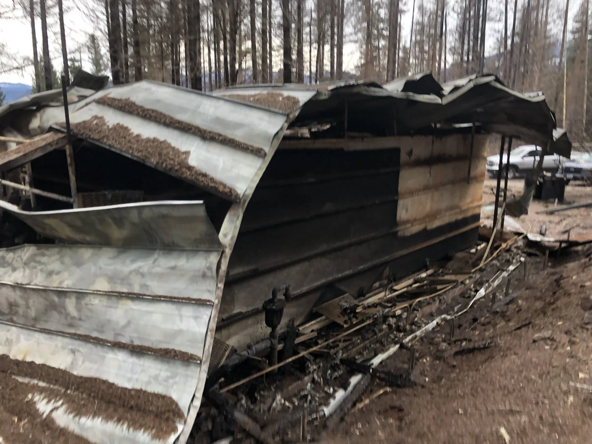

I was able to get access today to look at site to rebuild a water system for Timber Lake Job Corp. The pumphouse and water system were totally destroyed in the fire.
Burned pumphouse, filtration system and the generator at the site. The forest was burned worse than I even imagined. It will take generations before it looks like it’s former glory.
