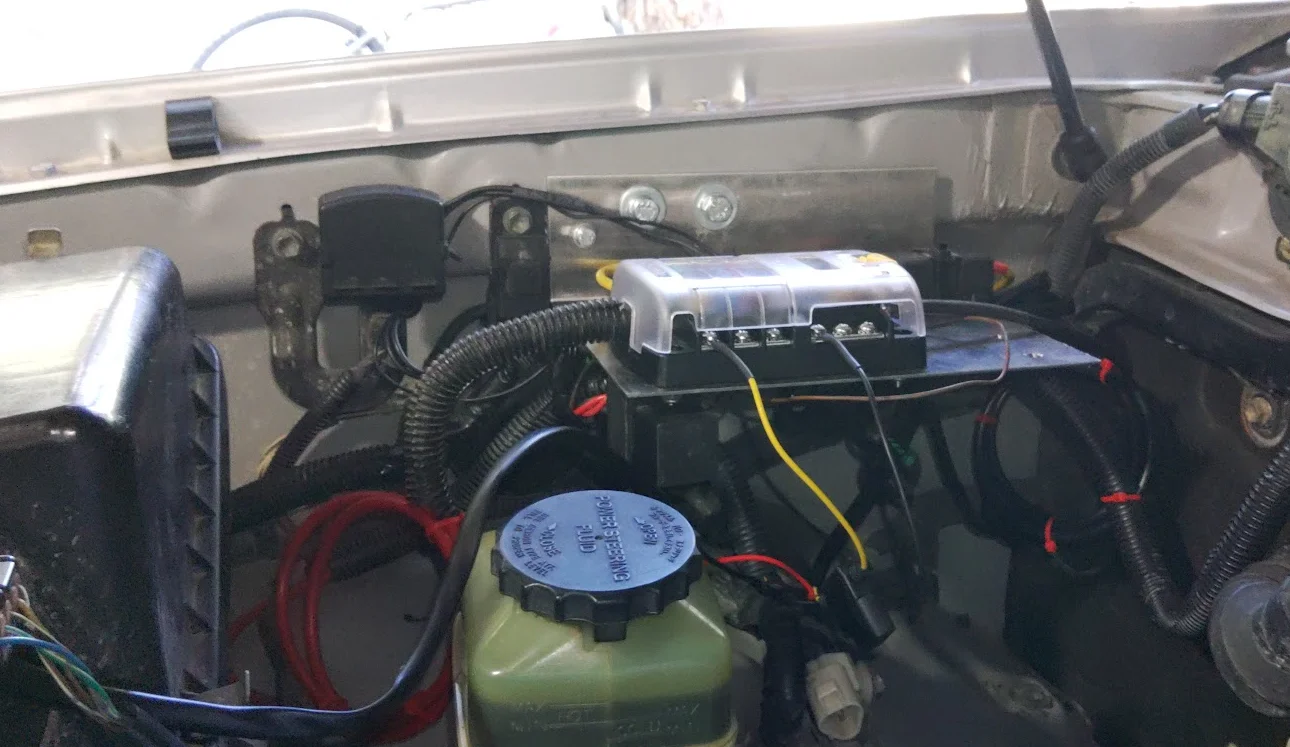

I used the owl tray thing but cut some out to route the wires for the Auxbeam. Its in there tight but it works. Also put my breakers for my amp, 2nd battery charger, and the auxbeam on the vertical side.

No experience with the AUX beam product but on the LC ( if you don't have dual battery) we have a lot of empty space and threaded holes on the passenger side. I rigged this up.

I recently reworked all the accessory wiring in my rig using an Auxbeam 8 gang switch panel. For mounting, a PowerTray GX/4runner tray works on the passenger side on later models with the charcoal filter mounted in the rear up under the spare tire. Linked below. The wiring Auxbeam provides with the switch panel is able to reach the factory battery terminals with no issues. I can’t confirm nor deny fitment for earlier models.
I used the essentials mount. I can’t confirm this will work for earlier models with the charcoal canister in the engine bay.
GX Auxbeam Essentials Mount
I was able to get it working. I have the canister under the hood, but mounted the panel right next to it. My issue was the fuse to use to power it all. But I ended up running the wire through the firewall and going into a fuse inside the cab. She works perfect now.
Same. I ran my switched power wire through the firewall. I didn’t want to tap into the fuse box under the hood and risk it not sealing properly/water ingress.
