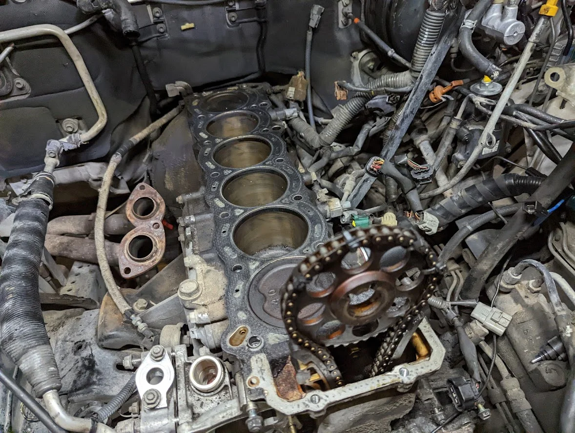

Tonight I got the oil cooler off. It was surprisingly clean, but well worth removing to clean it and reseal. I also got to take a closer look at the cylinder head and I think there's a chance that the head gasket was compromised at some point in the past on cylinder #5 and #6. Take a look and let me know what you think.
Here's the full video
Ah crap. I just opened a huge can of worms with this one. Still not sure whether to be excited or terrified with the amount of extra work I just made for myself. This just turned sideways into a completely different direction. Now to start planning what the turbo setup is going to be.

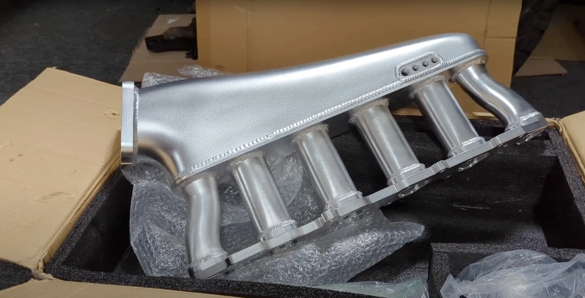

For those too lazy to click the video above, here is what just arrived:
Won't that short runner setup kill torque?
Low rpm torque. Maybe? A lot depends on the turbo and the rest of the setup. Just add more boost :)
You write this update like you accidentally bought this shiny piece of art
Honestly. I did not plan to do anything more than an extensive rebuild until a few weeks ago. It was one of those late night, in the garage, with a nice cold glass of bourbon sorry of brainstorms. I slept on it, thought some more, and just had to do it. I still don't know what to do about the turbo, intercooler, injectors, fuel system, etc... But I'm sure another night with a glass of Angels Envy Rye will help me put the rest of my plans on paper.
Uh huh. Likely story :flipoff2:
Cool setup, I think the Plazmaman has a little longer runners than the Hypertune. I have heard there is a little interference with the firewall with the Plazmaman but I am sure it isn't much. Looks good, I am definitely subscribing. I have been running my old Turbo truck with Haltech for almost what a decade now!
Ya. Seems like the firewall side might need some massaging. I am just hoping the ABS stuff doesn't have to move. What ever ended up being your power to the wheels after the Haltech tune?
It ended up being 380awhp and 490ft/lbs, I think if you want more power I would go with a bigger turbo. The EFR 7670 is a great size for instant boost but runs out of steam on the top end. But it is enough to chirp the tires and lift the driver's corner.
