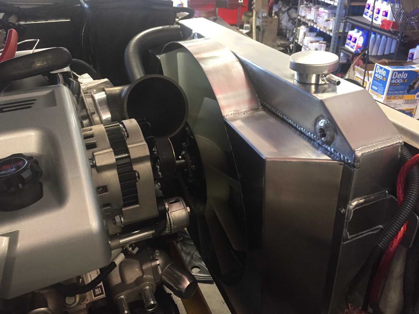

- Mechanical fan, 20" F150 fan blade, aluminum radiator

I curious about the radiator you used. Where did you get it ?

These are OPINIONS formed both by doing a number of LS based swaps into Land Cruisers along with extensive and continuing research regarding all manner of issues that swaps present.
Here's the thing on cooling. These motors are not known for having over heating issues in the vehicles they are used in, from the factory. Whether they are using mechanical fans or electric fans the vehicles cool just fine.
One item talked about a bit regarding cooling issues across all vehicles having LS based swaps is that more often than not the radiator in the target vehicle is smaller in surface area open to air flow. This is true with Land Cruisers. In order to overcome this we have to present alternate ways of providing sufficient cooling. This is not rocket science, but it is expensive. I currently use Ron Davis radiators in my swaps. I do this because they build quality radiators that still have the tank welded to the core, not epoxied. Smaller surface area but better air flow and more cooling fins etc.
Next and as important to cooling area is air flow. A proper shroud is required no matter what fan system used. This is an item often either overlooked or thrown together in a rush at the end of a swap. In most cases you have at leas a condenser for the AC in front of the radiator, I mount coolers for PS and trans in front of them as well, cooling works well.
Another item is a heater valve that keeps coolant running through the water pump when the heat is off. I have found that it lowers temp 10-15 degrees across the board.
Using a mechanical fan with a crate motor has pretty much become extinct. There is a special water pump with a hub that allows mounting of a fan but at over $1K by the time it gets here from AUS it is cost prohibitive. I much prefer a manual fan but it also becomes a parts issue as well when the water pump goes south.
Bottom line on all of this, plan a good cooling system into the budget for your swap. This is NOT the place to cut corners.
