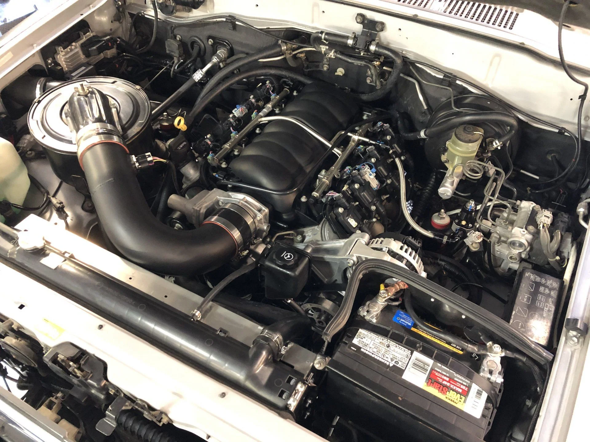

I have a mildly built 200 (lift, tires, sliders and front bumper), as well an 6.2L in my 80 series. My 80 has a 6L80, 37's and 4.88's. It can tow my loaded utility trailer very well, but the lift/tires and IFS vs SFA setups makes them a bit different in terms of towing capability. If I'm going to tow a notable load for hours on end out of necessity (not for fun), I'll always choose the 200 for comfort and ease purposes. My 80, even in its current form, does feel more powerful than the 200 so the "power" element isn't an issue here.
I love my 6L80 and wouldn't want a 4-speed, but dont have personal experience with it either, so take my comment with a grain of salt.
As for accessory drive, I'm running a Holley 20-143 and Hooker headers.

For accessory drive the very best setup in my opinion is the common GM truck setup. It puts everything in the perfect spot for a LHD Cruiser.
The only issue with this is for guys with fancy LS3 or other car engines need to swap balancers.
All parts are available new from GM though.
I have a 80 series motor mount kit to use the common 2808 style motor mounts that I just need to finalize some details on before bringing to market. Prototype set is installed on @masong 80 swap.
