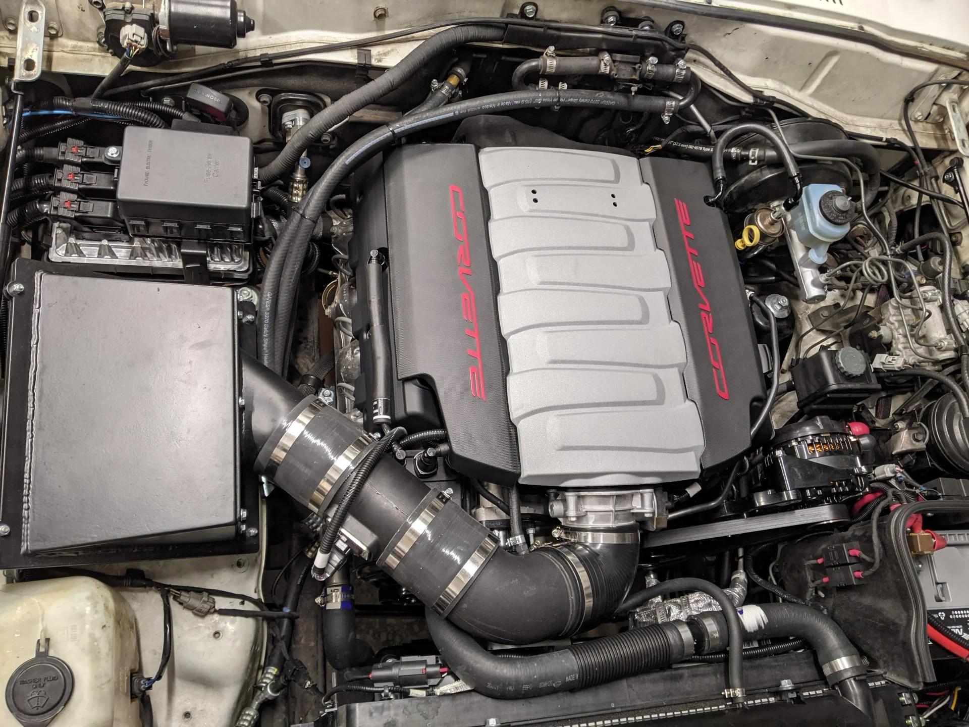

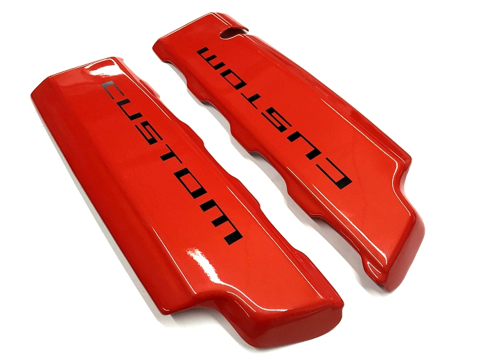

Anyone looking for the parts to fit fuel rail covers to a LT1 conversion, you'll need the following:
GM Parts:
12705388 - Valve Cover Insulator (L)
12705391 - Valve Cover Insulator (R)
11609688 - Insulating cover stud (x4)
12641720 & 12643709 - Fuel rail appearance covers (Corvette logo)
There's a bunch of different rail covers available, both OE and through companies like RPI - Link below for custom:

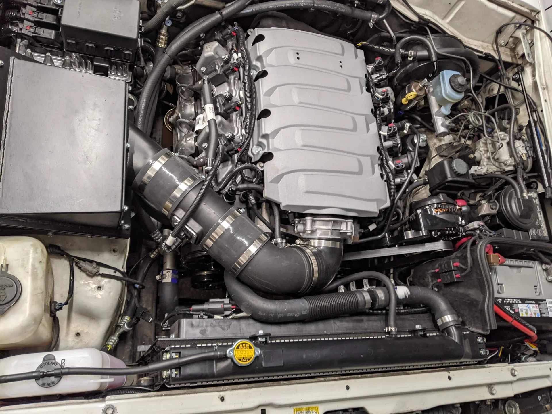

Before:
After:
Tell me more about this airbox. Like it a LOT! I'm currently running a cone style K&N, which is open to under hood. Looking for a solution like this.
It's the @torfab air box which draws cold air from the stock location through a Duramax cone filter. I'm sure Tor and his team can get you hooked up.
Just called them. No stock for 3-6mths. I’ll hopefully need a solution well before then. Also confirmed their adapter is for in-house builds only at this time.
