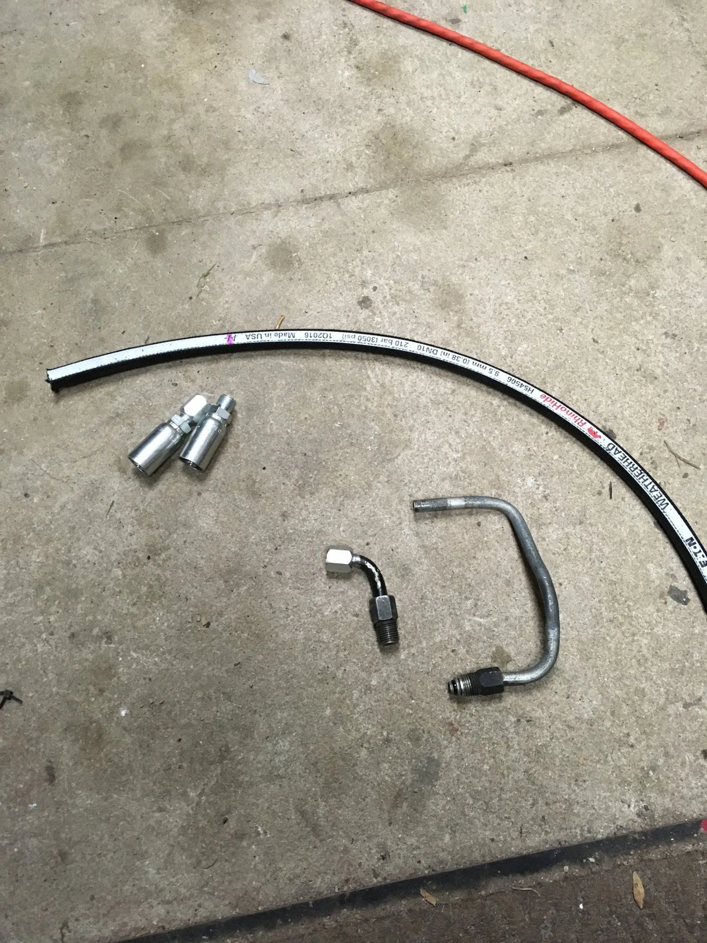

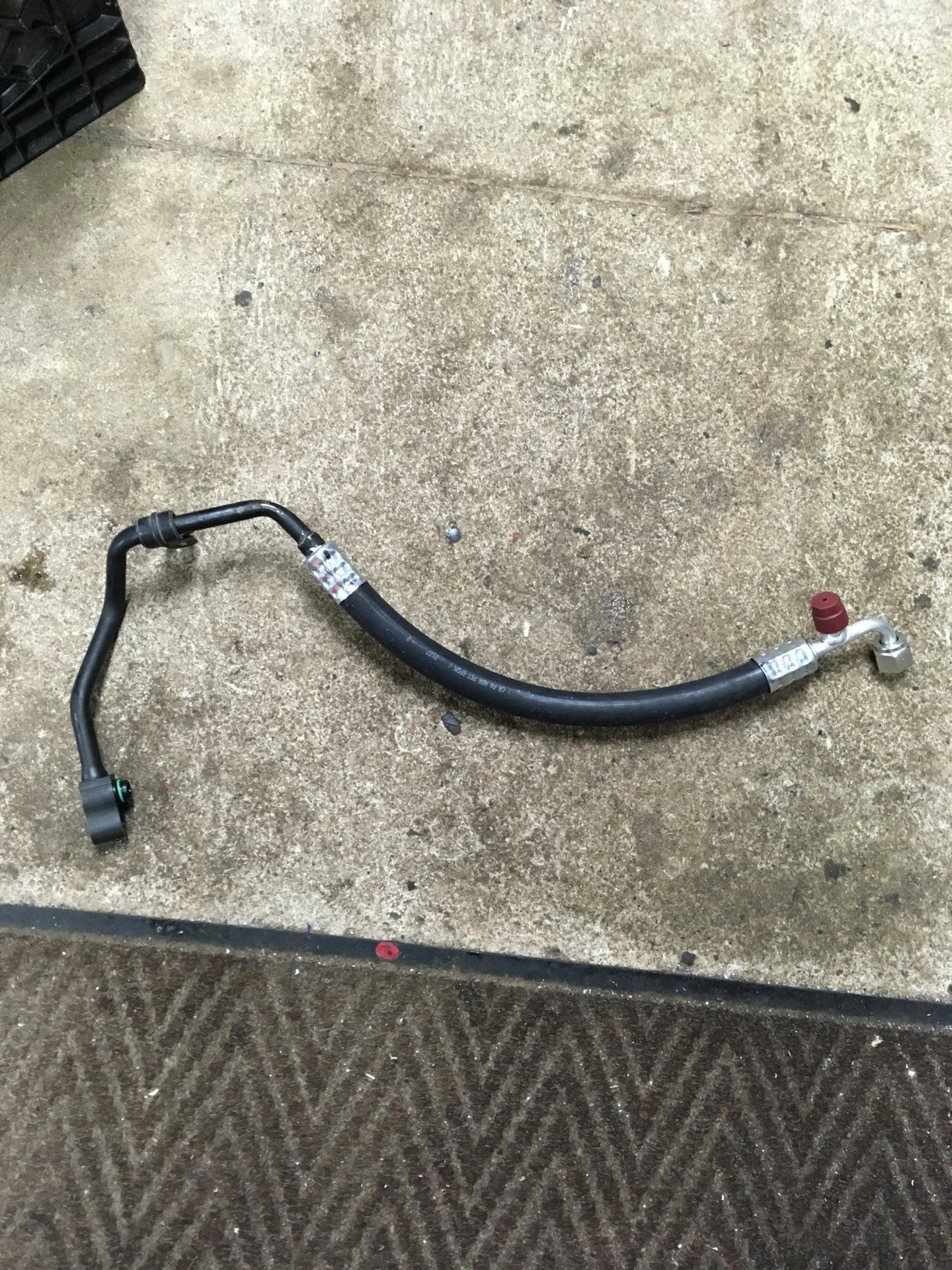

i made my own a/c line one to firewall goes directly to a/c compressor and front one i reused toyota metal line
and power steering i reused one toyota line and made on with one side toyota and other from GM
for transmission i used oil pan from older one and no problems with driveshaft clearance same with engine oil pan i used pan from camaro

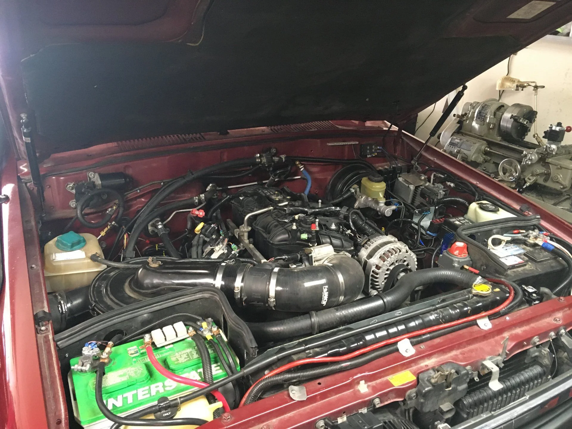

Hello! Can you anwer a few questions regarding your Swap? I’m getting close to finished a 6.0 LS Swap with 4L80e in my 94 land cruiser.
I used a Express Van power steering pump with remote res. I had to modify the factory bracket bc the power steering pulley is to large. What size pulley did you use? Is it ok for the power steering pump to use a smaller pulley and spin faster than normal?
I was also wondering how you connected your intake to the factory air box? Can you advise on which hoses you purchased to connect the intake to the MAF and the. The MAF to the factory air box?
I would really appreciate the info!!

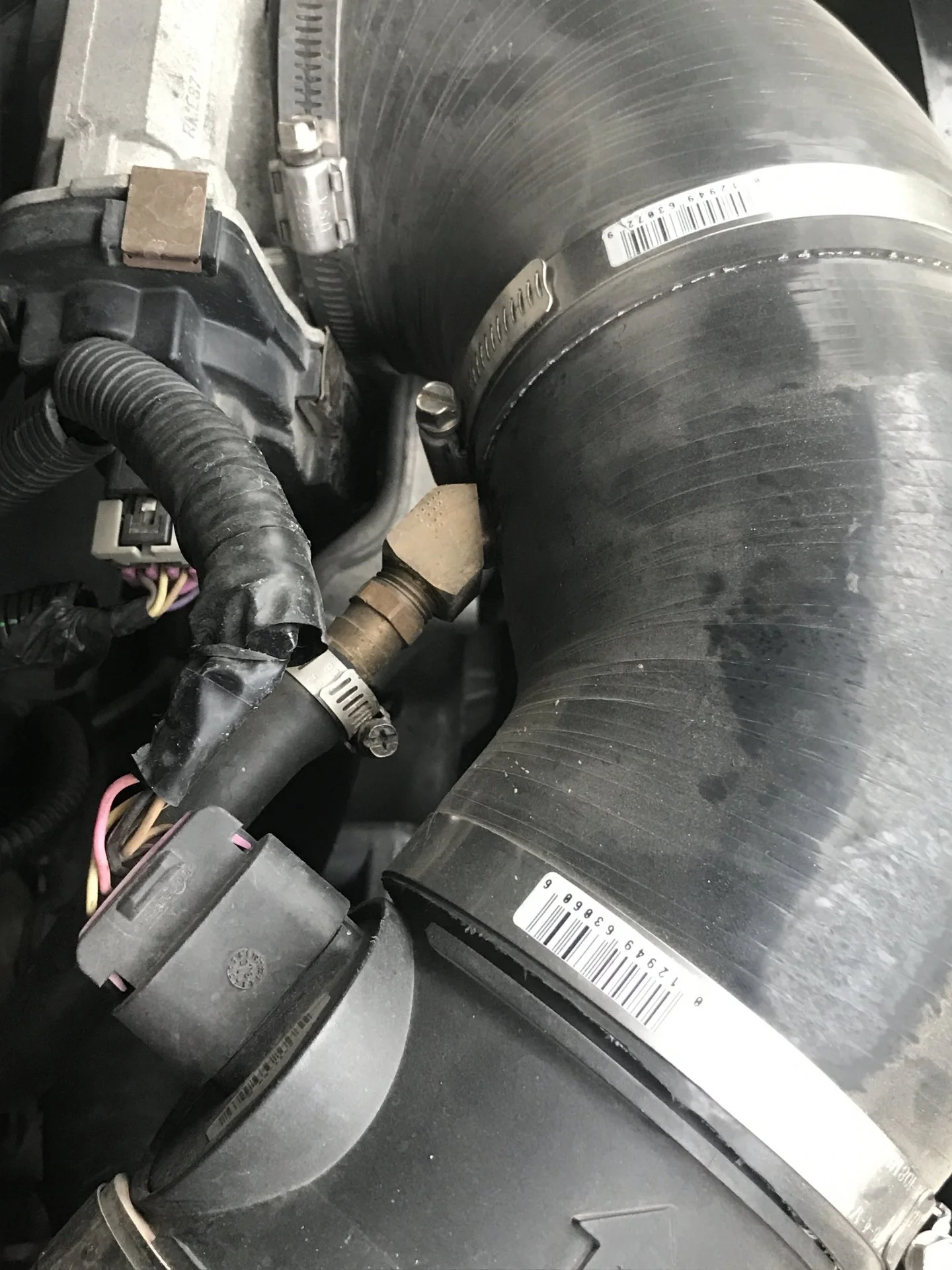

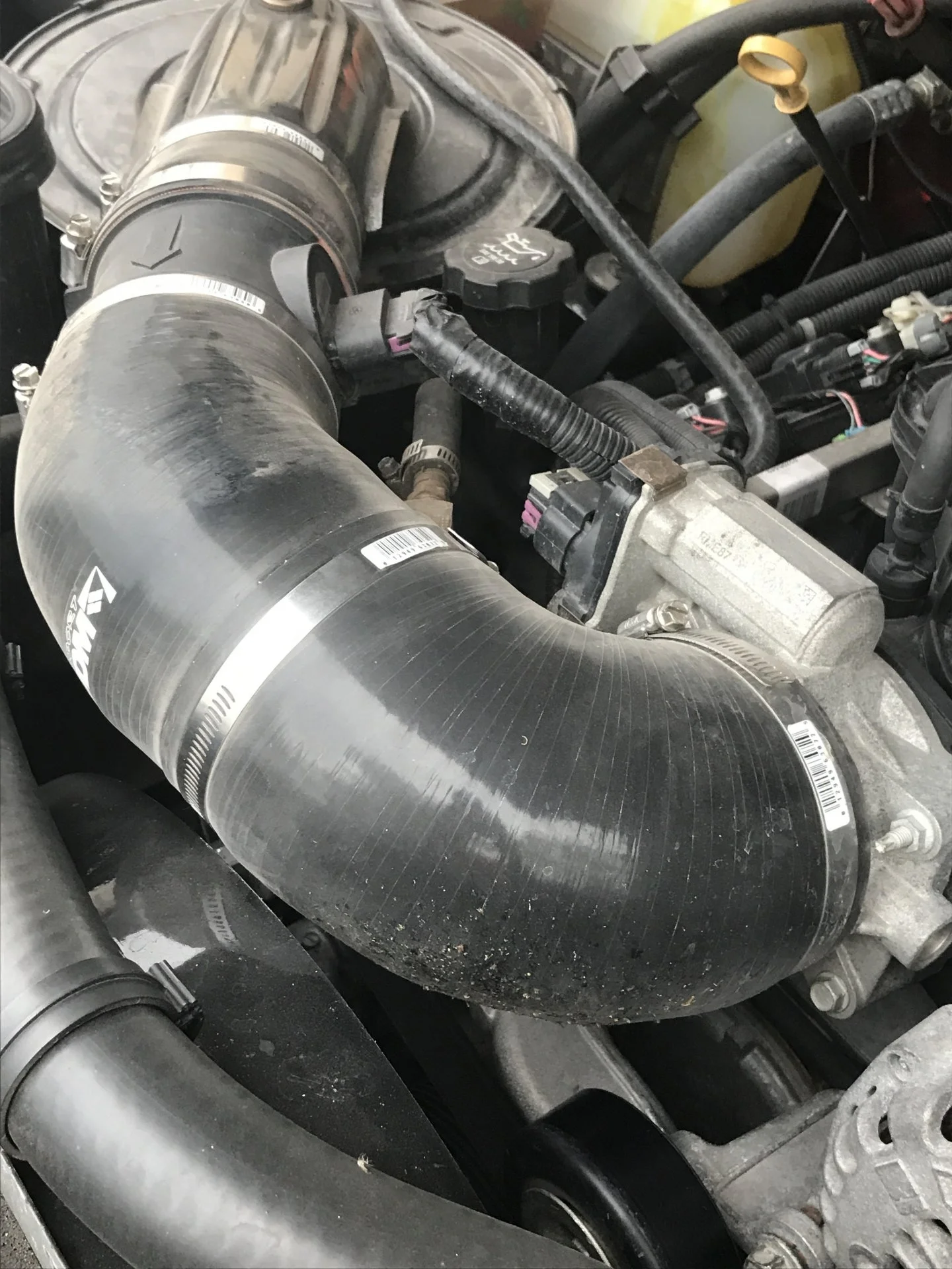

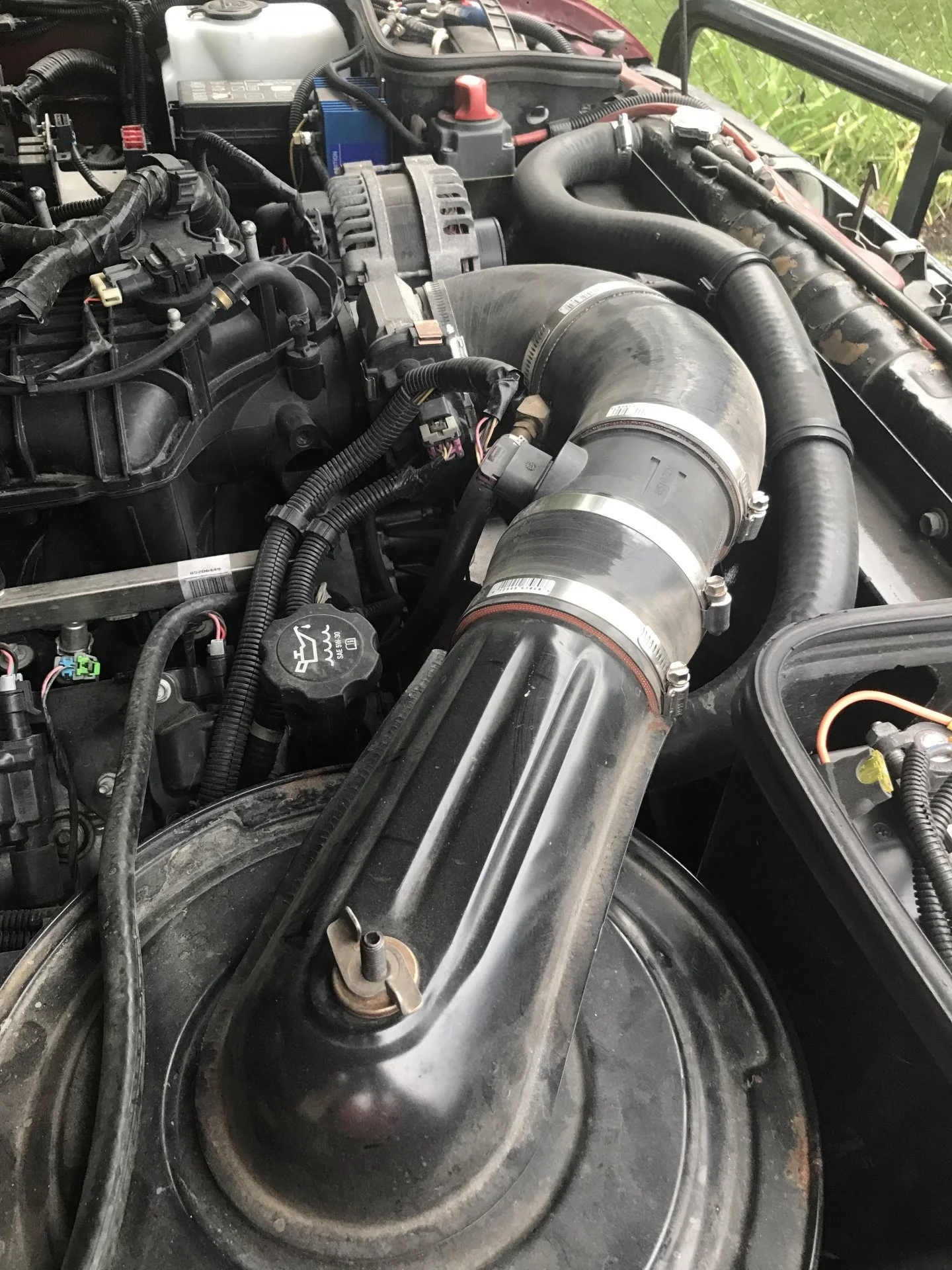

i used engine from 2007 silverado and did not change anything on it just made two new hose one end to fit toyota steering box and other end to fit gm pump
and also i m using power steering oil cooler from ford F150
for intake pipe i do not remember what size is it but i believe it is 4" one elbow 90 degree and one 45 degree ,between 45 degree and 90 degree i just used aluminum adapter 4" to 4" and that is where i drilled hole for crank case ventilation and from MAF sensor to air box i believe it was 4" to 3 3/4 but i m not Shure you will need to measure it and on air box i cut metal flange of it co i can have round pipe to connect everything together

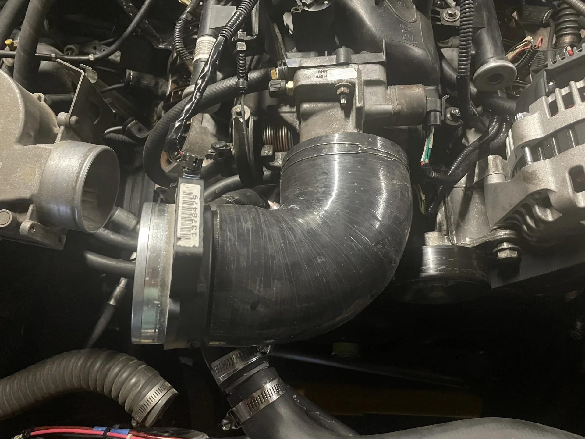

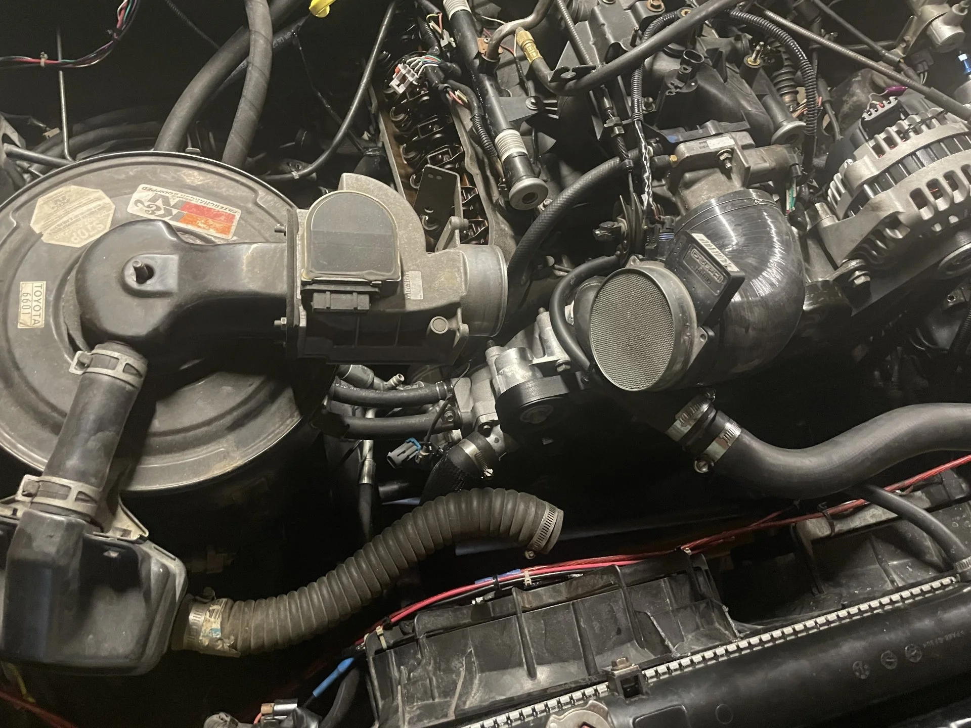

Those of you not running the factory air filter box, what did you do for intakes?
I think I'm vapor locking / heat soaking my LM7 because of intake temps. Last night it got over 130 degrees and it stalled out on me.
My intake set up is a silicone 90 into a 4" aluminum tube to the MAF and than a cone filter all under the hood on the passenger side. The intake tube dose rest ever so slightly on the upper radiator hose.
I'm no fabricator so I can't really use the stock air cleaner box because I'm also 3 linked and the coilover tower is where the stock air box would bolt to the fender.
I'm starting to stress because I have a Rubicon trip coming up in July and really don't want to have to cancel.
It ran like a top when I finished the swap and on it's shake down run.
Then all the sudden in Moab near the end of the day it would fall on its face....
Any and all suggestions welcome! Please and Thank you!

Are you getting the heat from the exhaust manifold? Did you heat shield that guy?

@torfab makes a nice airbox. I think they're out of stock ATM though.
There's several pics up on their site.

Vapor lock isn’t really an issue with EFI especially not with a in-tank pump
130 degree intake temps shouldn’t be an issue at all. You’ve got something else going on
