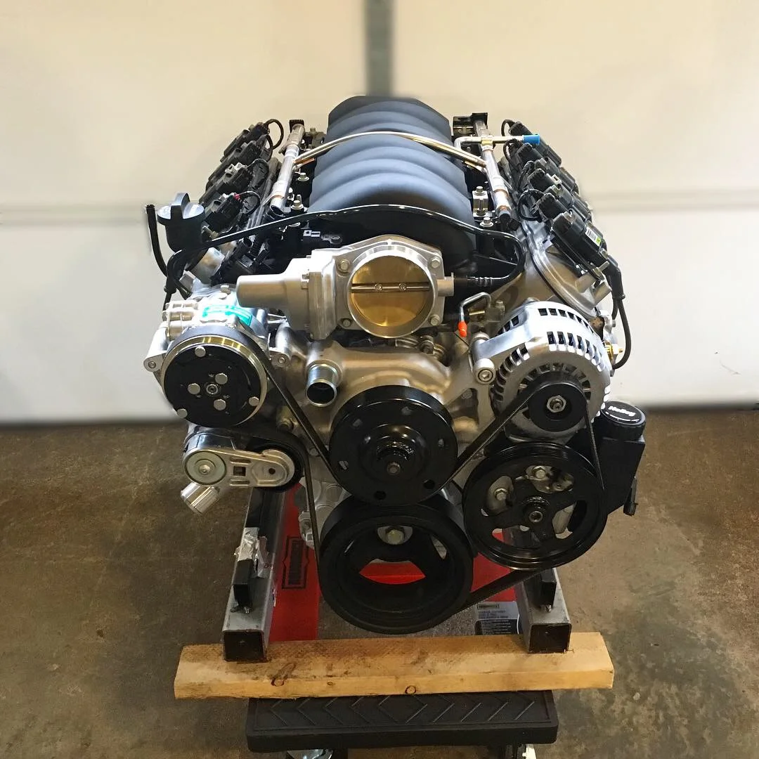

For the sake of me reading through all 127 pages. Read a bunch so far but wasn't looking for the answer to this question then. What belt setup is everyone running? 6.0 LQ9 is almost fully built and we are almost ready for test fitting.
Stock truck accessory and water pump set up. Tell us about that engine! You could have hood clearance problems with that intake.

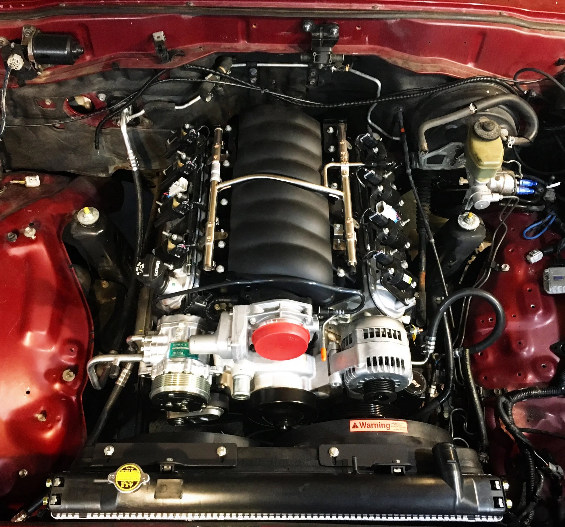

@cruisermatt recommends the truck accessories. I currently have LS1 camaro accessories and a Holley compressor relocation kit that I plan to try to use first since I own them. However, in your shoes, I would go truck accessories and see if you can talk @cruisermatt into making you a set of his motor mounts.

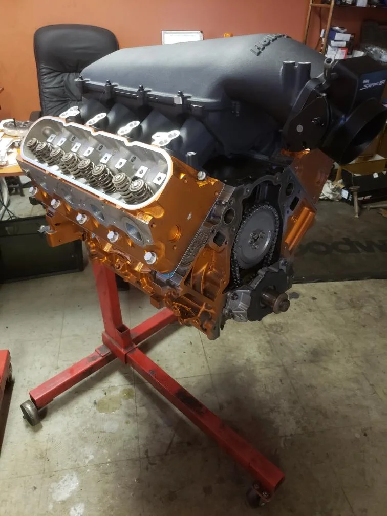

Lq9 with a stage 1 torque cam BTR. Hot tanked and honed, brand new bearings all around. New just about everything: rings, valves, springs, seals, rods etc and a trunnion kit just in case. Vht gold paint, bit more orange than I was looking for. Attempted to match my bronze wheels.
Shop slapped the intake for pics. What's the chance of fitting the trailblazer SS intake? That is the current plan but was going to wait for the test fit for the intake and the Accessory mounts.

There are clearance issues if you try to use an LS front drive assembly vs a Vortec and the reverse. The Vortec belt runs a bit farther out away from the block, I believe in order to clear the throttle body but not positive that is the reason.
Truck intakes are probably the most common. Plenty of room if you’re careful.
Truck intake just fits under the hood. You can get more clearance by deleting the AC compressor or notch the frame for it like another guy on here did.
A taller intake is supposed to be a gain of about 10hp but that's at 6000 rpm. Rear world driving is going to be minimal gain for way too much money.
