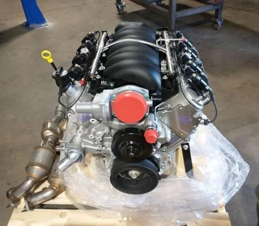

Step one is done. Parts are tricking in for LS3 erod connect and cruise 6.2L crate motor paired with 6L80E.
