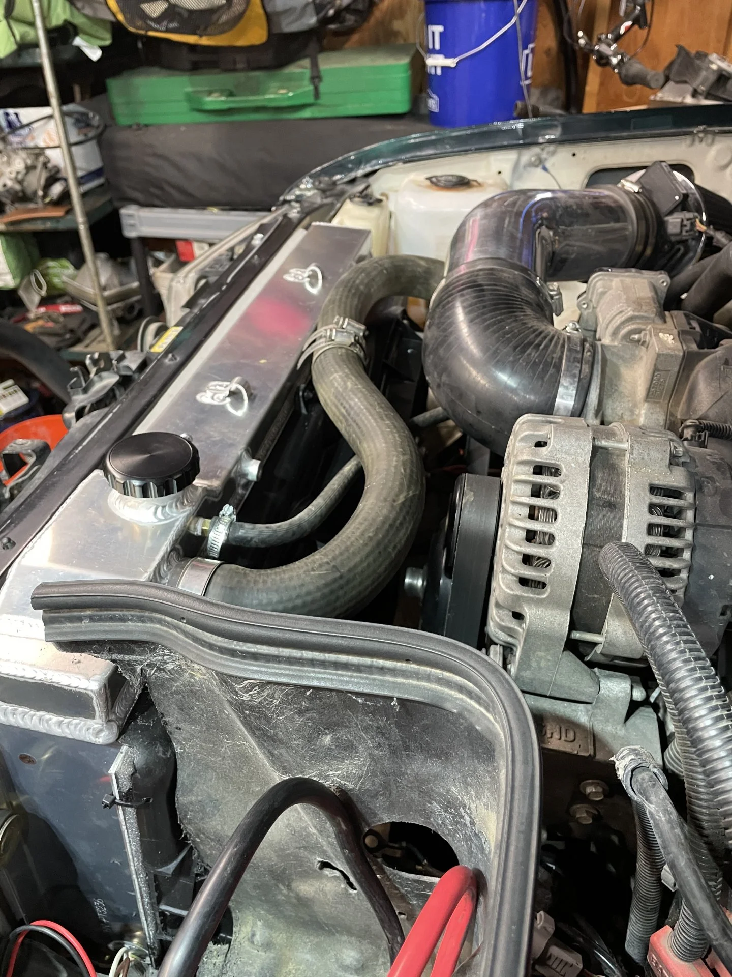

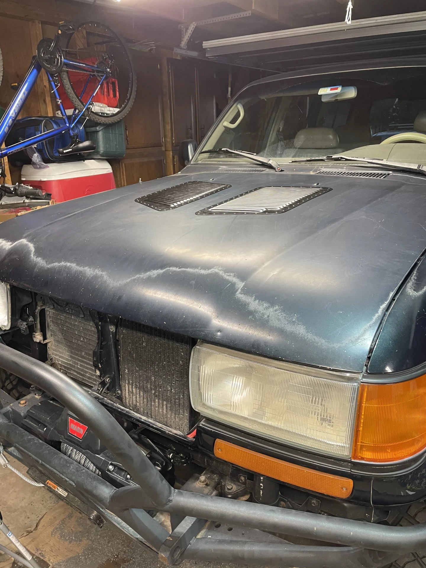

Been on a quest to get this LM7 running cooler. Added a 4core aluminum radiator, run cool hood louvers, and a dual speed Lincoln Continental electric fan (still need to wire). Hopefully this keeps it closer to 200 instead of 215 plus..

is that radiator of ebay ? how is the quality of it ?
Yes it’s eBay. Seems legit. I know a few guys local to me running the same radiator. They have no complaints.
