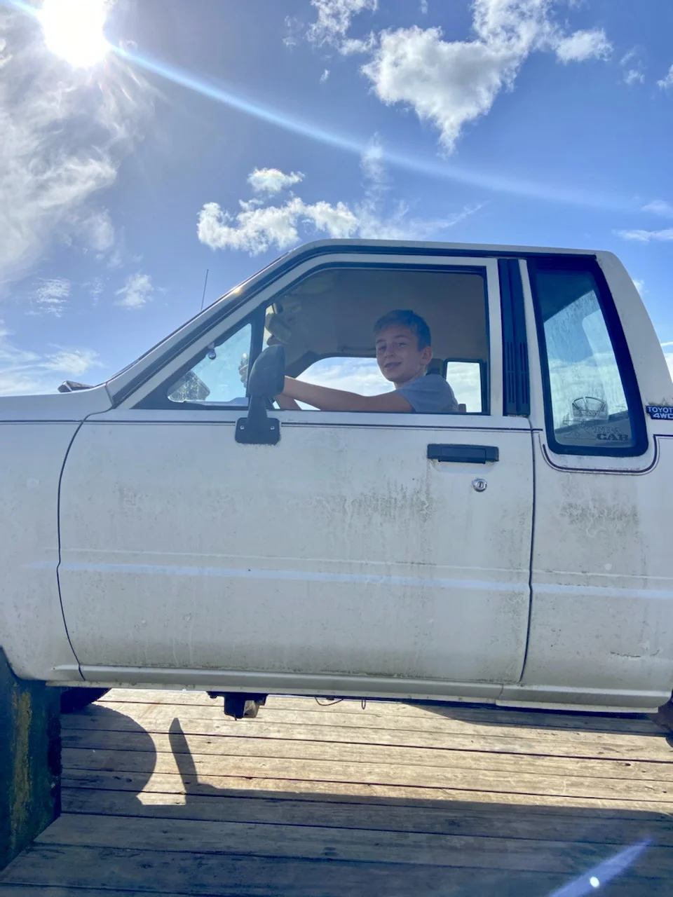

Pic from this weekend. The boy in the truck, offloading from the trailer.
